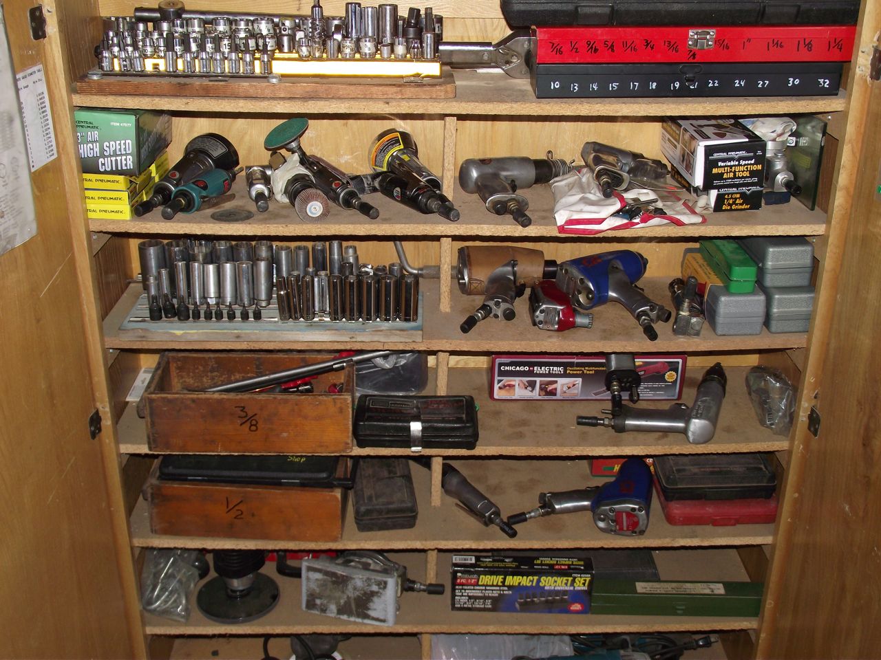

No, By having a lot of room in drawers, I try to keep everything one layer deep. The reason I posted these photos was to show what can be done with old garage sale finds if they are re-purposed. I would rather make something than buy it. Here is an old wooden cabinet from a school cafeteria kitchen. I added some shelves, but not permanently. It's not too neat, but very useful for the bigger air tools.

impressive storage units, and basically, YOU made them. If all of us had enough decent storage room , ,we wouldn't dump things on top of each other.
You've avoided that, and my compliments, nice work!
I like recycling also, and to look at a nice older oak cabinet that actually works must be very satisfying. More money to spend on tools.

graydog--very impressive, especially the door on your wooden shelving. I'm going to be on the lookout for a map cabinet like yours. I've seen them in the past but never connected --duh---the possibilities.

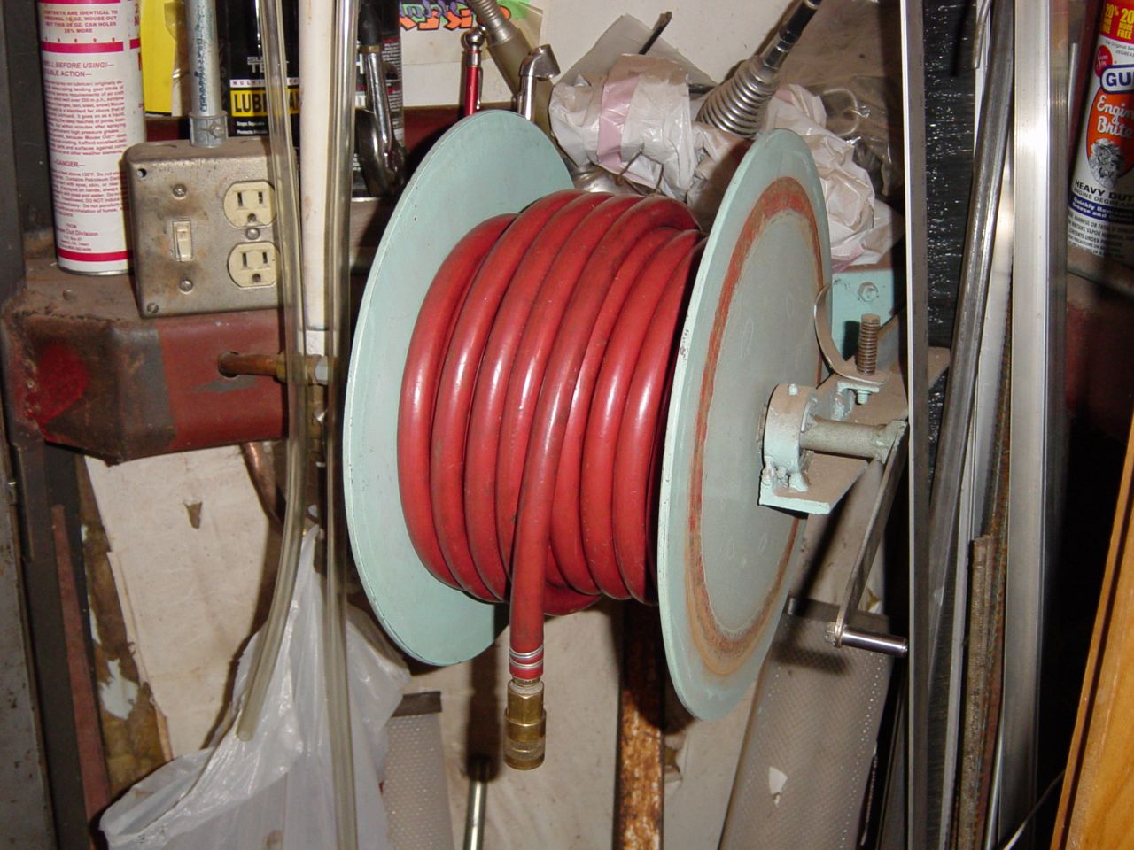

I did not mean to hijack this thread, but I cannot find a way to start a new thread: "Homemade tools". I am 76 and have made many useful tools and I know that a lot of other members have also. (If a moderator could open this in new thread "Homemade tools", I would appreciate it.)
I made 3 of these hose reels. They are nice, but require way too much labor.

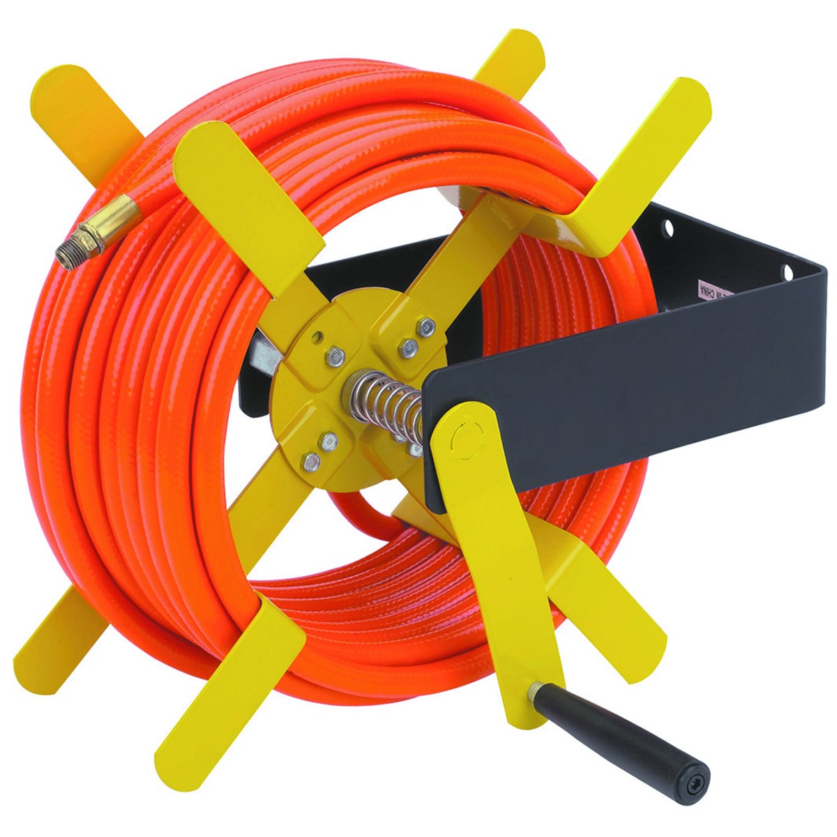

Here was my solution:
Harbor Freight sells these hose rells for about $12 on sale.

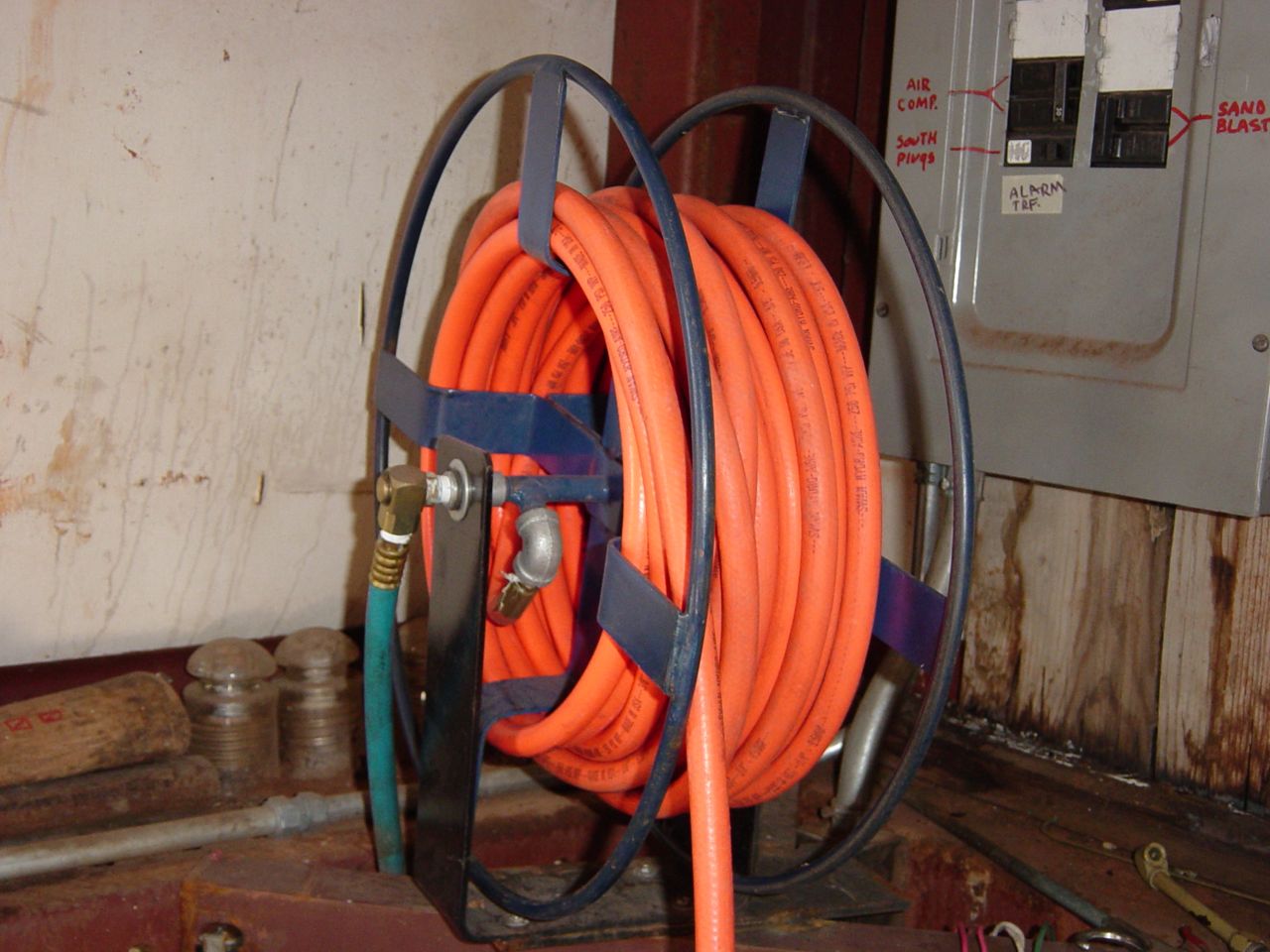

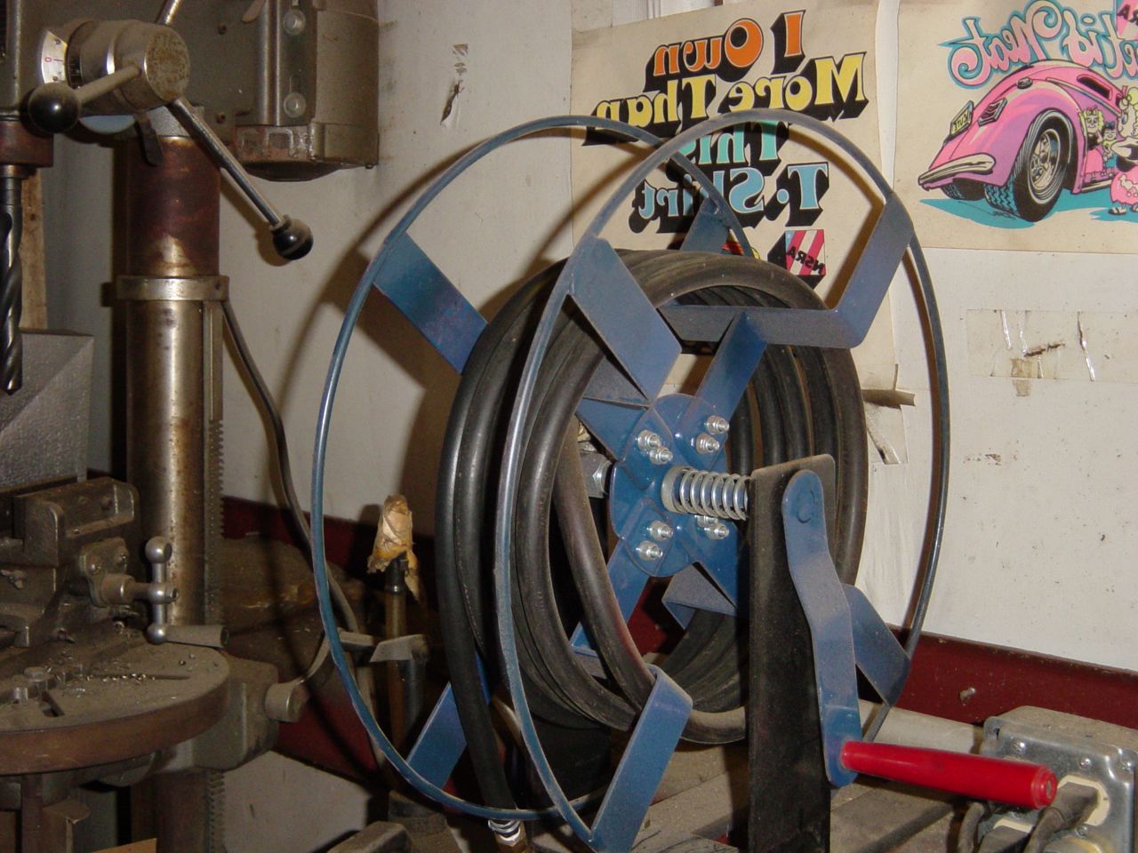

They are no good as-is, but when you add 2 hoops of 3/8" rod, they are great. I wrapped the rod around a 16" wheel rim to get them to correct size and then MIG welded them on.

sure you weren't an engineer for CoxReel? I like the anti static strap.
