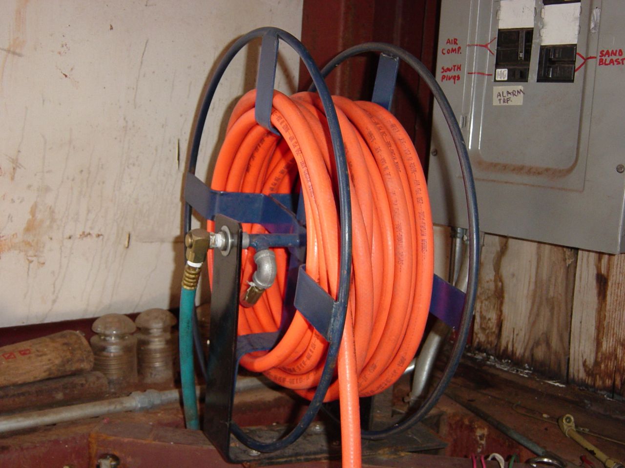

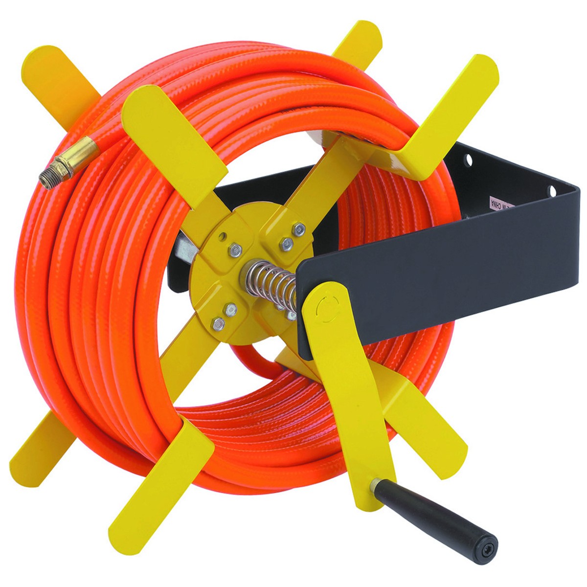

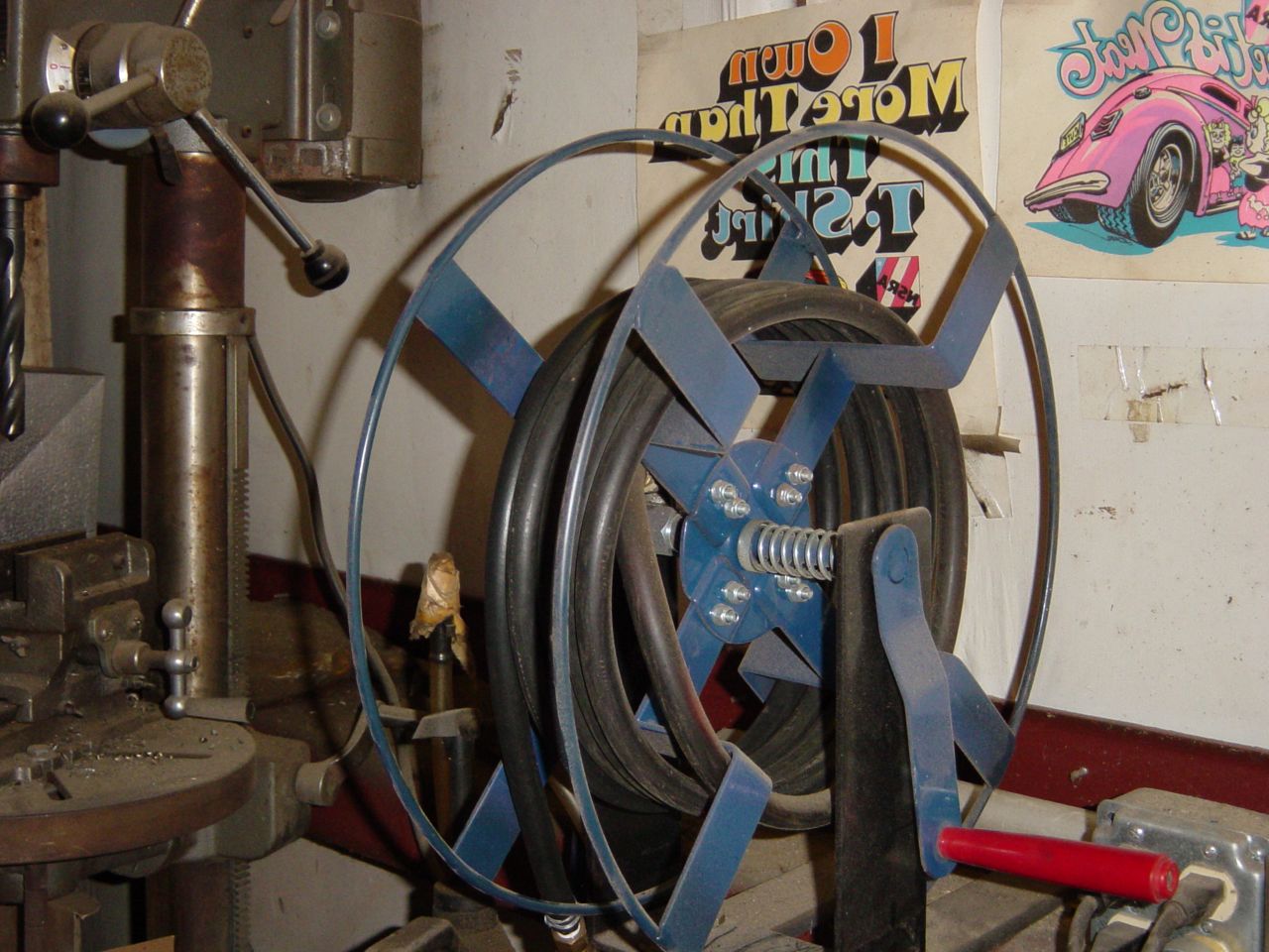

Here was my solution:
Harbor Freight sells these hose rells for about $12 on sale.
They are no good as-is, but when you add 2 hoops of 3/8" rod, they are great. I wrapped the rod around a 16" wheel rim to get them to correct size and then MIG welded them on.

I have one of those, but the spinner for the hose (ie: the part that lets the hose spin while under pressure) leaks like a sieve. Have you run into that?
Thanks
Aaron Z
   / Harbor Freight Tools that don't suck #3,222
Thanks
Aaron Z
Mine used to leak years ago. I believe I just had to replace an o-ring, but I honestly can't recall now. You can pick up an o-ring at Ace Hardware.

   / Harbor Freight Tools that don't suck #3,225
Graydog,
How well do the swivels connecting the HF hose reel to the air supply," seal? Do they leak?

   / Harbor Freight Tools that don't suck #3,229
Graydog,
No, the HF reels have never leaked and are several years old. The light blue one I made from scratch leaks, but it has a quick connect instead of a swivel. (It's quiet a bit cheaper.) It's no problem though, since I have a ball valve I turn off and on.

The strap on the light blue one is a brake to keep it from unwinding. It works good.
