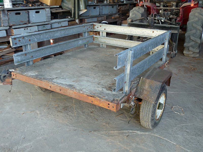

Thank you so much for the offer!
I actually had broken down and bought the stake sides two days ago, before I saw your post, and I really appreciate the offer! I ended up using a 20% off coupon, so they weren't too bad. Did they seem to be about the same quality as the rest of the trailer? Thanks again, and I hope that you guys are having a great spring
I have the metal stake/sides kit (3 sides, tailgate missing) that came with this trailer. I'll sell it cheap, but I doubt cross country shipping is worth your trouble. I'll post a photo if anyone cares.

... stake sides ... seem to be about the same quality as the rest of the trailer?
Let's say the sides look to be sufficient quality to use on an ultralight trailer.
I wanted higher higher, dust-resistant sides for that other 'jeep trailer' in a prior post so I ripped a sheet of 1/4" plywood to something like 22" / 26". This made sides that rested on the deck, and a front panel that bolted to the front face of the chassis for rigidity. Four aluminum channels bolted outside the chassis held the front/back edges of the side panels. That little trailer is so light that I can lift the back and move it sideways carrying the usual lightweight folding chairs, sleeping bags, etc on a camping trip. (And this is sometimes necessary because these ultra-short-wheelbase trailers are hard to back up, and hard to see looking back from an SUV because they are so narrow).

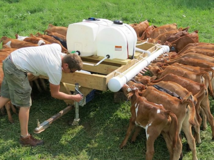

Another use for trailer:
