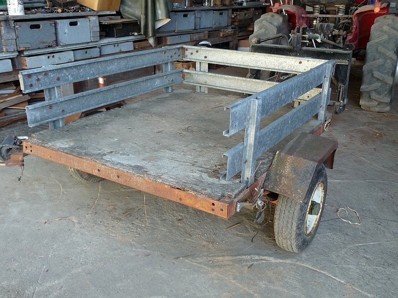

Thats good to know about the quality! It looks like they are galvanized? I found a jeep forum that has an 11 page thread with many different photos of the same trailer all towed by jeeps! Yours looks great! How does it tow?

Let's say the sides look to be sufficient quality to use on an ultralight trailer.
I wanted higher higher, dust-resistant sides for that other 'jeep trailer' in a prior post so I ripped a sheet of 1/4" plywood to something like 22" / 26". This made sides that rested on the deck, and a front panel that bolted to the front face of the chassis for rigidity. Four aluminum channels bolted outside the chassis held the front/back edges of the side panels. That little trailer is so light that I can lift the back and move it sideways carrying the usual lightweight folding chairs, sleeping bags, etc on a camping trip. (And this is sometimes necessary because these ultra-short-wheelbase trailers are hard to back up, and hard to see looking back from an SUV because they are so narrow).

Yes, galvanized.
The little 40x48 trailer was unnoticeable behind that Trooper (1998 photo) or the Subaru Outback that later replaced it.
The secret to smooth highway towing was to look at a tire pressure chart and run 26-28 psi, which is more than enough for my camping gear. From memory I think 28 psi gave me 500 lbs cargo capacity. Minor sidewall flex prevents bounce, same as a car. For the farm trailer carrying the IBC tote I'm running the 60 psi labelled on the sidewalls despite that the wheels are stamped '1984' and the sidewalls have weather cracks. I thought the old tires would burst under such overload but so far, no problem. I have the clean trailer's tires and spare available as replacements if needed.
The only issue towing the 40x48 trailer is its so narrow you can't back it looking in your side mirrors - it is badly out of line before it comes into view in the mirror. And for an SUV it's too low to see in the rearview mirror. That's why I have that red broomhandle sticking up in the offroad photo, so I can see where my trailer is.
You might think 8 inch tires are too small for offroad use but they are so close together that they go over the same obstacle at the same time. And dragging the axle in dirt wouldn't hurt anything with such a light load. Worst case, walk back and simply lift the trailer over the projecting stump etc while your wife drives the tow vehicle. I never had to do that but a couple of times I steered to drive one of the trailer's wheels over the highest point. I don't think there is a need to upgrade to taller tires.
