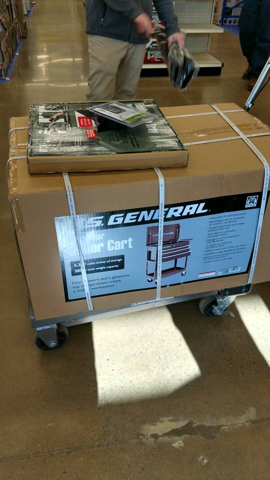

The 4 drawer Series 2 'tech' cart is going on sale for $100 this week-end at the parking lot sale. $50 off.. 3 in. 4 Drawer Tech Cart
Thank you bud! Got it, the side shelf and the free 25' tape. The 20% off works in the side shelf IMG_20180420_172901078_HDR.jpeg

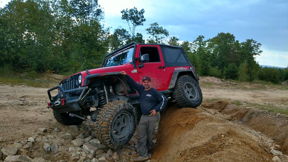

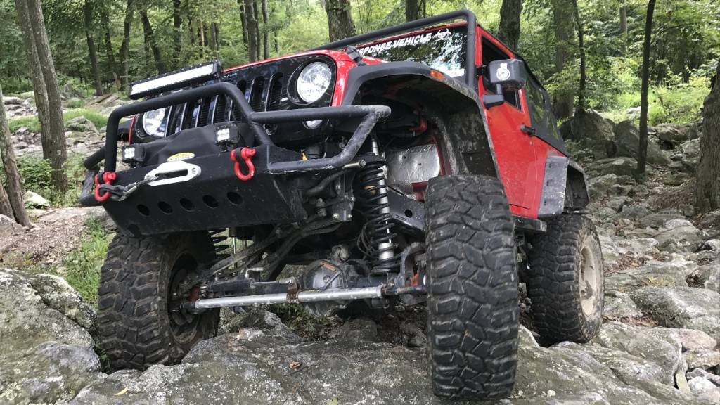

Hi Lift Jacks...
I'm a Jeeper, a rock crawler. I carry a high end "Hi Lift" brand jack on my roll cage... I've used it, and I don't like it.... But I carry it because there are times when it's flat out the only tool for the job.
Any day that your pulling out a Hi Lift is a really bad day. Off-road folks use it as a last resort tool only. They kill people, they hurt people, they damage vehicles and equipment. But, I would not go into the rocks without it, because when things go totally sideways on you.... You may need it. Bad.
Always fear the thing. It's waiting to to damage at every move it motion. It will bite you, and it will do it suddenly and with little or no warning.
Rock Crawler, out.Screenshot_20180421-032828.jpegIMG_20170908_182521383_HDR.jpeg
Bought one of these with a $99 coupon for work a few years ago. The wheels would get squeaky and hard to push but we put a lot of miles on it. Great tool cart for the money.
Thank you bud! Got it, the side shelf and the free 25' tape. The 20% off works in the side shelf View attachment 549873
Was looking for the 20% coupon. Had to click on the black April 20-22 tab.
