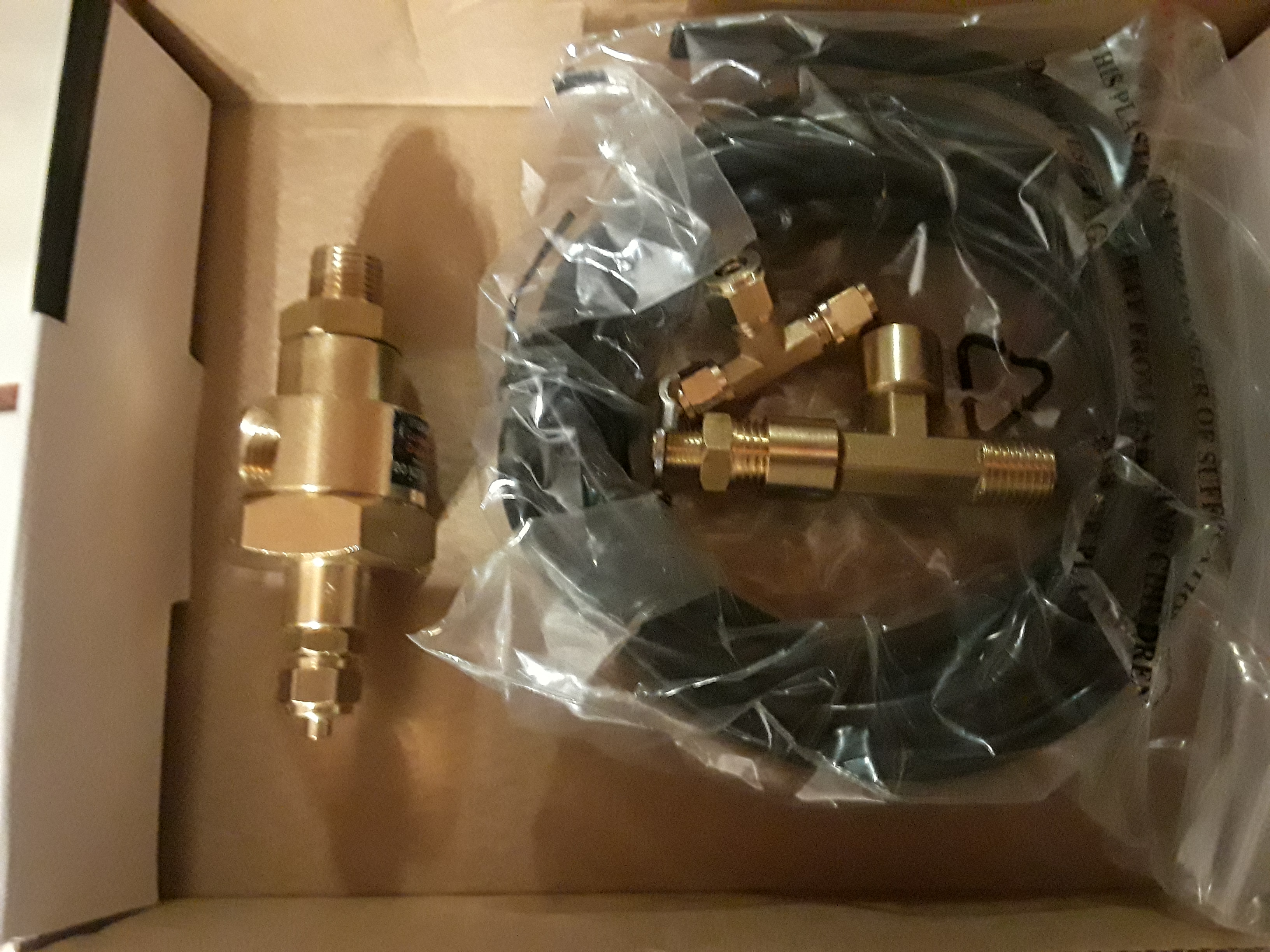

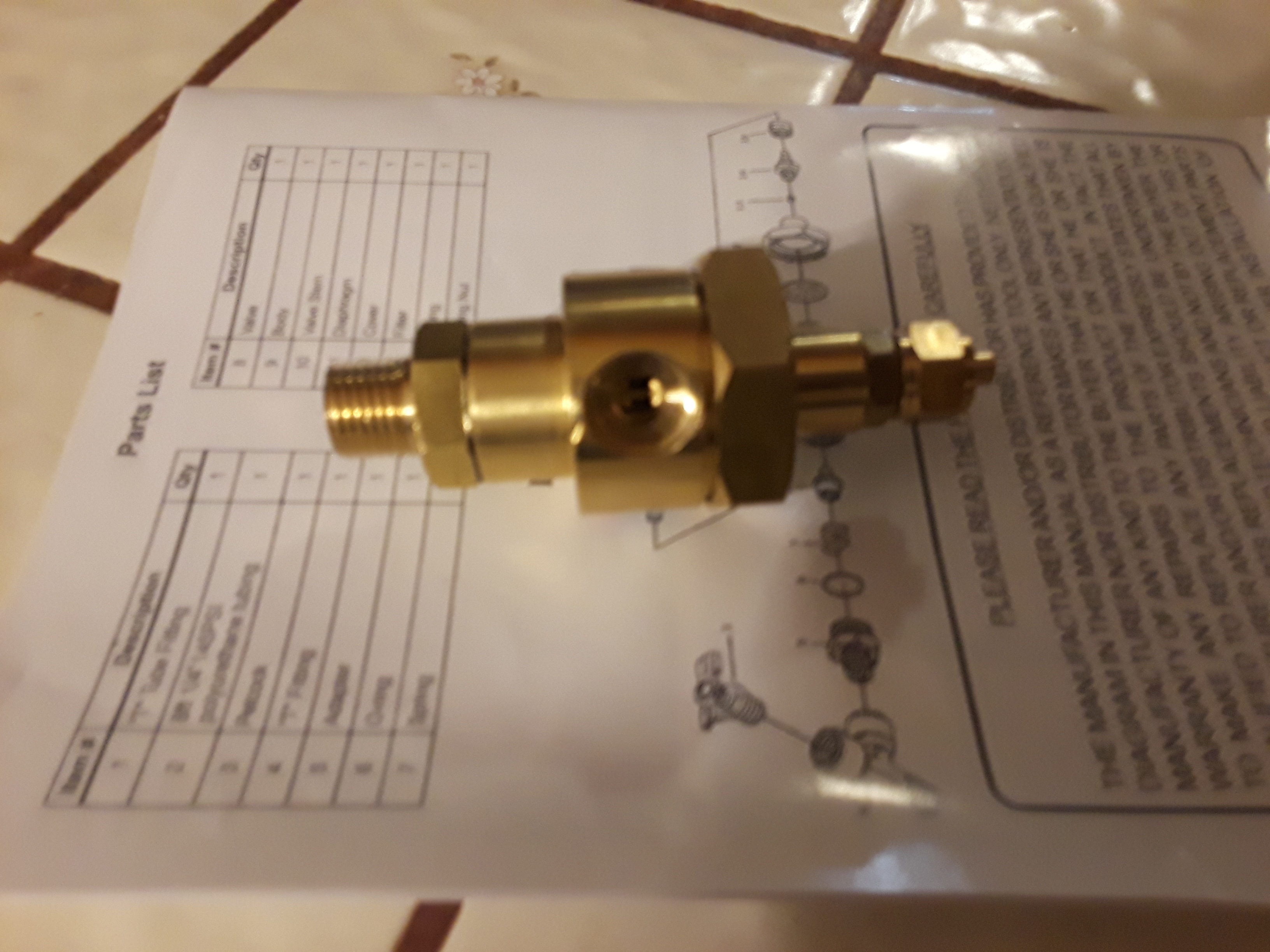

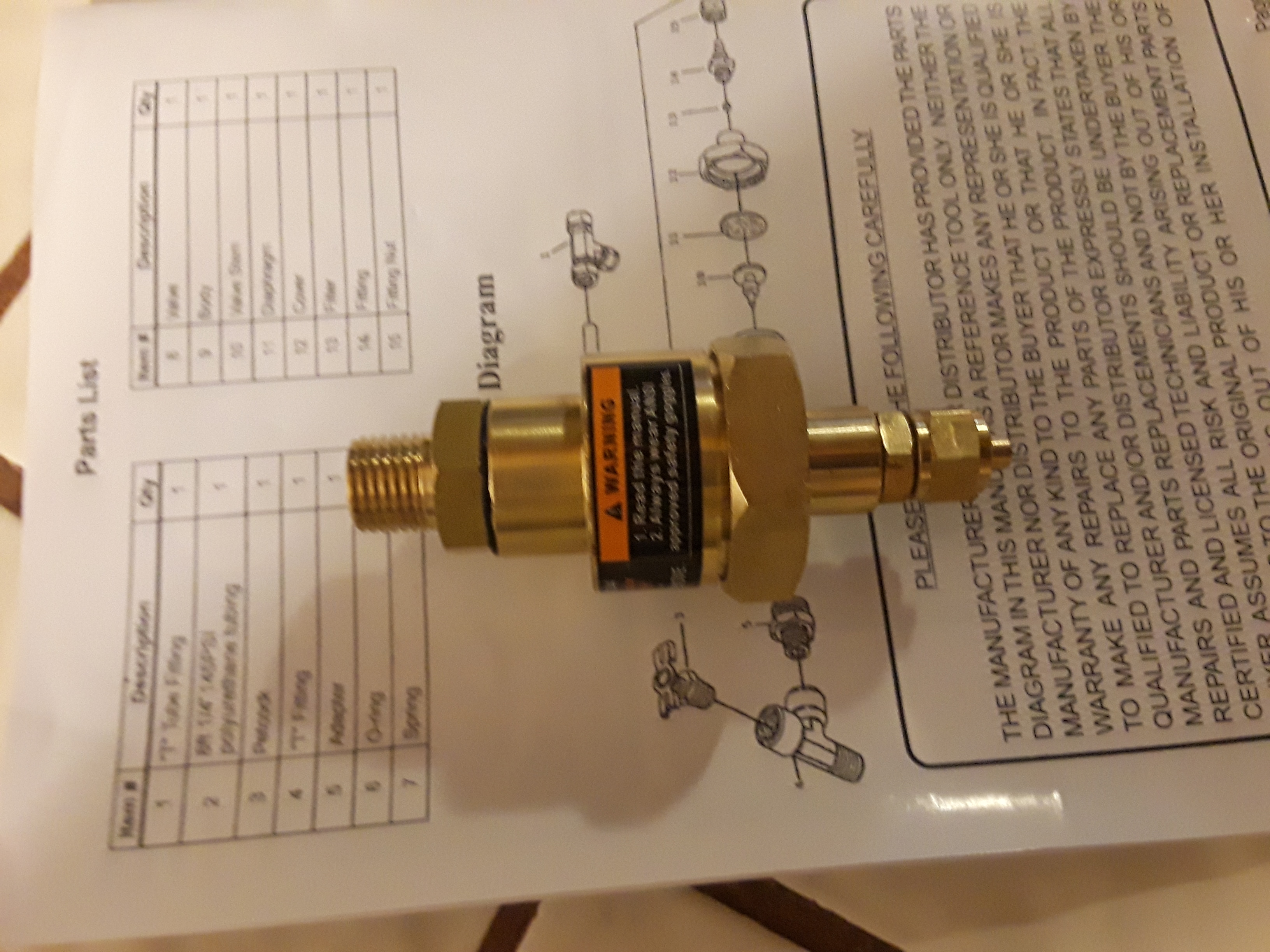

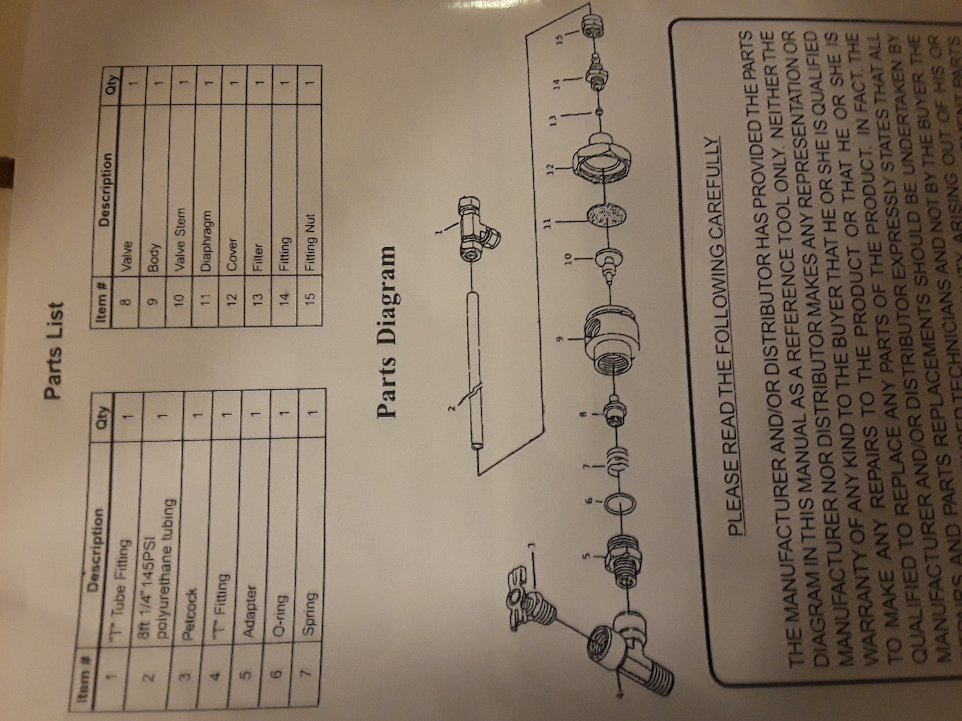

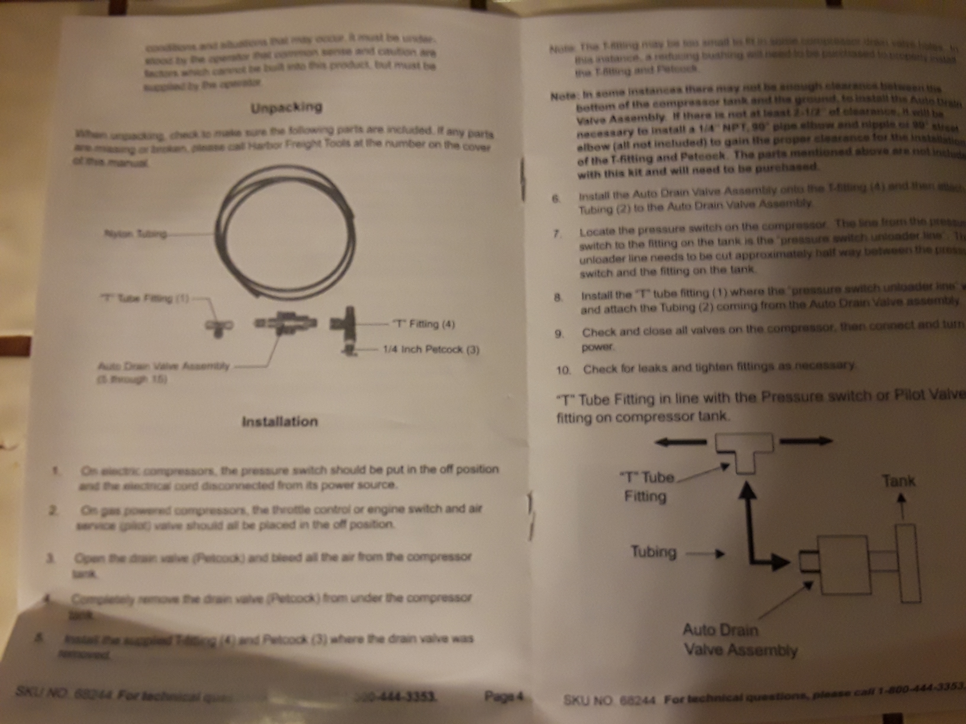

HF Compressor Auto-Drain Questions
Hi, is anyone using [one of] these?
https://www.harborfreight.com/automatic-compressor-drain-kit-68244.html
I have a question about the installation process.
20180616_193624.jpg20180616_193643.jpg20180616_193655.jpg20180616_193717.jpg20180616_193732.jpg20180616_193750.jpg20180616_193803.jpg20180616_193813.jpg
There is a threaded port in the side of the the brass main valve, and despite close attention to the [as usual] poorly explained directions, I cannot figure out what, if anything, gets attached there....
And as cheap as they are, I can't believe they threaded it if nothing was meant to attach there...
I know that the ends get attached to the new drain at the compressor, and the drainage tubing, but all of the drawings apparently show that fitting from the other [opposite] view.
My thanks in advance, if anyone has any helpful suggestions.

Re: HF Compressor Auto-Drain Questions
I think the threaded hole in the side of the valve is where the condensed air blows out when the valve opens. You may thread in a drain line if you wish. The poly tubing and tee run up to, and splice into the blow down tube, making it blow automatically.

I bought one, got seriously disappointed and threw it out. Decided to make my own and am far happier. At the end of the day I turn a valve on the end to vent water into an old paper cup and it's that easy. I think I got the simple instructions off the net or YouTube or possibly TBN. My home made one has been on 10 years no with no issues.

I think that port would be plumbed to the compressor line before the check valve at the tank. -- Most compressor systems automatically vent this line after pumpup. It would be convenient to connect directly into that vent circuit since it is already designed to tolerate the heat of the compressor line.
I believe the port senses the pressure cycle from zero to high and back to zero and automatically triggers a brief condensate bleed after each compressor run.​

What I did on my compressor was to install a street elbow and added a length of 1/8" th pipe to take the drain to easy reach. I then uses a simple ball valve as my new drain.
If I really wanted to I could make an extension for the ball valve lever that would save me from bending over to drain.
