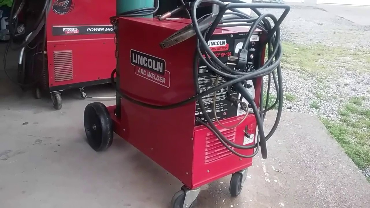

Back in 1990 I bought used Lincoln Idealarc SP-150, just like the one in this photo from the web.
It has served me well on all kinds on projects.
Very good welder for steel from 1 mm to 10 mm thickness.
It also came with aluminum welding setup which I have yet to use.

Back then I bought a 1989 SP-200 very similar. These were the smoothest transformer machines I have ever ran. Including dozens of other brands from the era and up to now.
