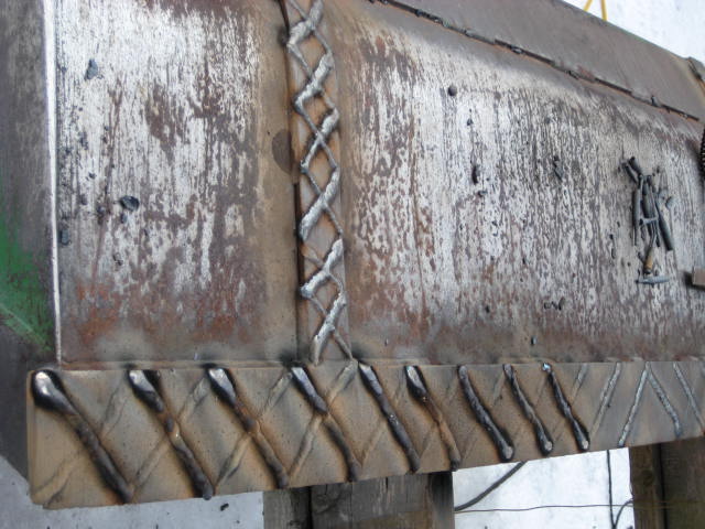

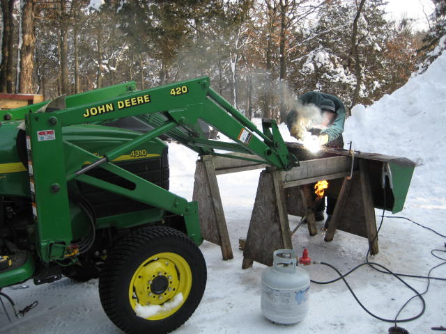

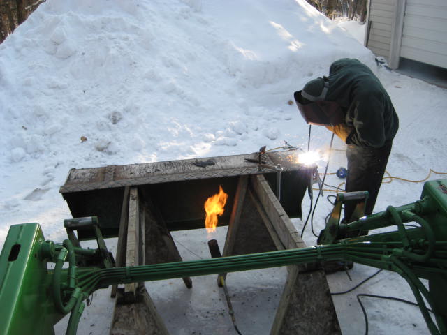

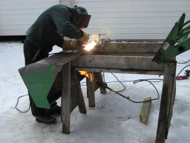

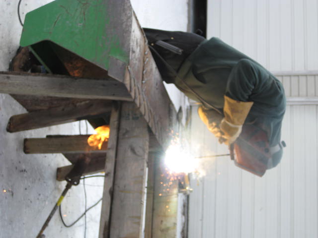

The welding

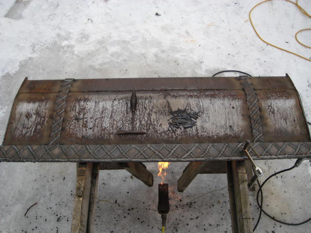

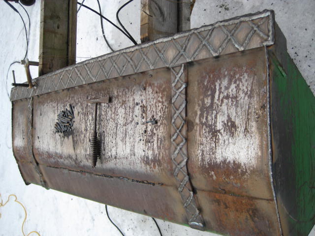

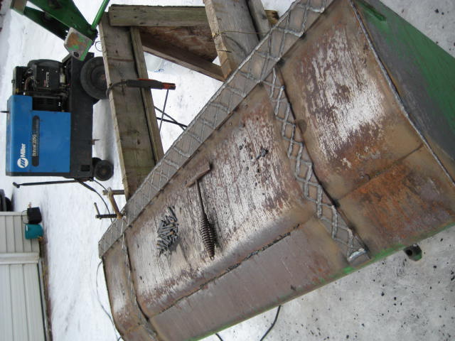

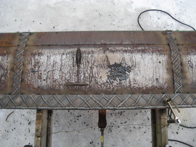

The end result, and cool down.

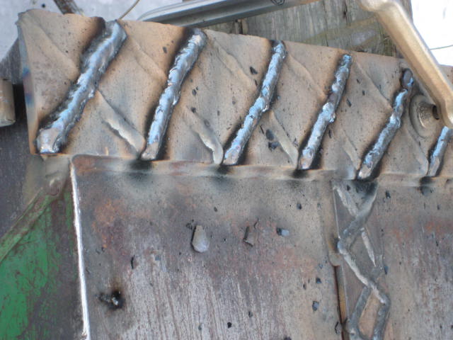

Hook,
Nice pictures. It was a good day for outside work today. Uncovered my black top - just in time for more snow.
I would face the areas between the wear strips too. That's where the bucket will hole thru first.

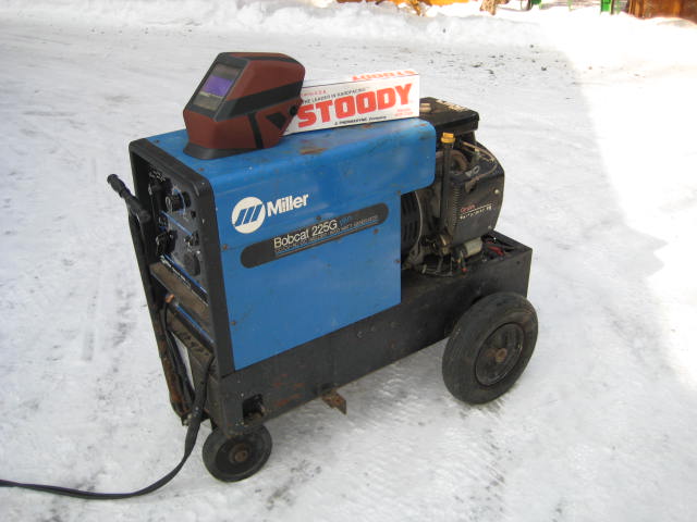

I really enjoy welding, but if I had to do it again, I would use Highbeams advise and use 7018. I think the 7018 would be easier to use and less money. Not saying the stoody is a bad choice I just needed more practice. I did have a hard time adjusting to the hard face rod.

Hook, Good lookin' job! I did the same thing to my FEL bucket last year. Used the same hard-surface rod as you...
Did my work inside, though. Didn't preheat the bucket.
John_bud is on the dollar, too. The area of the bucket just before it rolls back is a place of significant wear. Notice how shiny it is?
I added a couple of additional wear sections of 3/8" flat bar (maybe 3"x4") welded to the area between the full length wear sections and hard-surfaced those, too.
AKfish

Thanks guys, I didn't think about adding plate to the bucket or hard facing the shiny spots. I guess I get to do some more welding :D :D :D I have enough rod left to finish that.

Hard face rod is not the easiest stuff to weld with. At least it was warm with the fire!

Farwell Thanks, I did think it turned out to well. But the posts made me feel better about my work. The biggest problem I had was adjusting to the longer arc length. I still plan on adding the extra plates that Jon Bud and AKfish had recommended. Just out of curiosity, do you have any pictures?

Howdi. Stoody 19 is a good choice as is 21, 31, 35 or wire such as 101,110. One thing to remember is if you have a half inch of material missing, You will need to build it up prior to hard facing. Hard facing materials should only be put on 2-3 layers. If you want a nice booklet on hard facing send me you address and I will send one to you.
MM ( Stoody Rep.)
This is right on. The reason for only applying 2-3 layers of hardfacing is simple. It will break off. The reason for not only applying 1 layer of hard is it mixes with the base metal and won't be the hardness desired. The second layer achieves desired hardness. I usually only apply 2 layers. I also use Stoody Hardfacing alloys. Have for years, with good results. Build up with a E7018, then apply your Hard stuff. Be prepared to pay for it though. Those rods ain't cheap. Most welding supply houses won't sell less than 5 lbs. Some even more quantity. Good Luck.
