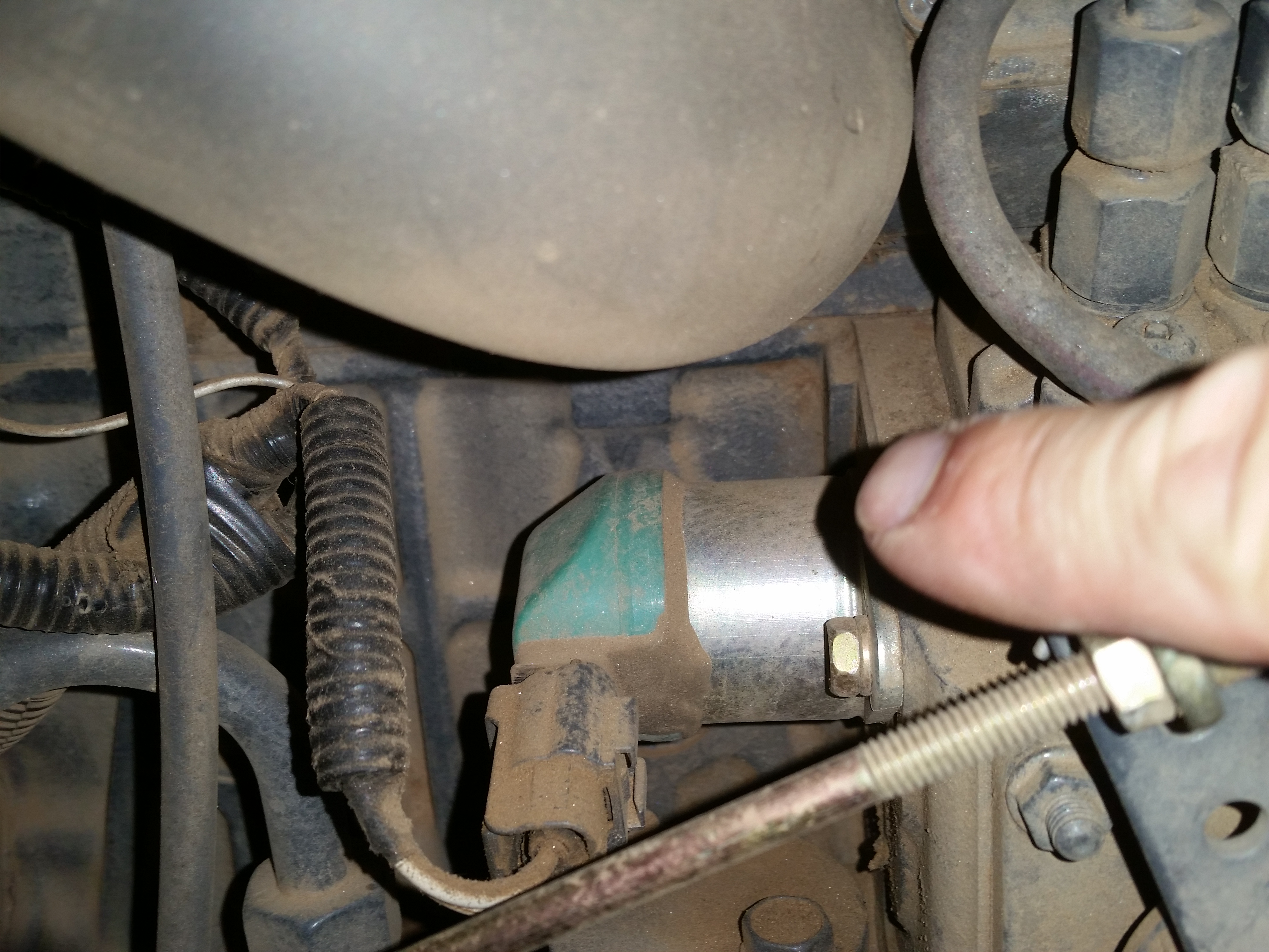

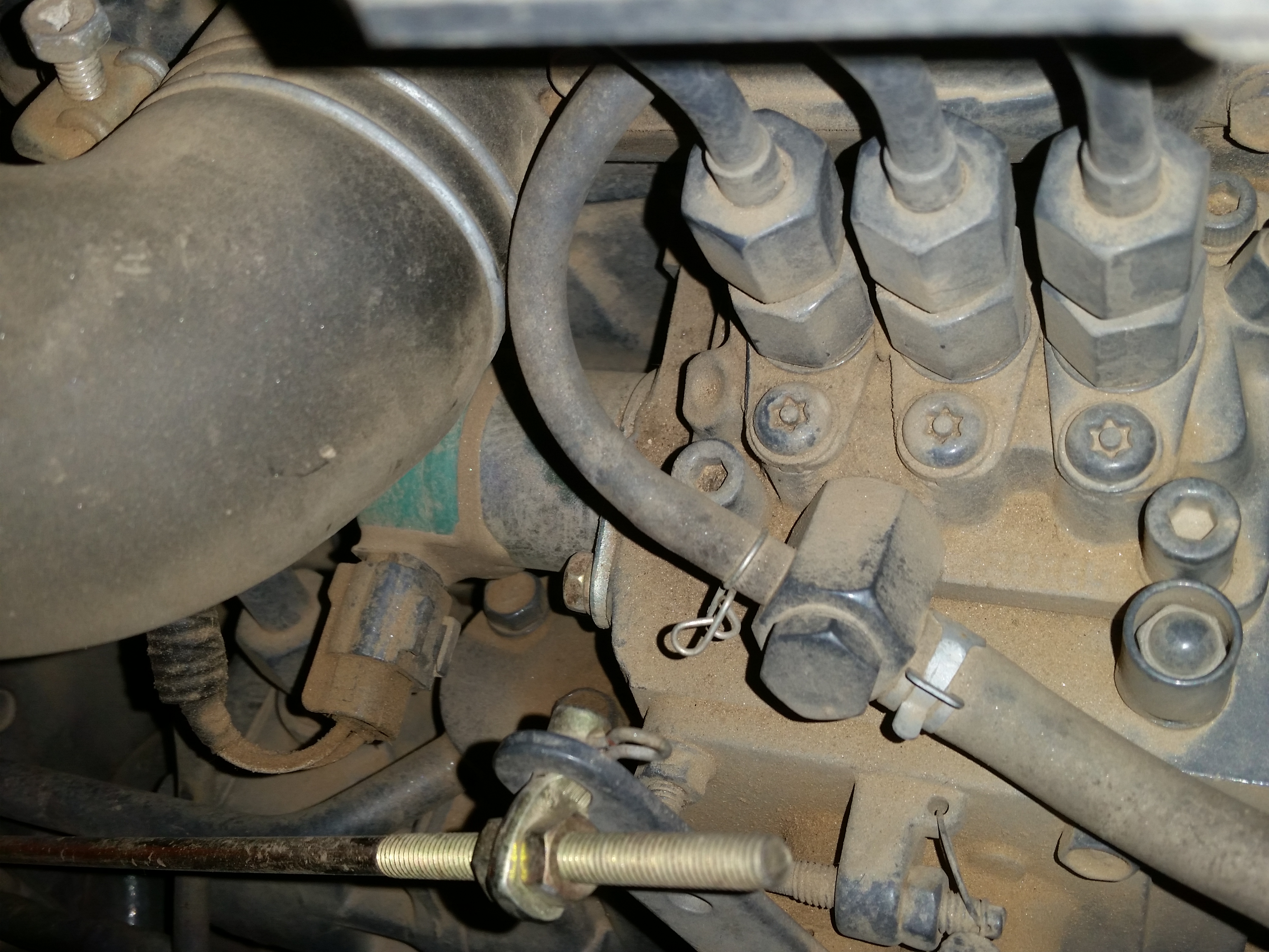

Here's pictures of the newer type without the timer. I don't believe you can open them up. 1474674387366.jpg
And a ref on location
/ Hard starting B7610 #11
Here's the delay style, as you can tell it just activates the shutdown lever on the injector pump.
