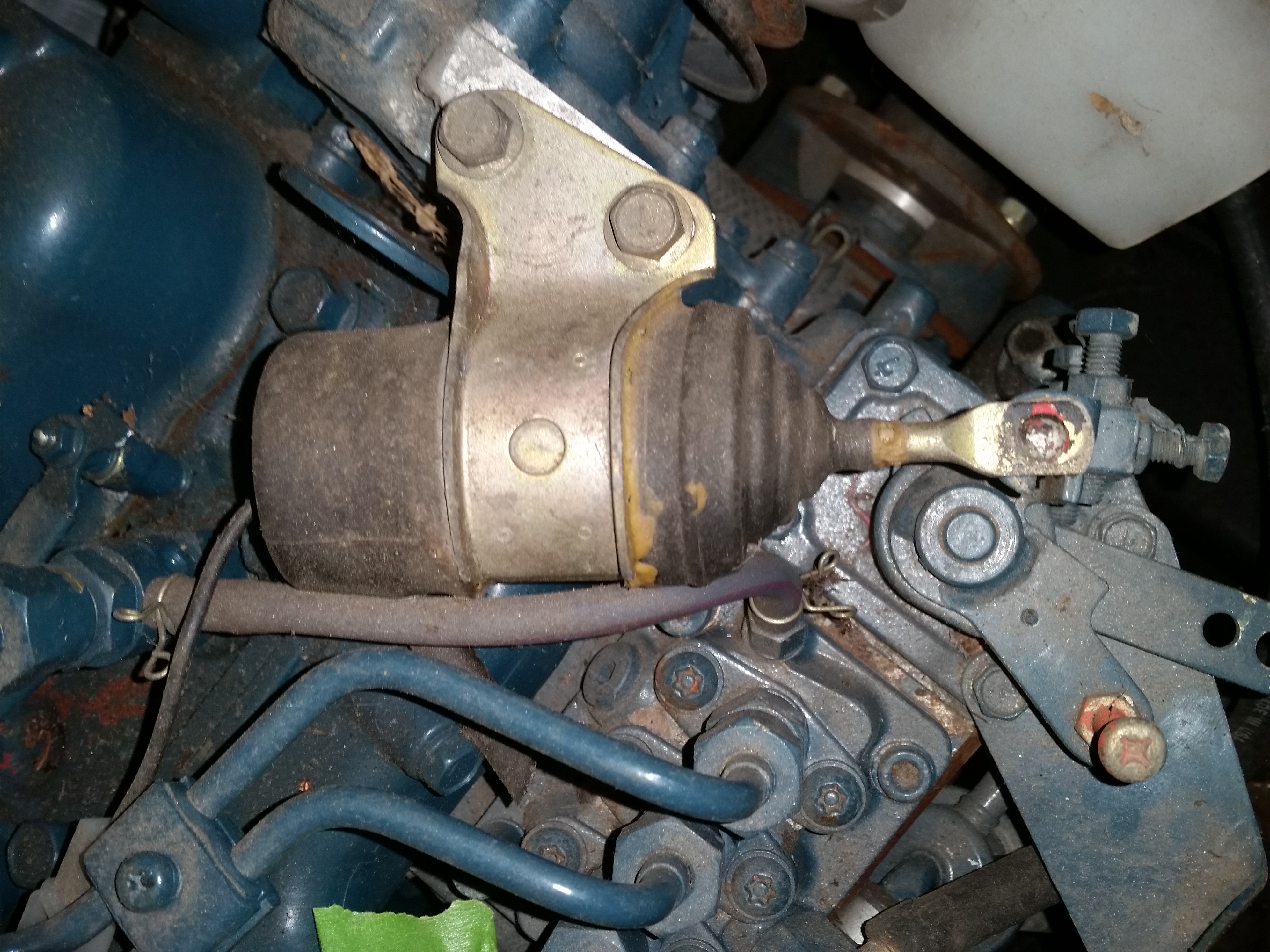

Sep 23, 2016 / Hard starting B7610 #11 TMGT Elite Member Joined Jul 31, 2015 Messages 3,156 Location Stafford, VA Tractor B2620 Here's the delay style, as you can tell it just activates the shutdown lever on the injector pump.

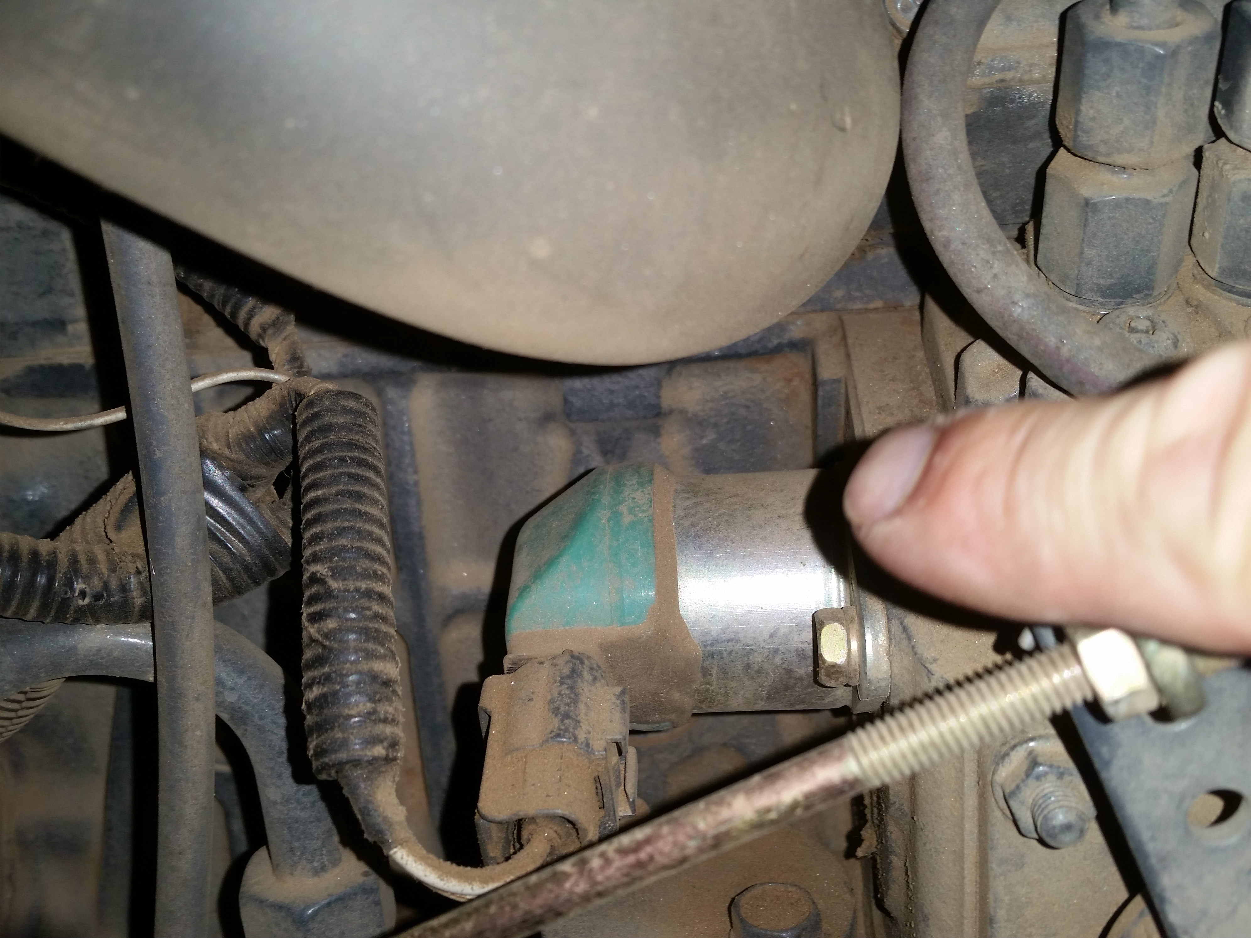

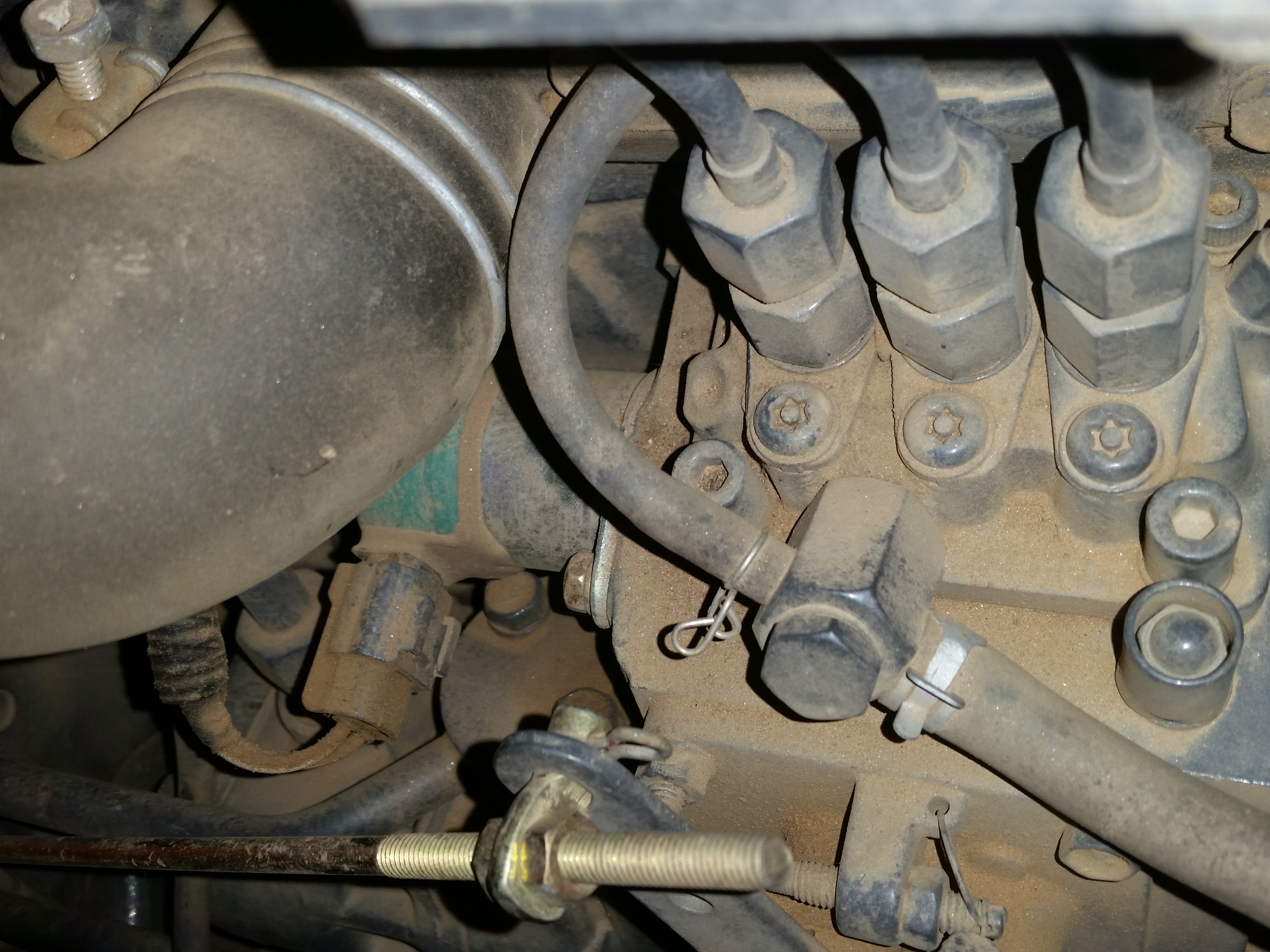

Sep 24, 2016 / Hard starting B7610 Thread Starter #12 OP T tony3542 Bronze Member Joined Oct 20, 2002 Messages 66 Location Nashville Tn Tractor 2006 B7610hst TMGT said: Here's pictures of the newer type without the timer. I don't believe you can open them up.View attachment 482164 And a ref on location View attachment 482165 Click to expand... Thats like the one on my tractor.Guess it needs replacing if its getting current.Thanks for the pictures...
Sep 24, 2016 / Hard starting B7610 #13 TMGT Elite Member Joined Jul 31, 2015 Messages 3,156 Location Stafford, VA Tractor B2620 Might want to check the lift pump also and make sure it's not letting the fuel drain back.
