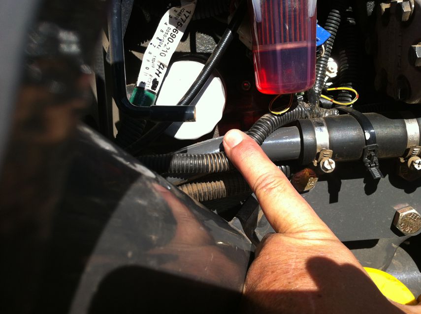

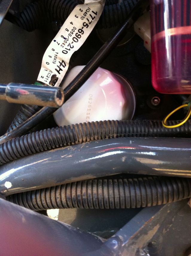

So does anybody else have an oil filter that looks like this on their Massey? I have to change the oil for the second time tomorrow. I had a heck of a time getting the filter off the first time. The only tool I had that would fit in this little place was my hand. I have a few oil filter wrenches but you can not use them because of the Hydraulic line in front of the filter. You would think an engineer would figure this out right away and not produce this stuff like this. Hopefully I do not have problems taking it off tomorrow as I only turn them 1/2 turn by hand once they are seated.

Most auto parts have end cap oil filter wrenches where you use a socket ratchet to loosen the filter. Since filters are different diameters, measure yours and how many facets it has then go shopping. Service centers use an end cap type filter remover. Along time ago I used two phillips screwdriver and drove them into the filter at an angle to twist the filter loose. I now have one of those fancy self adjusting end cap wrenches that will work on any faceted top filter.

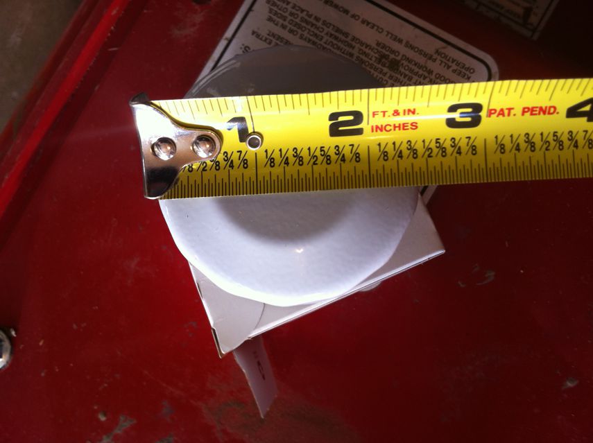

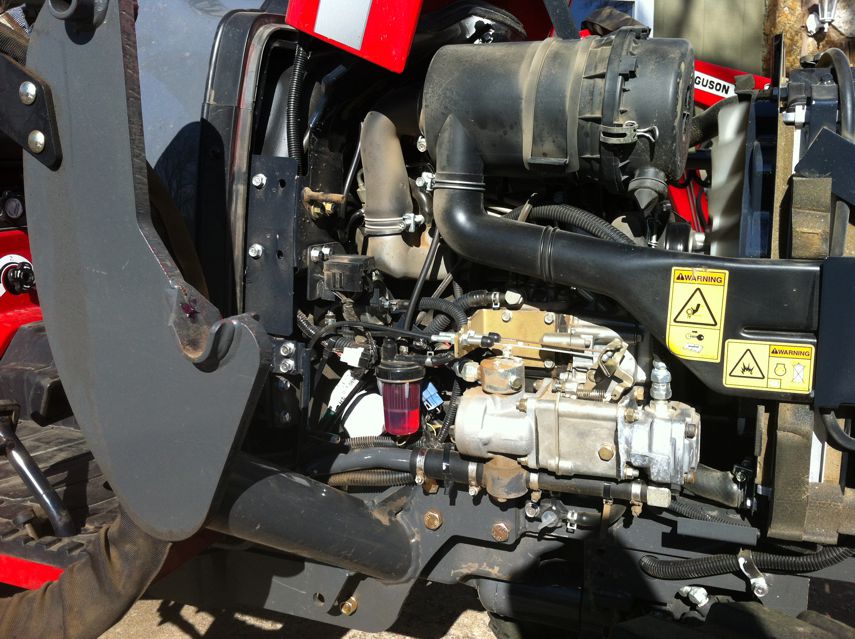

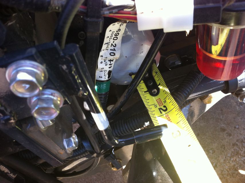

Here are a few more pictures, One from further away. As you can see, it is a very little filter. I changed the oil, filters, transmission/Hydrostat oil, filter and cleaned the strainer. It was a pretty nice day out today to get it done. Now I am ready for winter.
The oil filter came off by hand with no problem. I loosed it up last night while it was cold. I will have to check and try to find a cap wrench, just in case it is too tight next time. It will even be hard to use one of them. mguitas, I would say your tractor is pretty close to mine. WilliamBros had a 1523 and said it looked like his too. I used a tape measure to give you an idea how close everything is around it.

Yupp, that is as tight as our 1523 was. Did you keep the filter? Take it with you to try out an end cap wrench. Do you have a swivel extension? Get one of those too, it will make your life easier.

Thanks for the pictures. I will get another oil filter and take it with me to make sure it matches. The motor looks just the same. If you click on my pictures it will make them bigger. Dont know why yours show up bigger on the computer. One difference is that your Hydraulic line curves below the filter where mine cuts right in front of it. That line is the biggest problem. But it wasn't that bad. Thanks for the info on the wrenches. I will check it out later.

I think the end cap will be the best bet, and with a short swivel extension, you can spin it right off with no problems.
