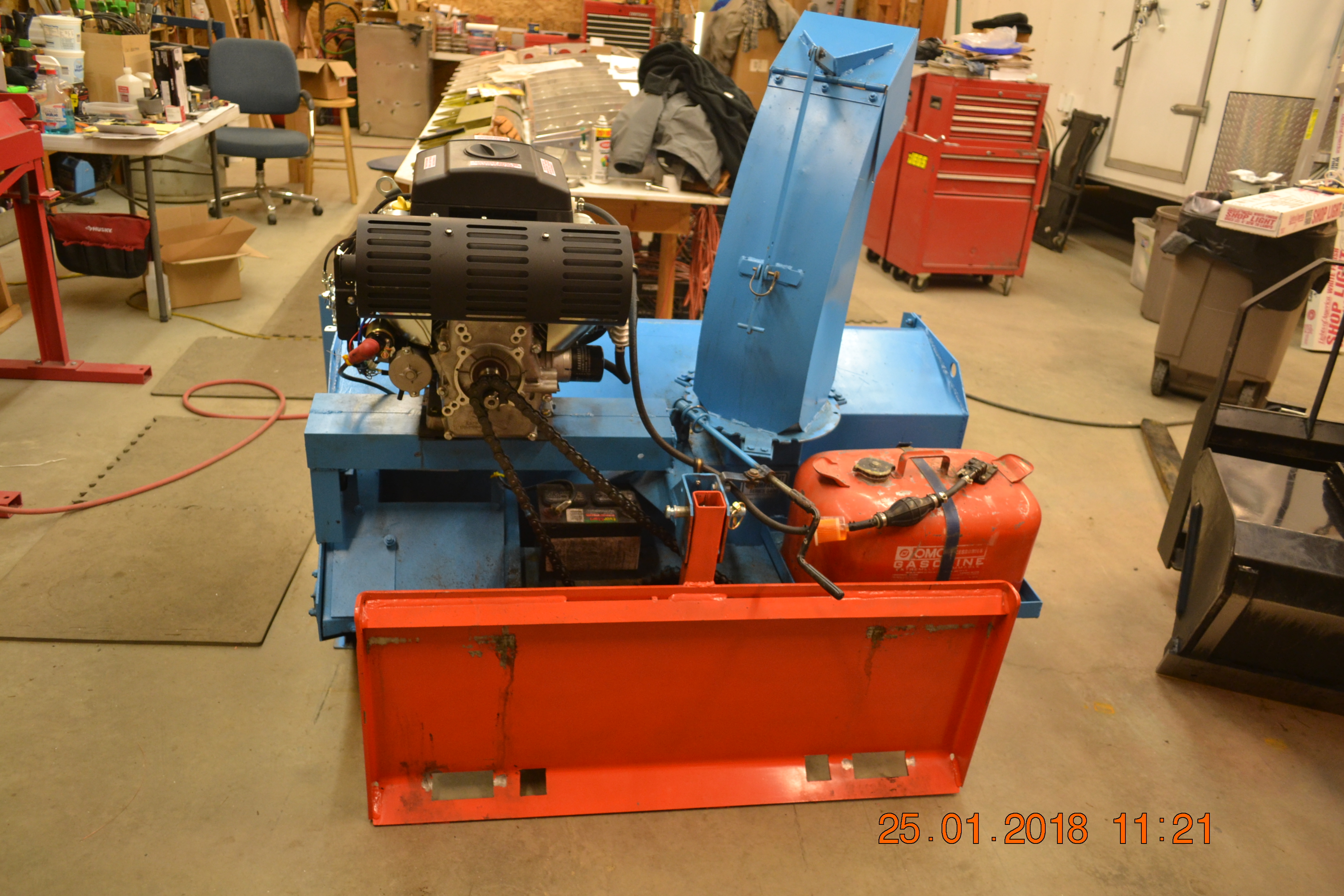

Not sure why the duplicates but.....
   / Hard to use diff lock
#52
Conversion cost about:
Engine: $620 with coupon
QD plate: $100
Chain and sprockets: $175
I had some steel to make the QD attachments and of course expert welding...free. I paid $500 for the rear snow blower so the entire thing cost about $1,500 and allows the whole thing to be lifted up on the FEL to clean up and take it up to blow snow deeper than 16 - 18". We had one snow of about 28" which required two passes but worked fine. I welded a piece of 2" angle on the bottom of the front edge to keep it out of the rocks and also skids on both sides as well. No problem at all with picking up rocks or dirt.
I bought a 2500 lb remote control winch to control the chute but haven't got around to installing it. I haven't found it a big deal setting the chute to throw to the right and do most of my drive and area between the house and shop (80' x 100') using just the "right" setting. I do sometimes set it straight ahead to move snow in different areas. It's 1.3 miles from the house to US 95 so all the neighbors do their part to clean the road. I clean the 1/4 mile along my property and usually the widow's drive and parking area. Takes about 2 hours to do it with the blower from inside a 70F cab...great improvement over heavy clothes and wet condition on my old Ford...but I do kinda miss it.

Lowrider,
I followed this over from another thread. Seems to me your modified blower is worthy of it's own thread. I don't want to hijack this thread further, but I like your modified blower. I'm curious, do you think the 22 hp gas engine is the limiting factor on your ability to blow deeper snow, or is it something else? I would really like to have a loader mounted blower, but trying to resist the whole rear hydro power pack solution.

Hey Slim,
I don't have a clue on how to move this info to another thread.
I ran the blower off my BX1500 which is about 9 PTO hp diesel and it would bog down too. The 22 hp gas engine probably is a more power than the diesel but seems to do the same work. A more powerful engine would certainly throw more snow but it really seems to be a function of tractor speed more than blower capacity. With the hst I can go at whatever is appropriate for conditions and wet snow certainly dictates a slower speed...light fluffy stuff will allow a faster speed. In ND you probably get lighter snow than we do, although it depends upon whether it's off the coast or from Canada which is usually lighter.
Hope that helps and I'd be happy to try to answer any other questions out there.
