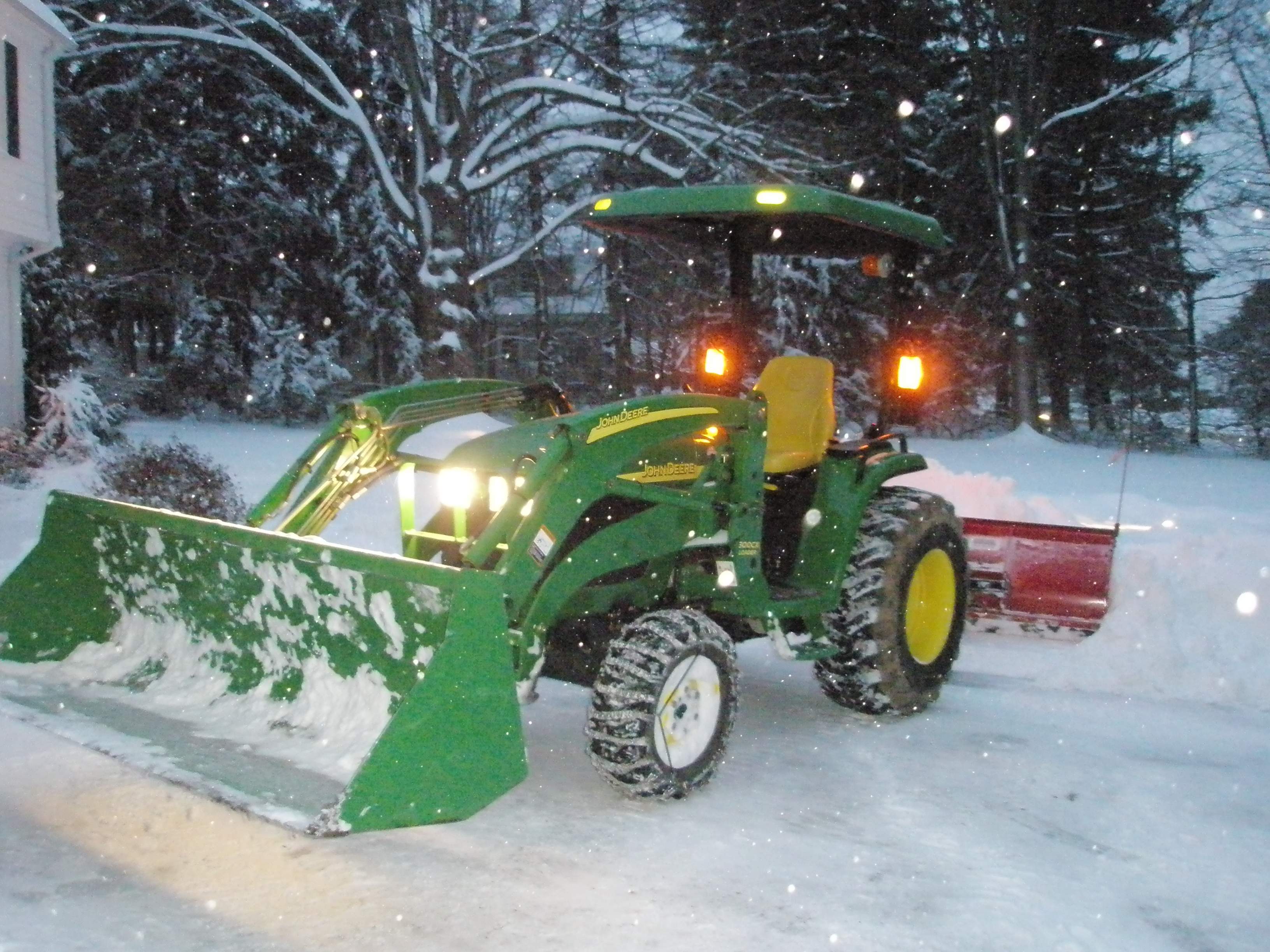

I got mine from the JD dealer, cost a little more than the after market ones, even though I know Deere doesn't make it, it's well made and looks right, the only thing I don't like is how it makes it alot LOUDER!!! while in the seat.

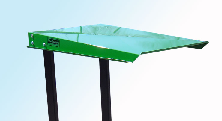

Heck, why not make your own?
Any sheet metal fabricator could fold edges on suitable sized sheet of aluminum (for stiffness as well as to form a 'rain gutter'), could be made stylish by tapering the fold towards the front.
Attach to the rops using proper sized 'U shaped pipe clamps' available at most hardware stores. Rops would be wrapped with rubber 'tape' to prevent marring the rops and prevent slippage.
You would then want 2 struts from each vertical side of rops to support the weight of the shade, these would also be clamped in same way.
OR a triangle shaped 'side', say 12 x 16 with a 90 deg 1" flange at top that would be attached to rops vertical sides same way as top clamps.
Bet you'd get that all done for no more than $100 more or less!
Would look kinda like the Laurin
