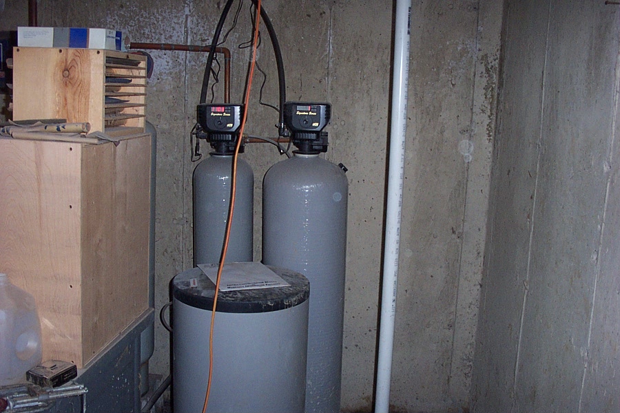

Good Mornin Wayne,
We have been plaqued with hard wate, high iron content, and high manganese levels for years at our Ct home. When I first built the house in 82 I had a system installed and it worked to some degree for many years and then it finally quit ! Two years ago I installed the system in the attachment. It is a CSI Signature system, andI have been using potassium chloride in it. I can also use salt in it with out really changing anything, but as another poster stated the potassium is better for you ! Its great for showering, drinking, laundry, fixtures etc... I would reccomend it. I believe it cost me about $1500.
If you have any other questions on it please feel free !
Sorry about the messy picture ;) Im in the process of putting drainage on that side of my basement ! :)
