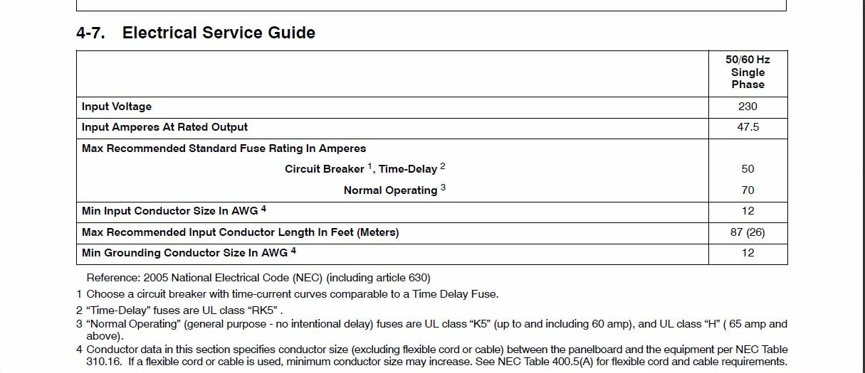

Currently, I have a 100 amp Century purchased many years ago. Granted I hardly use this machine but that may have something to do with how hard it is to use. (AC only, always sticks) I'm thinking I need something better but I have a couple of problems. First, I only have 10 gauge wire going to the service in the garage (100' run). Secondly, I've been told that I need an inverter or mig type welder as a result of the electrical weakness. I would like to rely on my generator if I could (5000 watt 20 volts) in a pinch. I would have bought the Hobart ac/dc machine and be done with it but people tell me I won't have sufficient power for it either with the generator or the garage wiring. I looked at the Northern 200 Mig/Stick inverter type welder for a bit over $600 but do not know enough about it and how good or miserable it is to use. (no reviews) Any enlightenment would be appreciated.

Can you move the welder closer to the main supply and try a weld there? basically get ride of the 100' run just to see if there is a major difference.
I have run a Hobart 120 handler (wire welder) for several years with a 5000 watt generator, I never had a lack of power, but again it was a 20 amp wire welder.
If you get a good result at the supply and you really don't weld very often, I would just weld there on occasion. Best thing would be to power up your shop with the right size supply line.

Now for you electrician types. I am to understand that 10 gauge is 30 amp wire, At 220 volts, would 10awg wire be sufficient to run the Hobart 235/160 ac/dc welder with a dedicated 30 amp breaker or does this machine need a higher rated breaker?

From Hobarts website-
Amps Input at Rated Output, 60 Hz 230 V: 47.5 A
so no a 30 amp breaker ain't gonna cut it..
They recommend a 50 amp breaker if time delay or 70 amp if a fuse.
Believe it or not Hobart actually has a website where one can look this stuff up:p

I am not the electrician type but i have a little experience with this.
When I built my shop an electrician ran 270' of 4 gauge wire out to supply 100 amp service in my shop. they told me with the distance in reality i probably have about 60 amp service.
I have a miller 180 which is a 220V unit. It is on a 30 amp breaker and works great. I bought a 50' extension cord for the welder so I can use it anywhere in the shop and even out side. The ext cord was $100 and it is 8 ga wire.

Regarding wiring, don't think you should run any AC/DC welder on 10 awg wire, but turn it down and you might be able to. Last one I wired was on a 60A circuit I think, was a long time ago, kind of forgot...

I have the Hobart AC/DC Stickmate. According to the manual which I have attached, you can run this welder on 12 awg wire up to a distance of 87 feet with a 50 amp breaker due to the duty cycle of the welder (page 15). The outlet must be labeled welder only. Using the 10 awg wire you may get away with 100 feet. However, if anything else is on this circuit which if I understand correctly a dryer is and it is feeding everything in the garage, then this setup is not an option. I did not see this mentioned in the previous posts and this is not the way I would set up my welder, but I thought I would mention it. Had to compress file due to size. It is a PDF. Also attached is a screen shot of page 15.
Terry

NEC 630.11 shows derating table based upon the duty factor of the welder to be used in determining wiring size.

Emmy, that was extremely useful information. The dryer is not on the garage circuit. The garage circuit is on one dedicated 10 gage line with nothing in between. When I attempted to open up your diagram my computer stated it was "corrupted" and would not open up. I'm thinking of putting the welder socket right next to the service in the garage or about an 8' run from the service. The garage can remain totally quiet and off as nothing else is on it beyond lights and sockets. I do wonder what the Hobarts diminishing returns are as electrical supply gets longer and amps go up. I'm thinking 150 amps tops for my situation and 140 amps on the generator. DC is a whole nuther situation where I'd probably get even less. That Northern inverter type 200 mig/stick welder looks interesting. I dunno who's making that for them as it just says "Northern" on it. Looks like alot of welder for $600. I'd paste a picture of it but it is not allowing me to.
