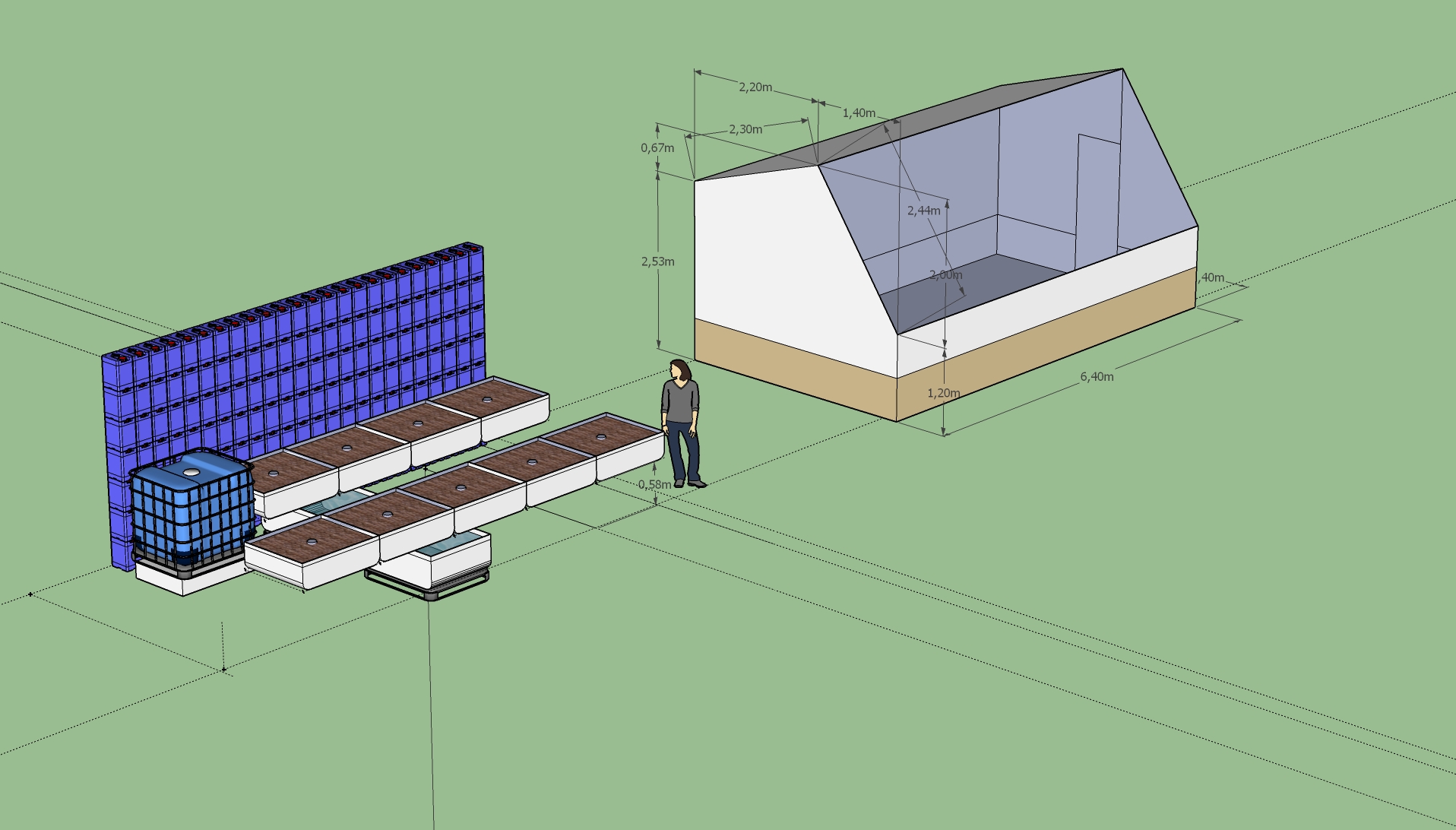

People have built "pit greenhouses." From covered dirt pits to something more refined.
If this design was earth-bermed on the back and the rear half of the end walls, it would be a good start. Figure out the night time insulation of the glazed area, and you would be most of the way home for very low cost heating.

Well, there you go. :) Update that basic idea a bit with modern materials, some added thermal mass in a concrete slab, some earth berms, and that would work.
Judging from my passive solar house, that design of greenhouse I showed would probably hit 100*F+ inside on a sunny day in winter. You would have to dump some heat on those days and have a way to open it up in summer. I think some automation is key to doing it well enough to avoid stressing the plants.
The concrete itself will stay at some fairly stable temperature that changes very slowly if there is enough of it. It works like a flywheel that has thermal inertia.
I am always tempted to start gathering building rocks. I have some mostly south facing slopes to work with.
