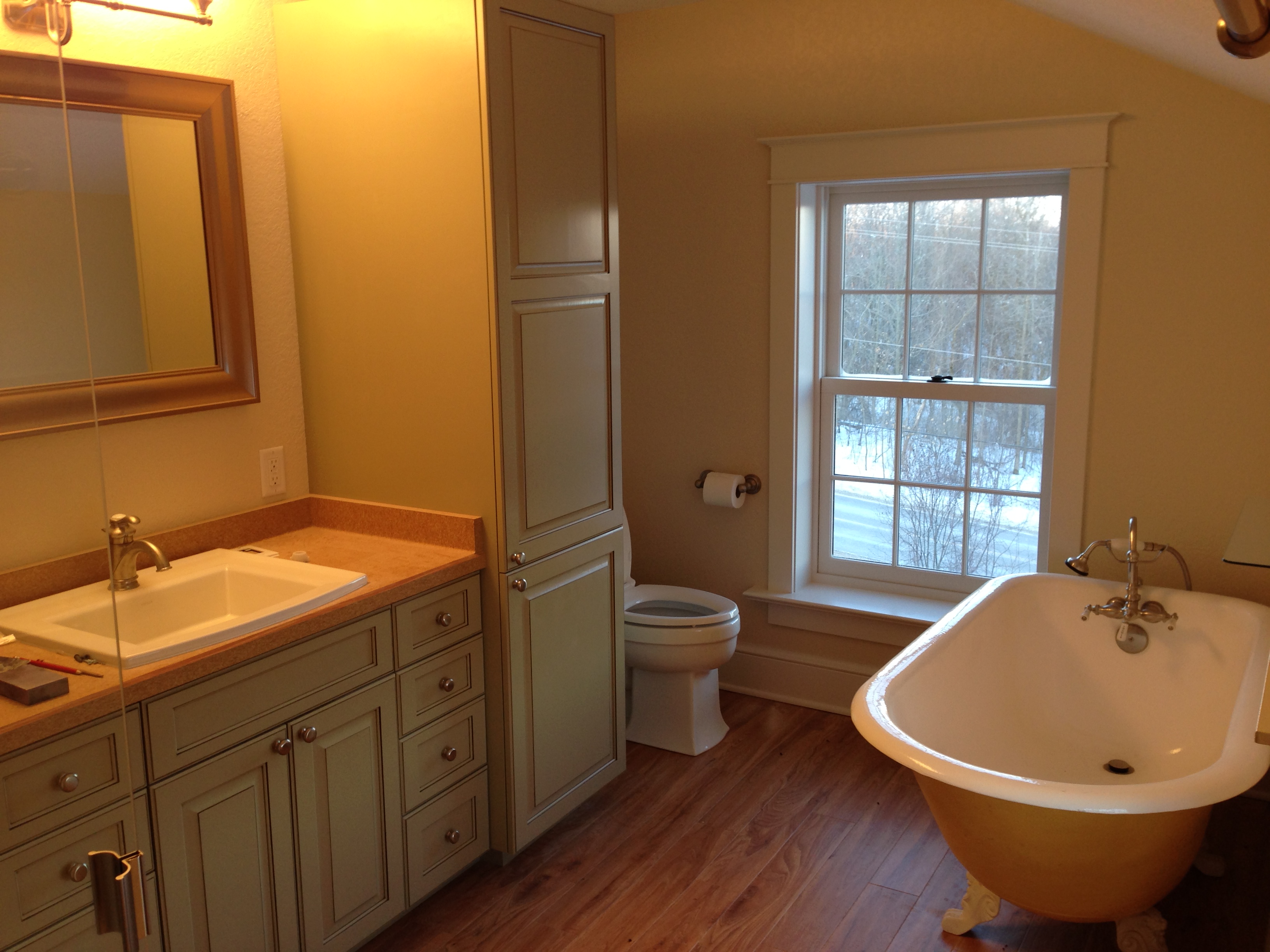

I used to remodel homes installing kitchens and have seen the crap that some sell as a "quality" cabinet. Wow. You definetly get what you pay for. For all of my personal projects I've been installing Sherr's cabinets. They are CNC RTA, and everything fits together perfectly. Boxes are plywood, drawers are dovetail with full extension slides and soft close. Typically I order the cabinets European style with full overlay doors. Once you have a full overlay door, you'll never go back to a face frame cabinet box. I typically order the cabinets pre finished with them matching to a door sample that we purchased from a big box store. Don't forget to order the accessory mouldings at the same time so they can be finished to match. The cabinets come via truck and I typically pick up the crate from a freight terminal so I don't have to pay the lift gate fees. Assembly is easy for two people, if not a bit time consuming. It all goes together with out cutting; just wood glue, dowels and cabinet screws. You'll need a large area to assemble the cabinets so I'll typically take the entire garage over and then move the assembled boxes into the room as the installation progresses. The one thing that's slick about RTA is that if door clearances are tight, you can always assemble the oversized corner or pantry cabinets right in the kitchen.
Oh, and take at least one 36-42" wide base cabinet and ditch the doors. Have Scherr's make a 4 drawer cabinet with trays attached to the drawer fronts. The wide shallow tray and full extension slides work awesome for pots and pans. The last kitchen I did had base doors on the corner cabinets and everything else was drawers. It worked awesome; she loved that kitchen.

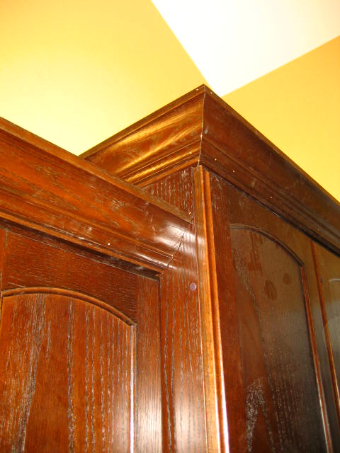

Couple pictures of her favorite kitchen. Sadly the project went south and we sold it a couple months later. The cabinets were oak with a sealer, dark stain and glaze. Typically I don't like oak because with a light stain the grain becomes too strong, this one turned out really neat though.
