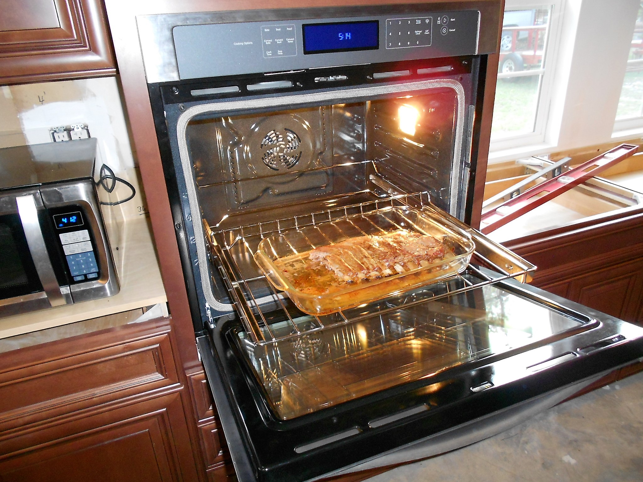

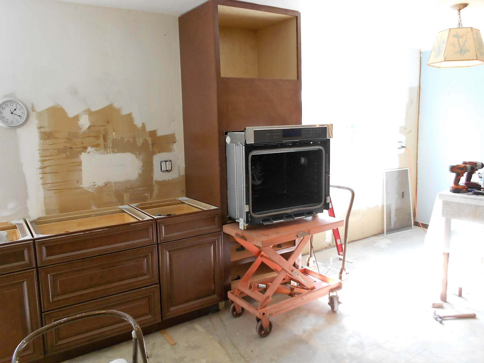

I ordered RTA (ready to assemble) cabinets on line from kitchencabinetmall.com
Disclaimer- I AM NOT CONNECTED WITH THEM
After they sent me a (free) door sample UPS, I ordered 21 cabinets and a filler panel.
I got my cabinets delivered by LTL carrier 10 days later in great condition on 3 pallets.
The cabinets are BEAUTIFUL! DEAD-ON square and solid! Have full open drawers with slow close drawers and doors.
I started assembling the oven wall cabinet because it was the biggest and in the way. Come to find out it was the hardest!
I ordered an 8' tall cabinet and didn't think about how to assemble and install an 8' cabinet in an 8' room!
I figured out that I could cut off the bottom even with the toe kick, assemble, stand up and splice the cut offs back on and reinforcing them.
A cabinet on each side hide my butchering/repair.
I had to cut out for the oven which required measure 25 times and cut once! I got it!
I am very happy with the cabinets and my only complaint is they came with NO instructions! NOT even a pic of how the pieces go together.
The panels are easy to figure out but the little angle clip locations are a best guess.
The cabinet side panels are dovetailed into the cabinet front and all assembled perfectly.
I still have to install the island and order counter tops but it is going very well.
Pics are cabinets, oven cabinet and I broke in the new oven with a slab of ribs! They turned out perfect!

   / Has anybody ordered Kitchen Cabinets online? #35
Stimw,
They look great. Oh yeah the cabinets look great also.

I feel your pain. I bought assembled cabinets from a local-ish lumber yard, and tilting the 7'6" oven cabinet upright in a 7'8" room turned out to be an adventure...if I had thought about it more I would have tilted it up before I drywalled the ceiling. As it happens, the tile wasn't in yet and there was one spot in the floor that dipped a bit. Knocked a 5/8x2" triangle off the top back corners (diagonal with the toekick) and tilted it up.
Then did the same thing to the tall pantry cabinet that went on another wall.
Once the tile was in, the oven cabinet went into a corner, which hid one cut, and got a rim of crown molding which hid the other. The pantry had an upper which hid the cut on one side, and crown hides the corner over the fridge. Went with the fridge "loose" on the end, so if someone decides to put in a bigger fridge it won't require messing with the cabinets and the compressor can breathe.
