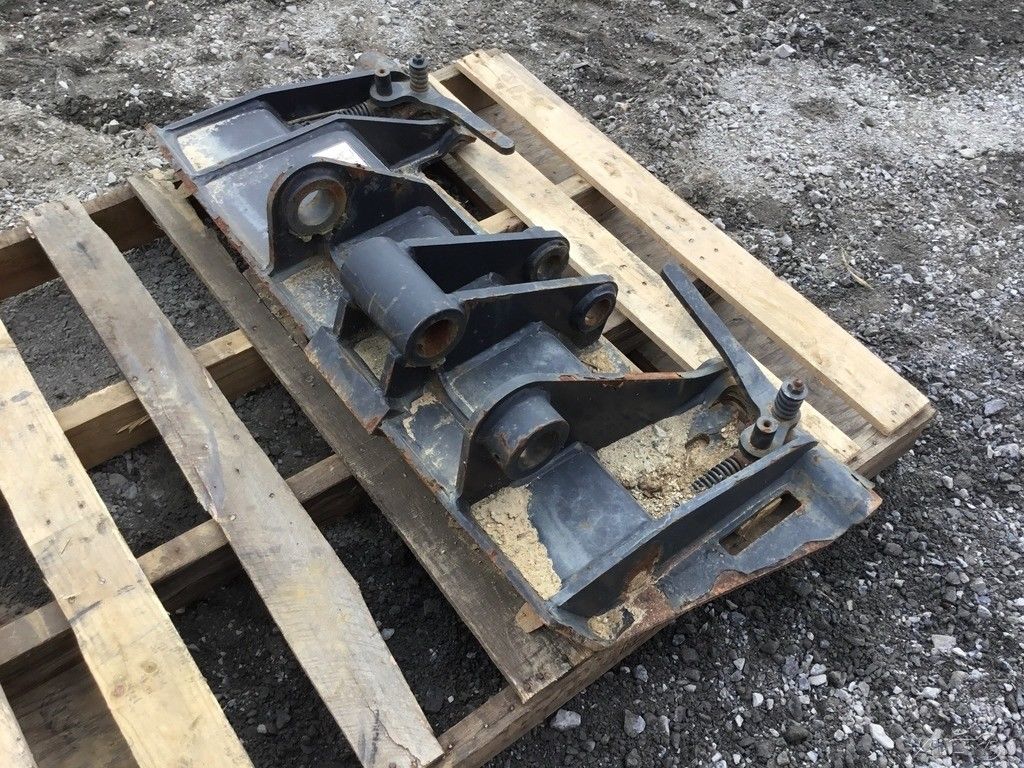

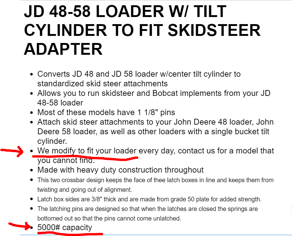

Would a JD 48-58 adapter work?
I had seen this style earlier, but with a 3,000 pound rating. This one is 5,000.
It can be made to fit a John Deere 310j.
5000 isn’t enough. It’s 9500 pound breakout strength and 6500 full height lift.
   / Has anyone converted a full size backhoe to a quick attach bucket? #54
5000 is about as good as it gets in a ssqa.

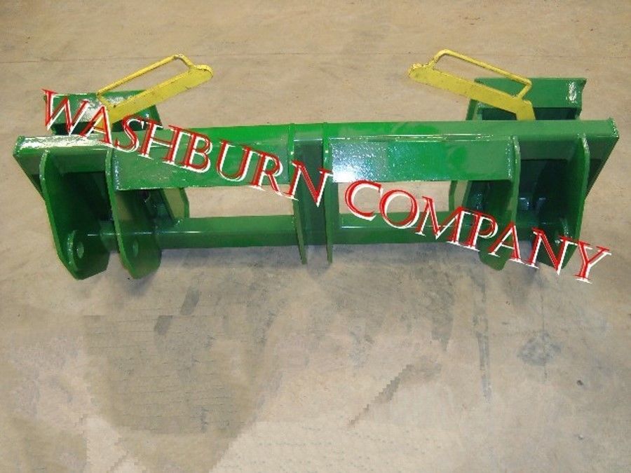

Call Washburn at 800-283-7107 and ask if they can build one strong enough for a John Deere 310j.

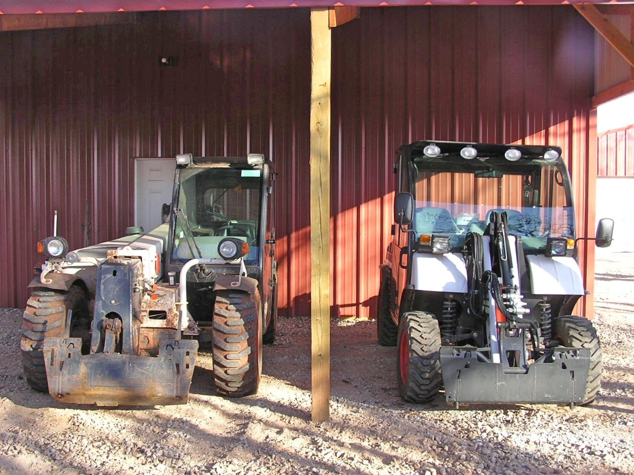

Not more complicated, just different than tractor guys are used to.

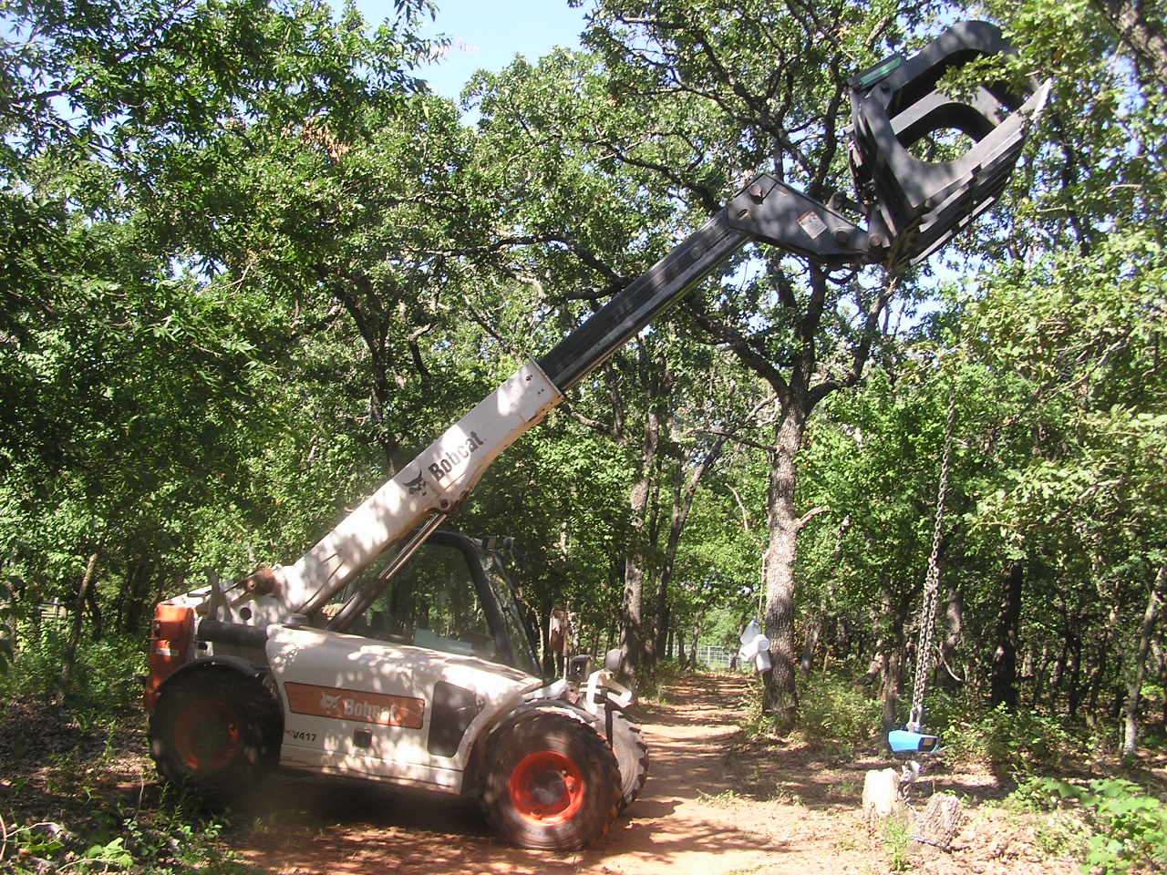

Both of our Bobcats are single cylinder and the SSQA plate is very strong:
The back side of a V417 plate:
Here it is with over 6,000 pounds of force on the plate, note that the rear wheels are off of the ground :thumbsup:

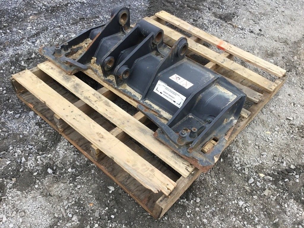

I did order mine from washburn. They claimed it should be good for 7000 lbs. I also bought two 7000 lb rated SSQA attachment blanks. The stuff seems like it it tough enough for my 210, but the 310 is like 60% more in every way. The washburn adapter that I received is a piss poor design, that can damage the curl cylinder, has very little roll back, and the lock pin handles are a nightmare to use. But hey, at least it was cheap! I just hope that they can do a better job on the drawing board for the next guy...
