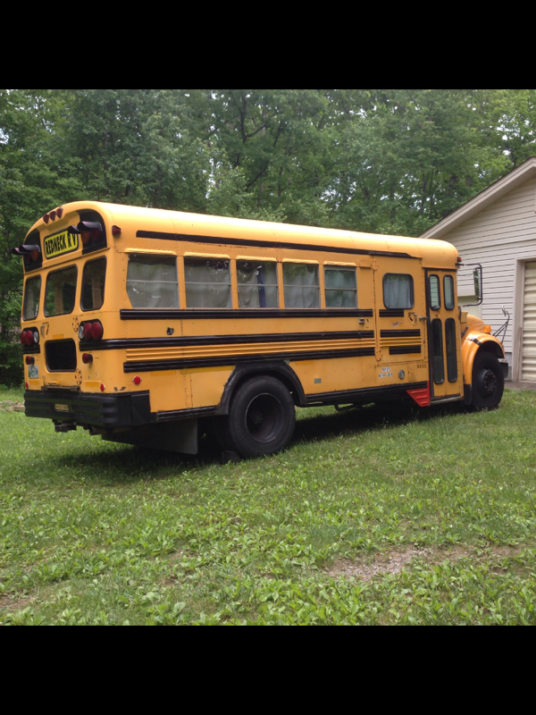

I don't think carbon monoxide will be an issue with overhead stacks. After all it's common for a dozen semi trucks to sit on the same parking lot idling.
That's true but you don't see people eating out in the open in a truck parking lot.

Also true, but there's a big difference in a dozen or more trucks and one bus with a smaller engine to begin with. I agree that a self contained permanently mounted unit would be Way better, but that's not in the budget.
   / Has anyone powered a generator off a truck? #14
That would cost more than I paid for the bus, and there's no good location to mount one. I think I have a generator head that would work. I can fabricate mounting brackets. I don't think carbon monoxide will be an issue with overhead stacks. After all it's common for a dozen semi trucks to sit on the same parking lot idling. The RPM change will be the biggest hurdle. No doubt a stand alone unit would be better, but I don't think it'll see enough use to be justified. I haven't decided on the foods. Likely frozen deserts and drinks and something simple like burgers and hotdogs.
Is this a short bus?

I'm guessing I need about 5,000 watts. It's a 3/4 length bus.
