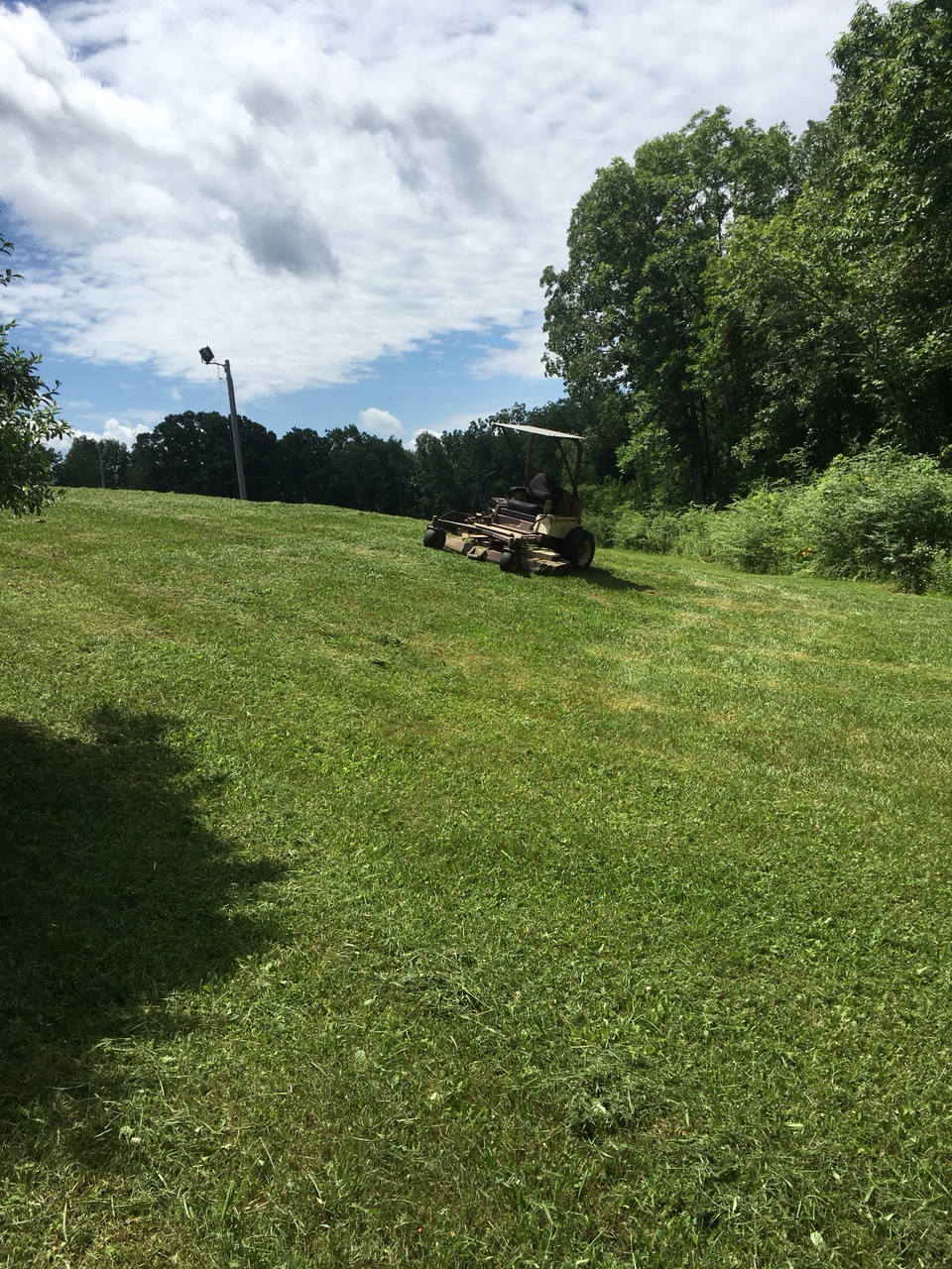

I don’t think a ventrac with loaded duels, and chains is needed for 25 degrees. This hill is 17 degrees. IMG_4349.JPG

What is that on the pole?
Hello plowhog,
I believe it is a floodlight over a parking lot.
