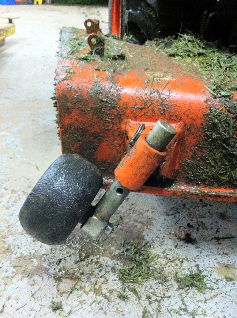

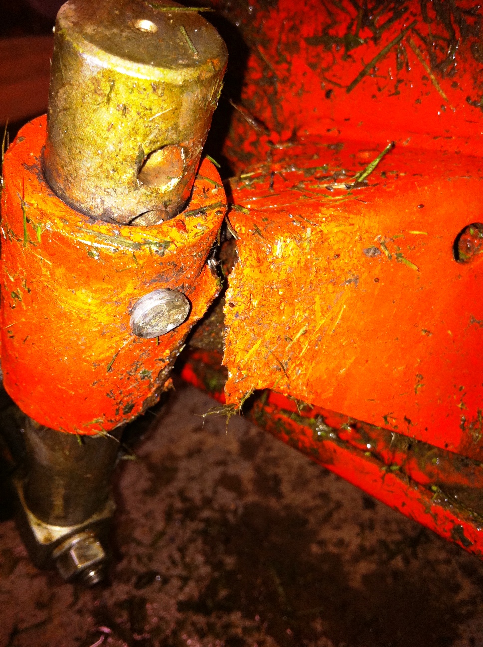

Noticed this the other day. what a bummer. I dont recall hitting anything hard with it. I thought this was super duty guage metal??? I hope the 72 on the B series is stronger....Looks like im welding tonight.

The metal looks fine it is the low quality of the weld.
   / has this ever happened to anyone (broken deck wheel) #3
It happened on ours last year, but we are pretty rough on our mower with my wife frequently forgetting to raise the deck. My son welded it back on; better than new.
I suspect a bad weld as we never had any problems with our BX2200 and I was rougher on it than my wife is on our 2660 and the 2200 is still trouble free.

Thanks guys! Ill clean it up tonight, straighten it, and put a nice weld down. Im glad I still got some Kubota orange paint left :thumbsup:
What type of welder did he use? I have a mid grade Hobart Mig with gas....I know it works great for exhaust work.

My Hobart 210 would do it but if you have a 110 volt mid range, I'd go to a SMAW unit with 7018LH rod. Nothing beats a dc stick welder for implement repairs.

Happened on our BX2660 60" deck. Had it re-welded and all is well now.

I honestly don't know, we have MIG and stick. He is a very good welder; me not so much. I took classes in VoAg MANY years ago and was pretty good then, but now...:eek:
