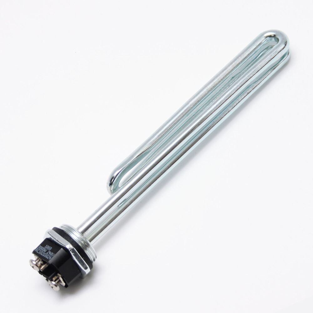

I don't understand how a resistance element can be more efficient? They convert virtually the current into heat? Basically 100%. .?
That's what a normal element looks like.
That's what a more efficient element looks like. The idea is the element has more surface area and the heat will be better absorbed by the water.
Honestly idk if it is any more efficient, it was a good enough idea for me to buy two and replace mine with it vs the regular elements, the cost diff in the two was I think $5 more each maybe.
My old elements were so covered in limescale that you couldn't even see the gap in the elements anymore. The water plant up the road had issues for the better part of a year and the hardness of the water was 25, after they fixed there issue it went to 15. The whole reason I installed a twin tank water softener. Ah well, at least my water is perfect now and I never run out of soft water lol.
