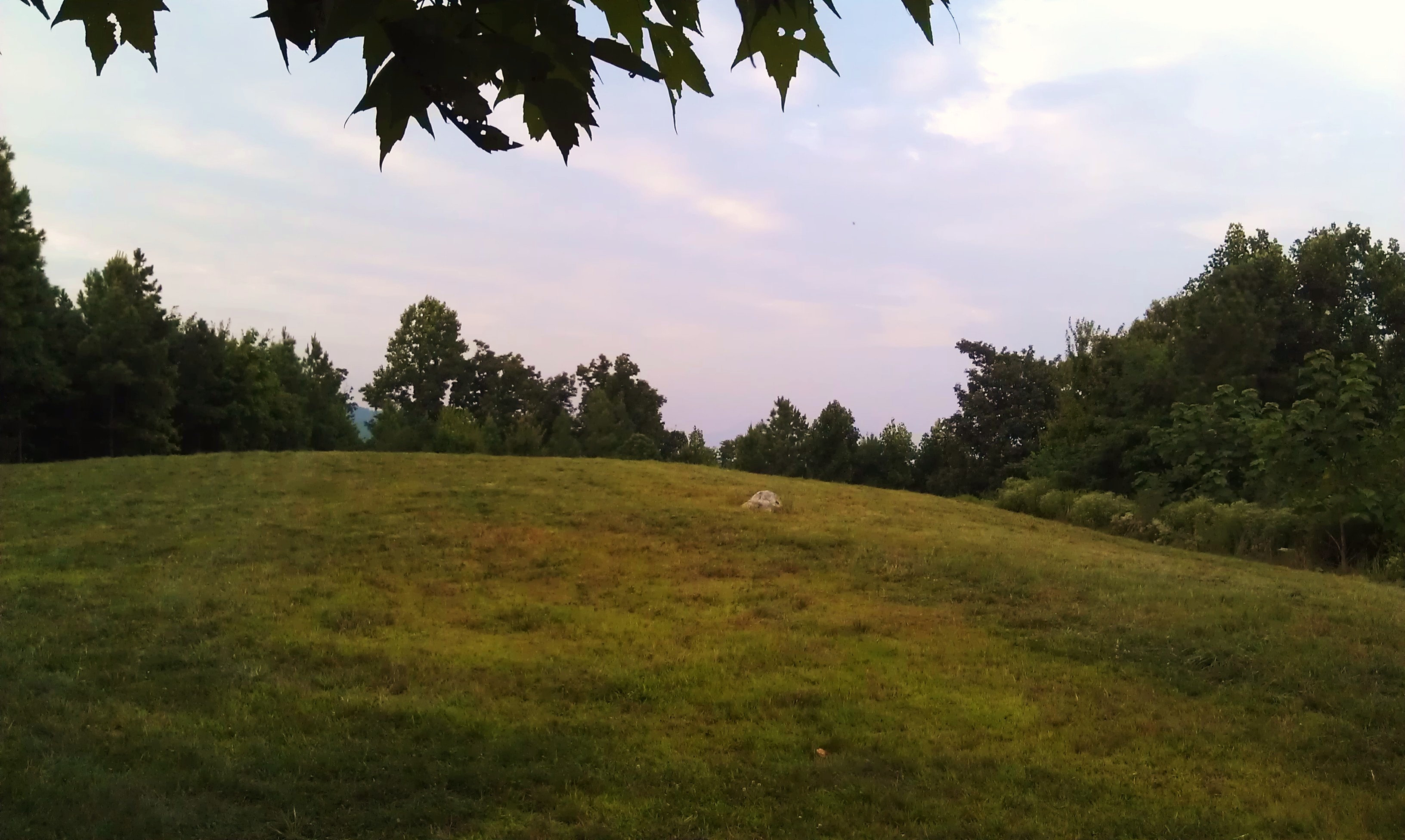

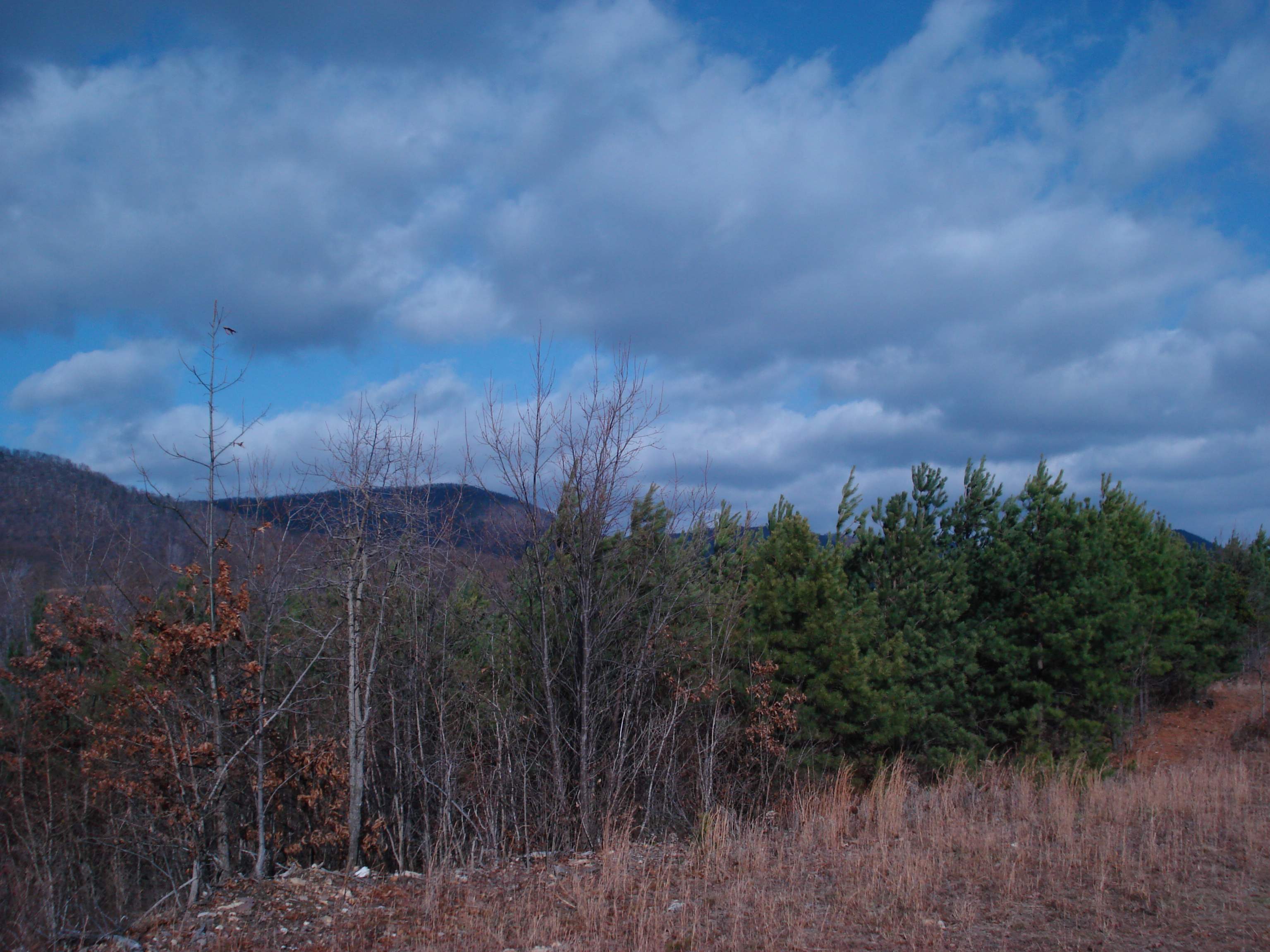

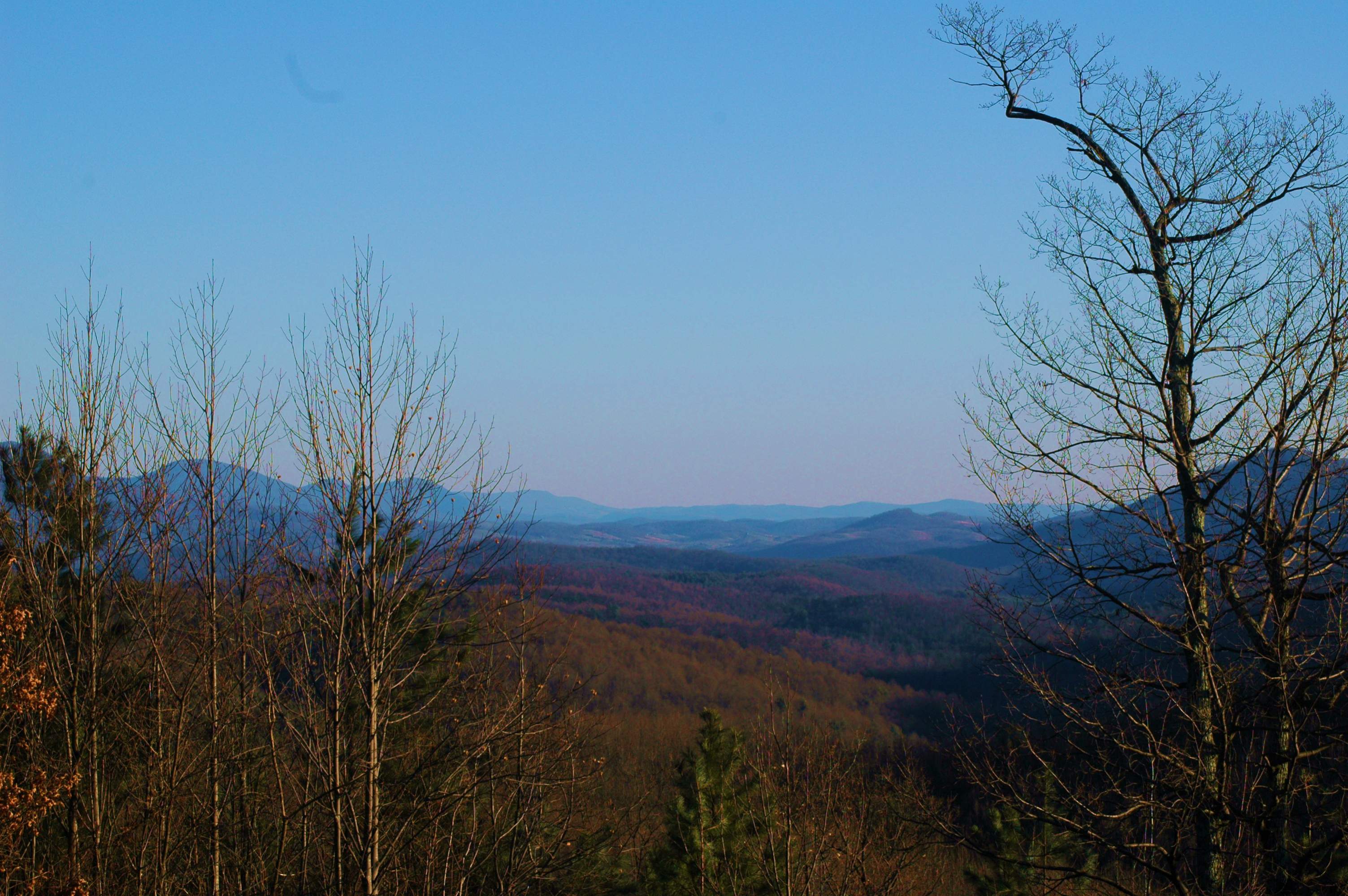

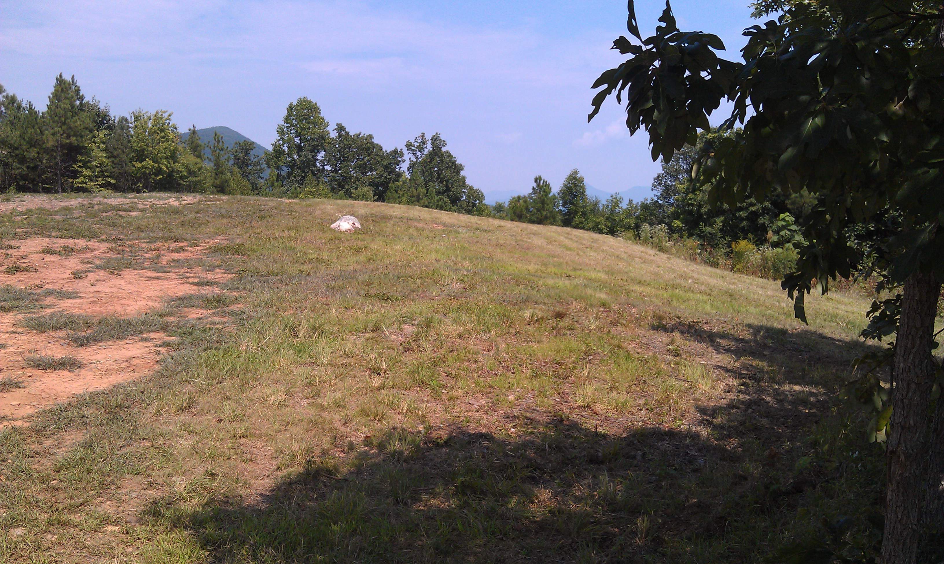

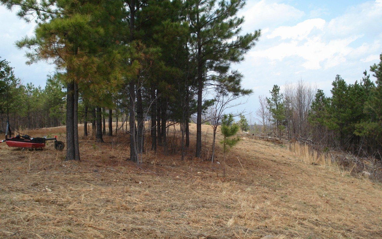

Fellas, I have about 3 acres on top of a hill top. In the winter the views are breathtaking. In the summer with leaves out I can't see anything other than the field. Everyone, realtor, wife, daughter, friends say take down some trees. The rest of the 70 acres is forest with a few trails for deer food plots. (haven't killed anything yet)
I LOVE trees......anyway, I have approx (10) 60' tall red oaks, (20) 60' POPLARS, (150) 50' pines all around this field/hilltop. These first four photos were taken 3 years ago in winter, the last shot was this summer.
I have had THREE timber guys out.....they all look around....then tell me there isn't enough for them to fool with.
IF I took the oaks and poplars down is there an inexpensive way to make lumber and save it? I don't want to pay to have it hauled to a sawmill....then I guess it would have to be dried someway????
If I cut it into rough boards with my chainsaw.....then what?
Am I better off selling the wood for FIREWOOD? I don't have a splitter so I would be marketing "round" wood up to 20" in diameter. hmmmm, that might not be an option either....who can lift it?
I'm not a young feller anymore and usually alone so make your suggestions based on that too.
Thanks

There is no easy way. Trees have it in for people. :laughing: they do tend to close in on an open area.
The pines can be trimmed up from the bottom to 1/3 of their height if that would help. Makes better logs too. You might need a pole saw though.
You could girdle and leave standing some of the larger trees to create habitat and open the view. Wasted wood, but useful over all.
You could pick on the easy small trees, that will make a difference if you can mow in between the big ones. It is a waste, but pile them up and bring your hot dogs and beer.

Photos don't appear to be taken looking the same direction so it's hard to make a suggestion. The first photo looks out and down onto a large valley and landscape, the next three seem to look up a small hill into the sky. I'm in your camp, I am reluctant to cut down anything. Cutting down pines can't change anything from season to season so there's no point cutting them down. Poplars grow fast , could you take some of those down and leave the oaks?
/ Hate WASTING beautiful trees
Beez, you're right. The photos are in different directions and there are magnificent views in ALL directions. East, a close mountain ridge....3/4 obscurred by pines. South, Peaks of OTTER....a famous attraction, blocked by pines and poplars. West, Orbeck Mtn, rugged fairly close hidden by pines, and North....the long range views of the first photo. Take a close (distant) look at photo 2. To the right in the blueish haze is "House Mountain" 40 miles away.
I doubt that I'll ever build there, wife doesn't want to be there more than a few hours (boring) but I love it. I have a large steel building now with wood stove, solar lights, tanked water and a shower. It's my have fun with tractor, plant deer food plots, tend trail cameras and man cave. Everybody ELSE who comes up wants the VIEWS. (this photo is north-west and when the leaves fill in you can't see anything)

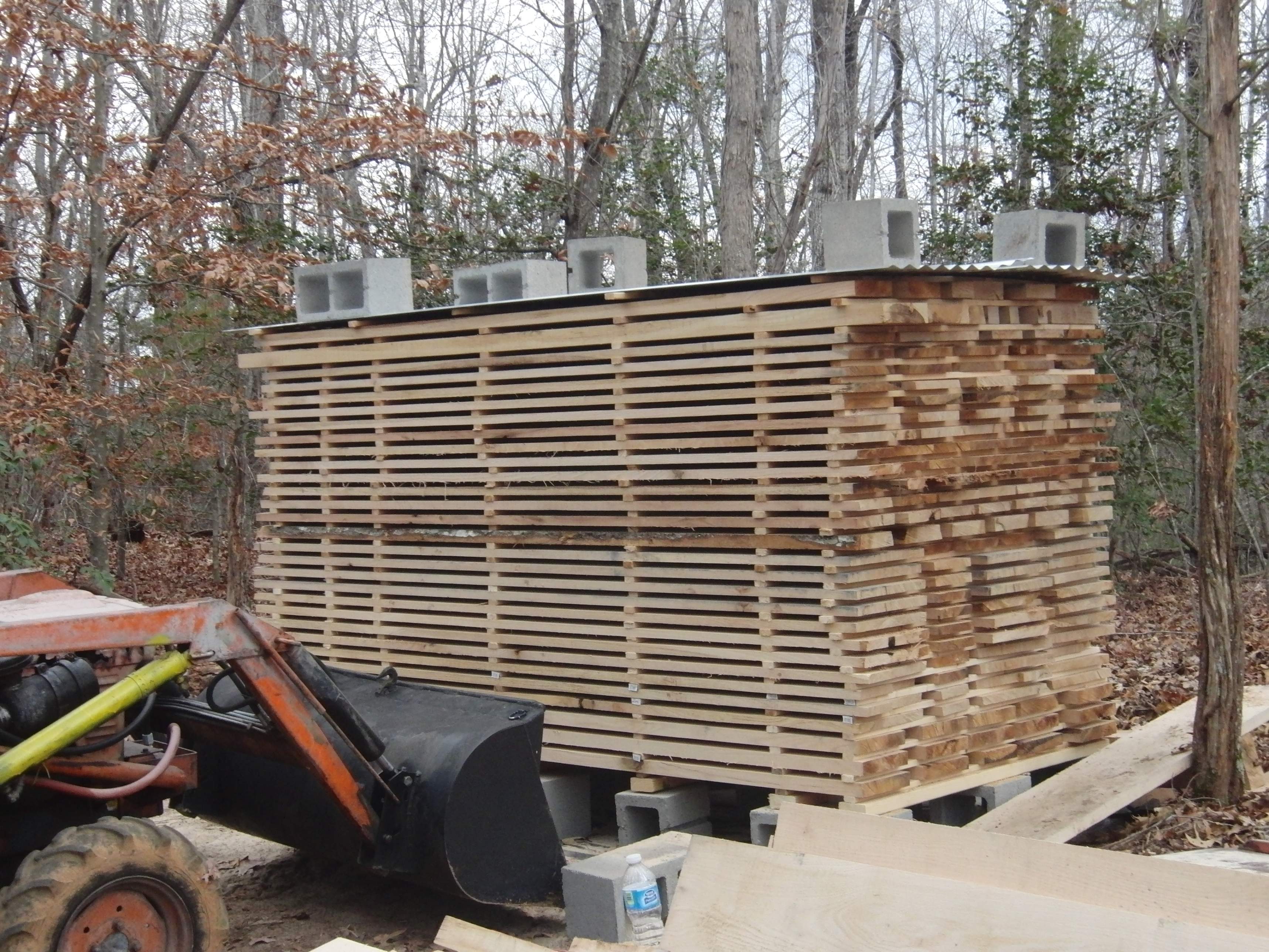

I had 1 large white oak and 1 large red oak I needed to remove for the driveway into my property in Georgia. I called a guy with a portable band saw mill. A couple of day later I had this. Approximately 800 board feet. It cost me under $300. And it only took 3 day to clean it up and stack it to dry.

JP, that is some beautiful lumber. IS it quite rough? How long until it could be laid down for flooring? We like rough cut for tables and wife wants rough cut for flooring.......but I'd prefer minimizing splinters,thank you, they're no fun.
