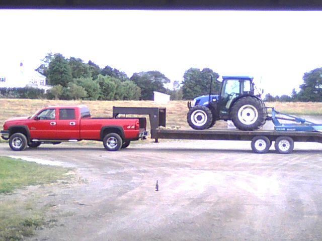

Curious, has anyone done this? Or know of anyone that has. I've never really heard of this being done on a pickup. I'm used to it on my big rig.
I have seen it done on TRUCKS tv show and it looked pretty slick, but never in real life. They had the self leveling kit on it also. I had the air bag overloads on my f150 crew cab and they were amazing. With 2500 lbs in the bed, air up the bags to 100 psi and it would sit level and ride like a cadillac. My farmer buddy would regularly haul 5000 lbs in his 3/4 ton bed but those bags were much larger than the 1/2 ton version. I think a half ton properly equipped could pull your trailer, but it isn't going to enjoy it. And those 12000 lb towing ratings are usually the regular cab 1/2 tons. Adding the crew cab reduces that. If you have to spend the money how about getting a 1/2 ton and keeping the duramax for towing?

Here you go.
I couldn't help but notice your avatar shows the tractor with a loader , so is there a chance that hauling the tractor, loader and say brush cutter or even backhoe are a possibility??
If so- throwing out the 8 k load is a possibility??? and total load on the trailer could be as high as 10,000#s +
If so can't imagine getting rid of the Duramax.... unless to buy a new 3/4 ton or larger???
He also lists a 7.5 ft snowblower. We need to take him at his word that he is carrying 8,000 lbs and isn't going to load on a few tons of gravel to spread along with everything else. He sure has room for it.

Got rid of the backhoe, But with the FEL and BH I think I'd be over the 8,000lb theory.
Chances are i will stay with what i got or go to a 3/4 ton.

I'm jumping in here kinda late. Read most of the posts. If your wanting a 1/2 ton ride and want to pull that much weight, I'd go drive a new Chevy/GMC 3/4 ton. We went to a box frame a couple of years back and the ride is amazing compared to the C channel frame we were using. The IFS and hub assembly (including rotors) are much beefier also. I think it will give you the ride quality you are after.
   / hauling a 8,000lb tractor #40
My tractor is close to 8K with the attachments and the 150 does good with it, I would not tow in the mountains with it. I only have the 5.4 in a crewcab and with that much weight it is underpowered for any large hills. The rest of the truck does good, does not sag too much and it does not feel like it is too much for the truck. No swaying or duck walking. I just upgraded my 18' 10k trailer to a 22' 14k so we will see how it tows with that. If I bought a new truck it would be the f-150 crew with either the eco-boost or the 5.0. I think the 6.2 would not be necessary unless you were towing all the time. We have been averaging 17 mpg+ with all our 5.0 in the 1/2 tons and that is winter and summer. CJ
