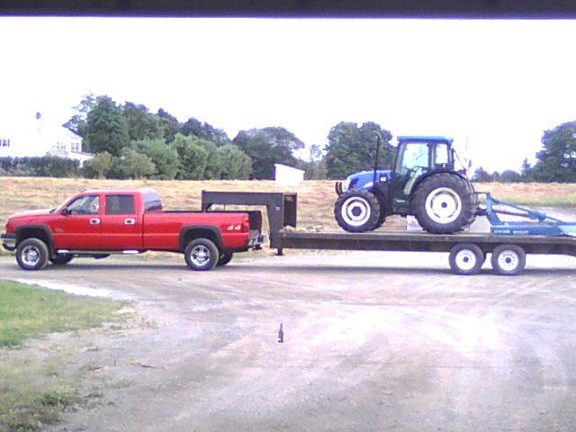

#13

C'mon guys what about some special factors
haul my 26ft GN 3 or 4 times a yr(8,000lb tractor), inside of 20 miles....
And i have very little concern for the LEO's in this set up.
If he has a CDL and no concern for LEO's what's the weight of his trailer?
I don't see any side rails. It could be a "light" trailer, say 4K lbs. I don't see a FEL, or backhoe in the pic what's the precise weight of what he's pulling?
If he only drives the entire rig less than 80 miles a year and drives it CAREFULLY and keeps his equipment light he's just pushing 12K, which is only 500 lbs over the max bumper pull "rating" for a Chevy 1500 LTZ and 700 lbs for the Ford.
I agree if his trailer weight is a lot more it increases the danger, but if his trailer is only 3,400 as Soundguy wrote
at one local trailer place.. they have 14k rated gn's in a range of 3400# to 4300#
he'd actually be within spec. And he's only driving 20 miles.
Personally I think he's off his rocker to get rid of that sweet red truck :)
