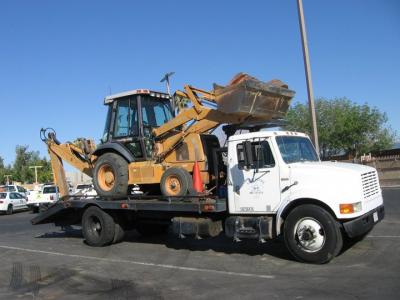

   / Hauling a backhoe on a dump truck #29
These dovetail trucks are popular in Cali for hauling backhoes and skip loaders.
I looked at one here locally for hauling my ctl and tractor, but it had a CAT3206 in it and it was pretty much worn out. The one I looked at was an ex-flatbed tow truck. The guy sold the aluminum bed and used the cash to pay a local weld shop to build a nice dovetail bed for it. If you could find a suitable truck and a cheap enough dovetail gooseneck trailer, you could use the trailer bed on the truck and sell the axles to make up some costs. Just an idea.
I assume these are popular in CA so as not to need a trailer and CDL. Probably lower cost vehicle licensing too.
It's not always so simple as paying the fees, taking the tests and getting a license. In states like WA and probably CA they will run you through the CDL wringer if you or one of your employees ever failed a drug test in the past, even if it was a a pre-employment test. Same thing with a DUI conviction in a personal automobile; even treatment for hypertension. This stuff can haunt you for 5 years or more and involve considerable expense, lawyers, training classes, re-testing, etc. I'm not implying the OP is in any of these situations but some persons who want/need to drive commercial vehicles may be, hence the need to utilize a suitable non-CDL vehicle.
