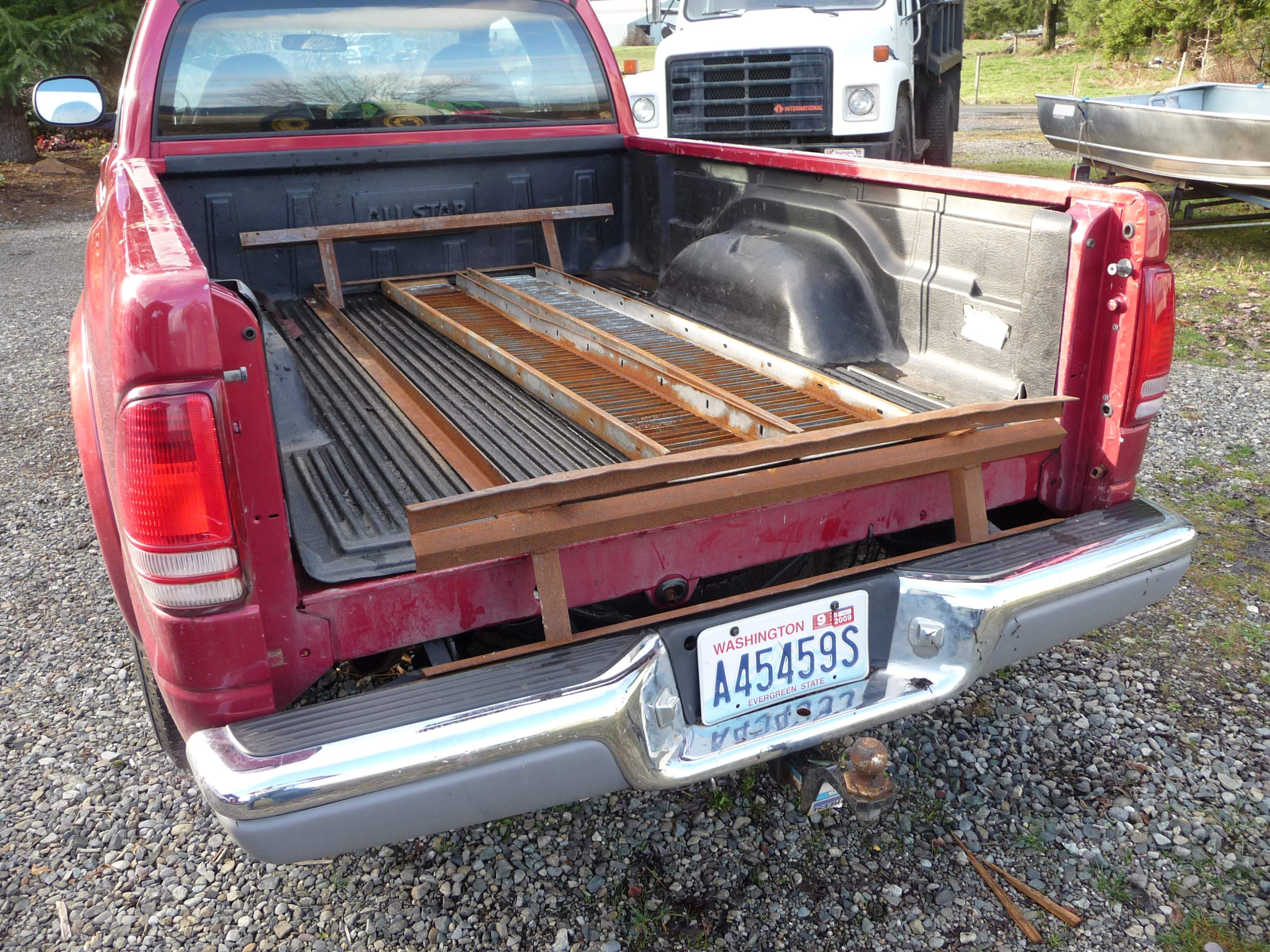

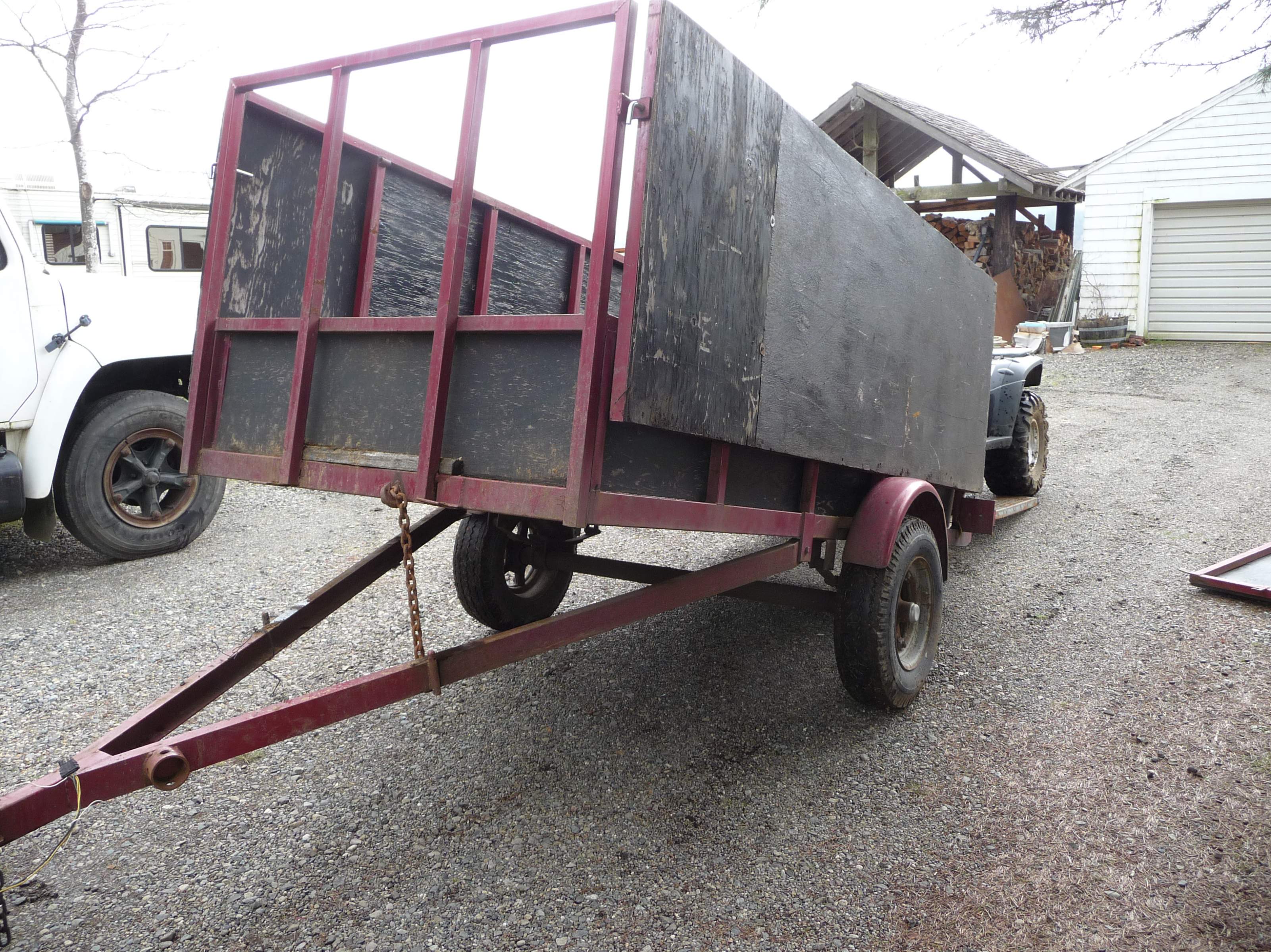

I did a trailer that is kind of an all around unit. It tilts, has sides that fold down or can come off easily. You can put the campgear in, fold the sides down to make a flatbed and put a couple of quads on top.
I built a cradle for the pickup to haul my rincon. it just slips in and locks behind the bumper, no bolts or straps. I have hauled it on 1300 mi trips no straps or chains. You would have to roll the truck to get it to come out. Here are a couple of picks. I did post this sometime back, but though you might be interested.
