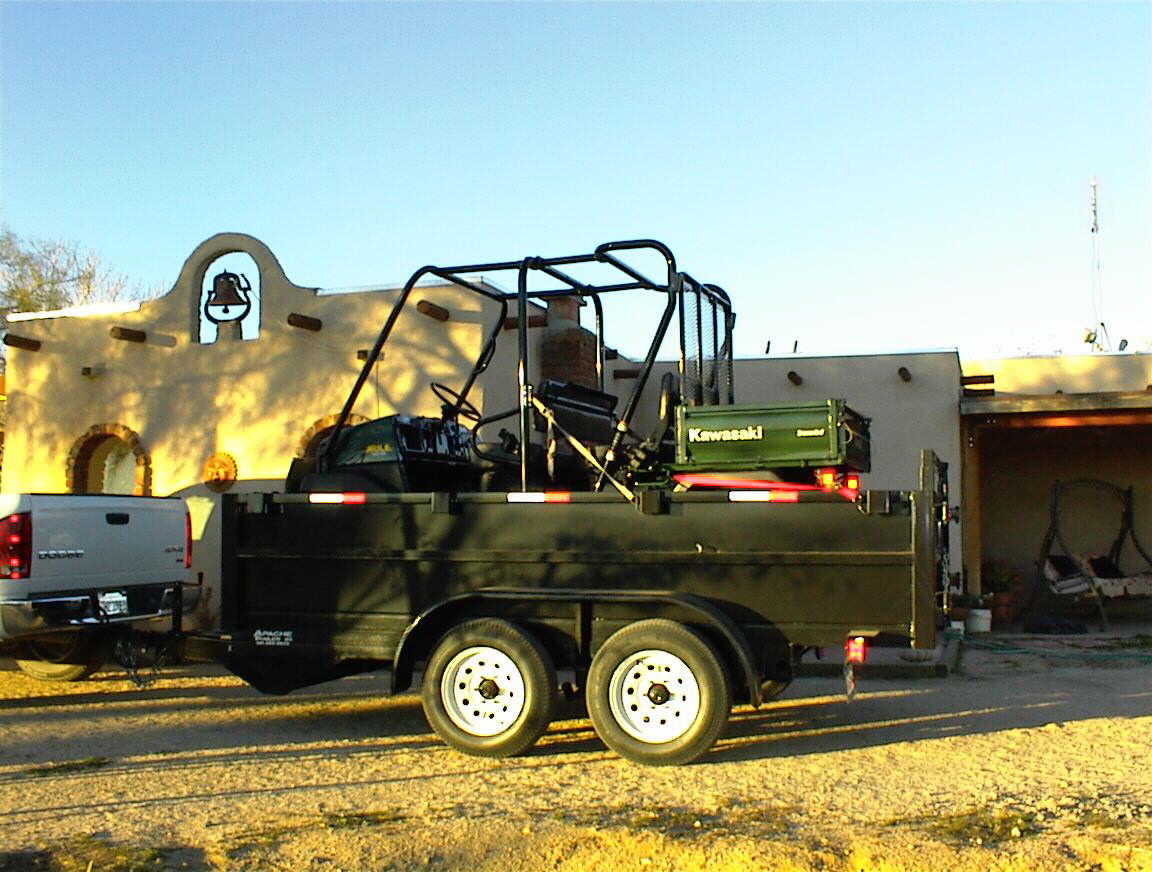

Here is my 3010 Mule in my 12 foot dump trailer. There should be a bed hold down bracket on the front somewhere.
Mike

desertmike345,
No bracket on the front of the bed to secure it to the frame. CurlyDave made mention of the neccesssity to secure the bed and it does make sense. I was hoping a tie down would do it
Here is why I was initially concerned
OK, this is probably a better perspective
Tried to line up the left side
Then the right side
How bout the front
And the back
I guess we'll see...the ramps should be here tomorrow

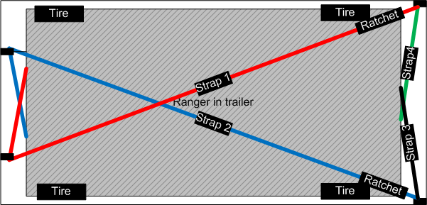

Here are my two ideas:
No modifications to trailer (grey box, uprights are the darker gray ones) (Blue lines (straps) are the preferred way to strap it down. Red lines (straps) are the secondary way to do it)

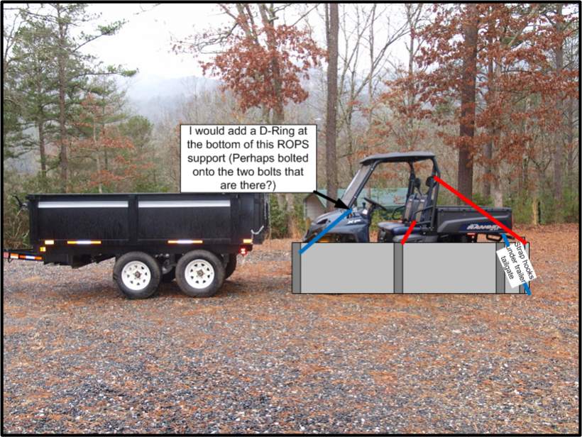

If you were to put drings in the trailer you could do this:

Hadn't even thought of adding d-rings to the unit itself...hmm. In the second image where do you suggest the straps engage the frame of the Ranger? Are you an engineer by any chance?
Thanks for the suggestions, Diamondback
   / Hauling a Polaris Ranger in a dump trailer... #17
I would hook onto:
Front: Either the brush guard or the lower A arms
Back: Either the mounting points for the rear bumper or the trailer hitch .
