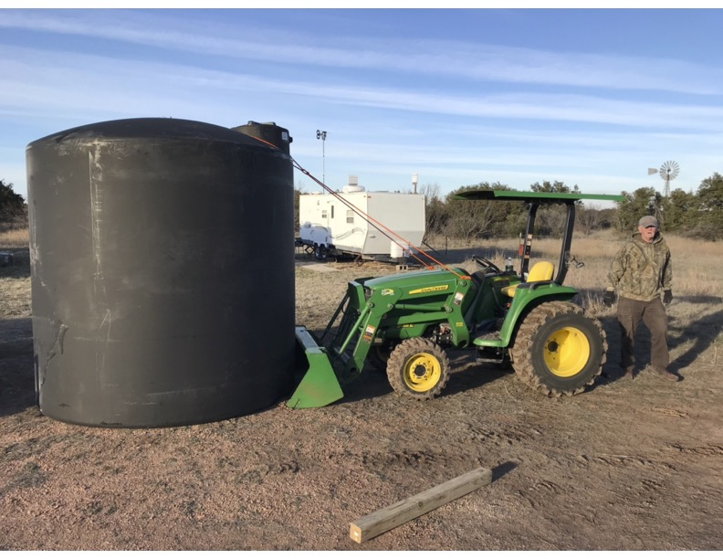

I bought two 3,000 gal poly tanks at Tractor Supply. It took 2 trips to haul them 12 miles to my property. TS driver used a forklift to load them on my 16' farm trailer, laying down. I used ratchet straps to hold it down and used 6" x 6" blocks screwed into the deck of my trailer to keep it from rolling side to side or sliding backwards off the trailer. Once at my property, my brother-in-law and I were able to stand it upright by sliding it off the back of the trailer. We then used the bucket on my tractor and rope (see pic) to move it in place. With care, I was able to put it in place and slide it the last couple of inches on the prepared pad.
I was concerned when the TS driver came out with just a forklift to load it. He actually slid it around the storage area before picking it up. I was expecting damage and told him. He said he had loaded many poly tanks that way and they are tough. Both tanks have been in place for over a year with no problems.

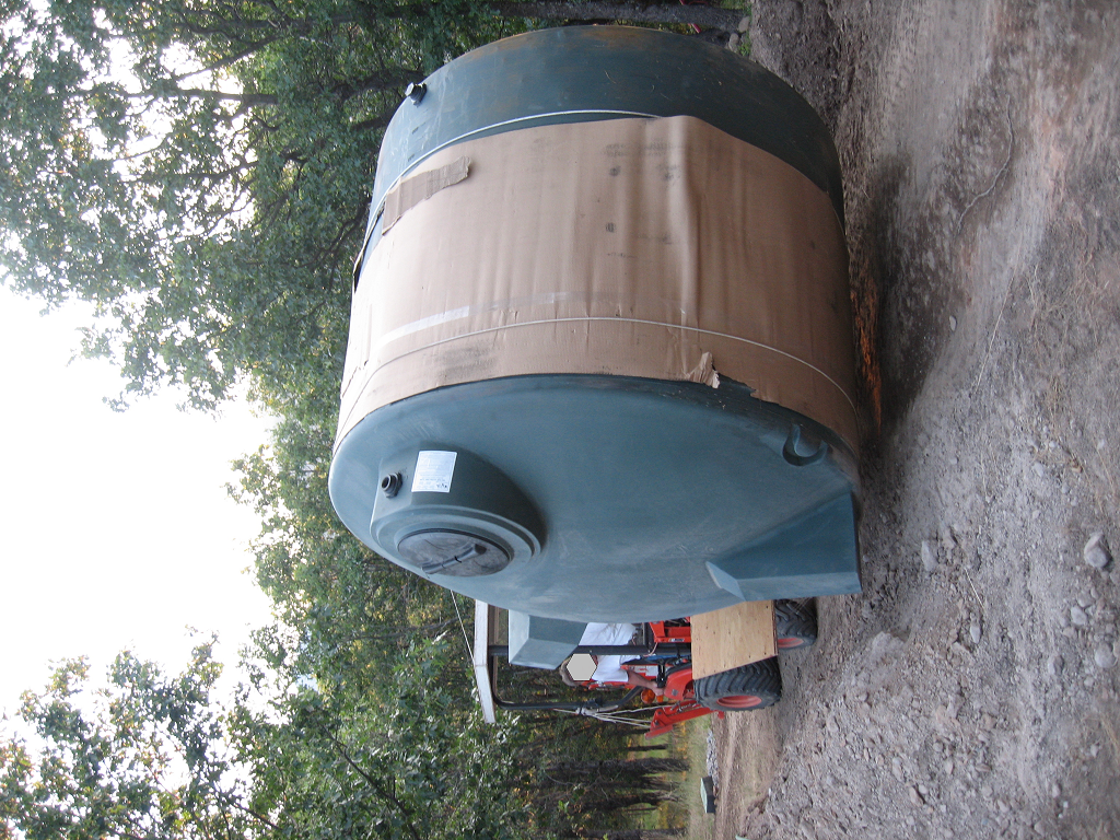

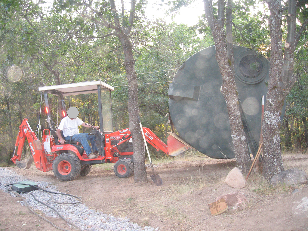

I had four 2,600 gallon tanks delivered for community firefighting support.
I cannot comment on the process of getting the tanks to your site.
As to moving them on site, a small tractor can do it with some redneck "engineering."
