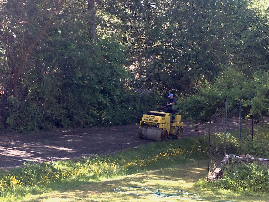

Coincidently, we maintained our 1000ft shared driveway with lots of slope just today! Here are the two rigs used. Graded, then spread two trucks of 5/8in crushed, graded it again, watered it down, and vibration-rolled. It's been two years since heavy scraping. I scrape every quarter with my little BX 72in Rankin with back blade (little too big but weight is nice). Now we are looking at applying some liquid magnesium chloride... but that is a subject for another thread.
I still say hire the major job out so it is done right then buy a smaller tractor that is economical and does a variety of modest jobs around the house/property. Add implements as you go.

Looks like you have a commercial grade operation. If I can get a 30-40 hp tractor I might try to do the repairs and if I have to call somebody else in, I am still at the same place financially. Thanks for your expertise and experience and suggestions. Made me thnk things through more thoroughly.gt
