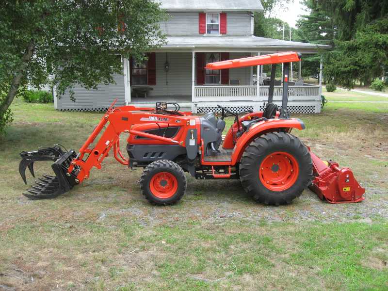

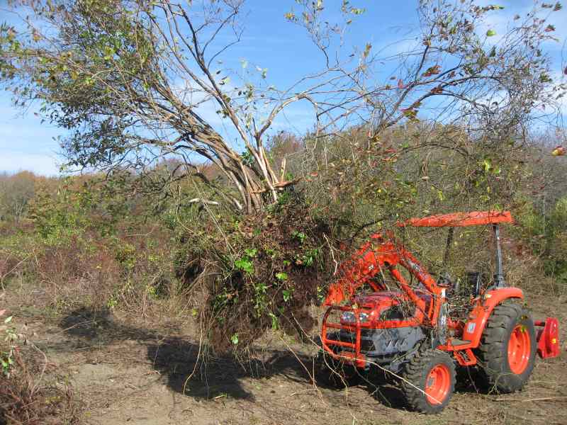

I have been doing exactly the type of work you are describing. I started with a 20 hp tractor, grapple and bush hog. It was fine for clearing and maintaining the first five acres. When the amount of land jumped to 20 acres needing to be cleared of brush like you described, it seemed like an increase in size was justified (I like seat time but not that much). In any case I doubled the size to a 40hp tractor, moved the grapple and opted for a flail mower. I really like the set up and it is very efficient at dealing with brush. Others have noted that going after 3 inch saplings with a mower is not such a great idea. If you have a strong FEL and a grapple however it is trivial to deal with them by simply knocking them down and ripping them out of the ground roots and all. That prevents regrowth and as an extra bonus you don't need to get off the tractor. The 40hp set up (Kioti DK40se, loader, Millonzi grapple and Caroni flail) would cost a bit over $21K (only the tractor and FEL financed at zero % though). It is a very effective brush killer combo and I've been very happy with it.
