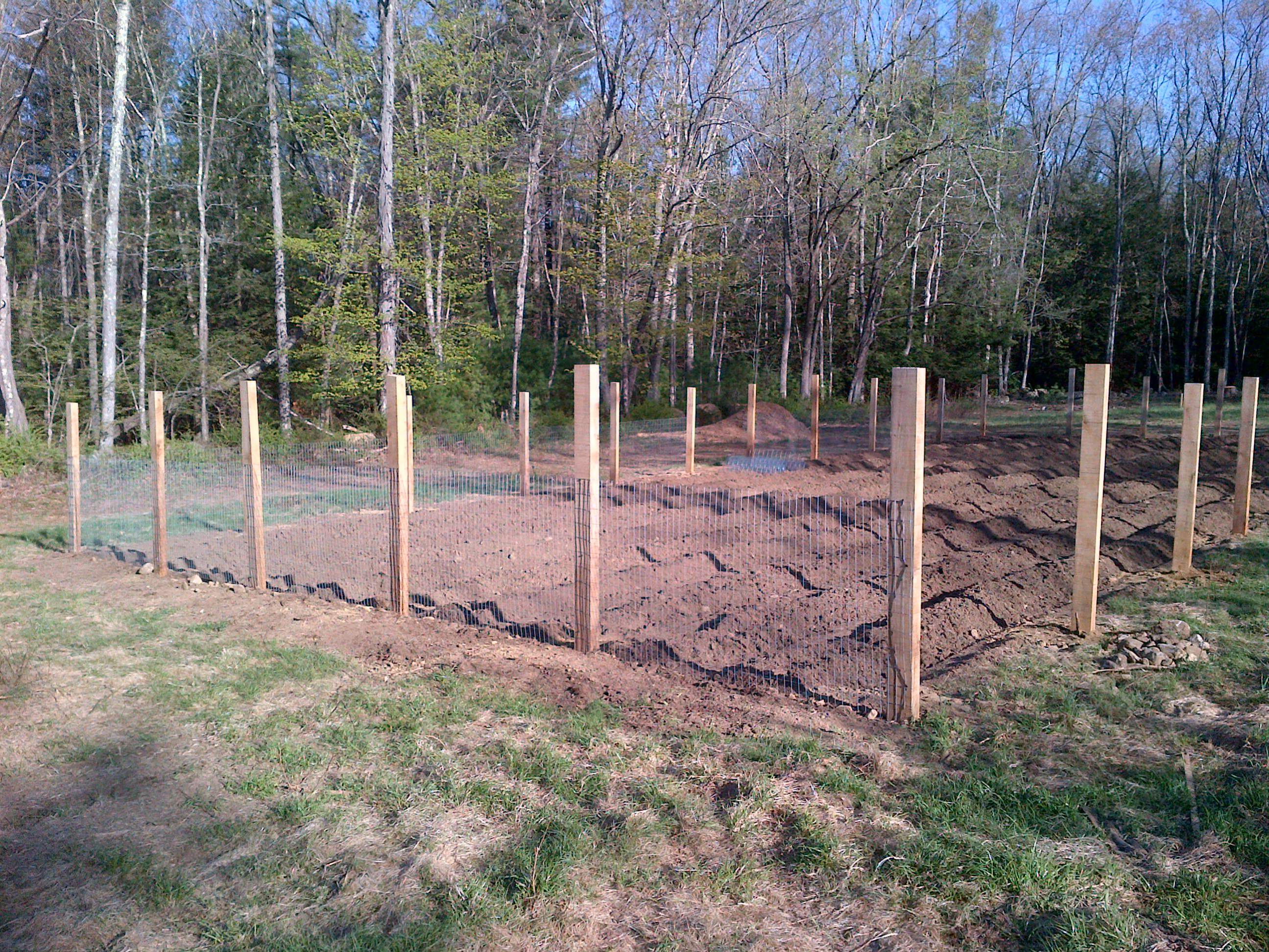

   / Have B7610 need advice on Tiller size. #14
I have a 5ft tiller on a B2910 and I can't imagine having a bigger tiller. The weight is a factor and on each additional pass while breaking new ground I can feel it cutting through the soft tillings and hitting the hard ground beliow. Tilling works a machine hard... So going slow is the best way to be kind to your equipment. I broke ground on a new garden this year, and I tilled right from field sod. I tilled 5 passes and added 15 or 20 yards of well composted manure and tilled 4 more times. So even having a bit more HP than you, I still went slow.... Also up here in New England... We have rocks!... I'll attach a pic... you can see around the edges the rock have been picked out and layed to the side.
Regards,
Chris
