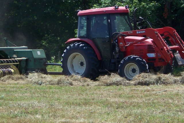

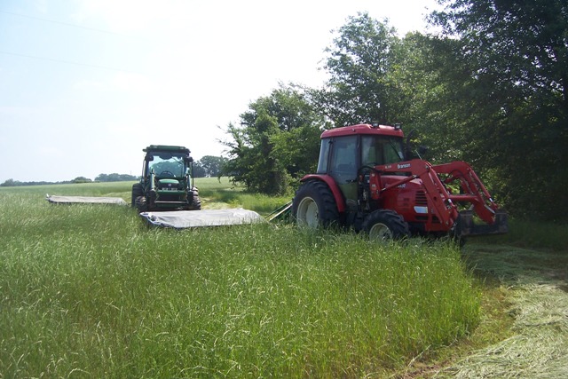

We run two tractors cutting ... Montana 4340 (43hp) with a Frontier DM 1160 ... Branson 5530 (55 hp) with a Frontier DM 1160 and we have no problems.

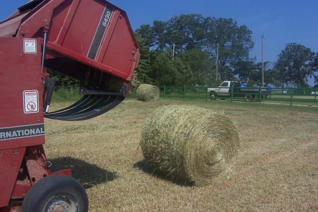

We rake with a 10 wheel v-rake and run the Case IH 8430 round baler on the 5530 ... I prefer 4x4 rounds. More bales at more money per bale.
Square bale with the 5530 and the JD 346 wire baler, accumulate with a ten bale accumulator and have a 10 bale grapple ... This year we handled right at 200 acres.
Now that is 2 of us running ... and we are looking at another lease for next year.

The Case IH 8430 is rated for 40 hp and the 8420 is rated 30 hp (per my case IH dealer)
There are also smaller balers that make smaller bales and require less hp.
The Case IH 8430 rd baler rated at 40 pto hp would be like the tail wagging the dog on a 33 pto hp tractor
