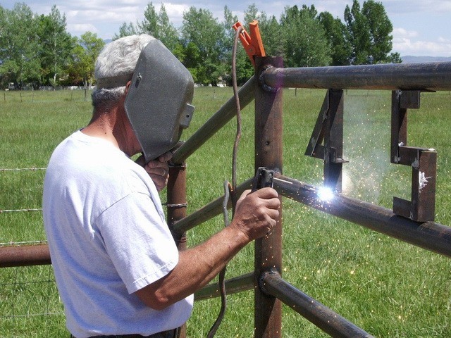

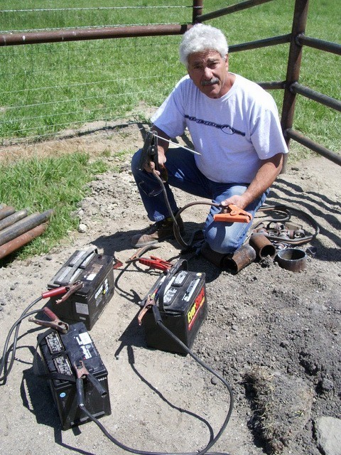

Soundguy said:
Ditto.. I'm sure there will be welds I make where DC capability will be better.. and if it is en emergency.. I can always set out 3 car batteries and jumper cable weld (grin).
soundguy
Hey 3 car batteries work fine, see attached pics, I've done it with great results. Just gotta try not to think about them exploding!

Nice gate decorations!
