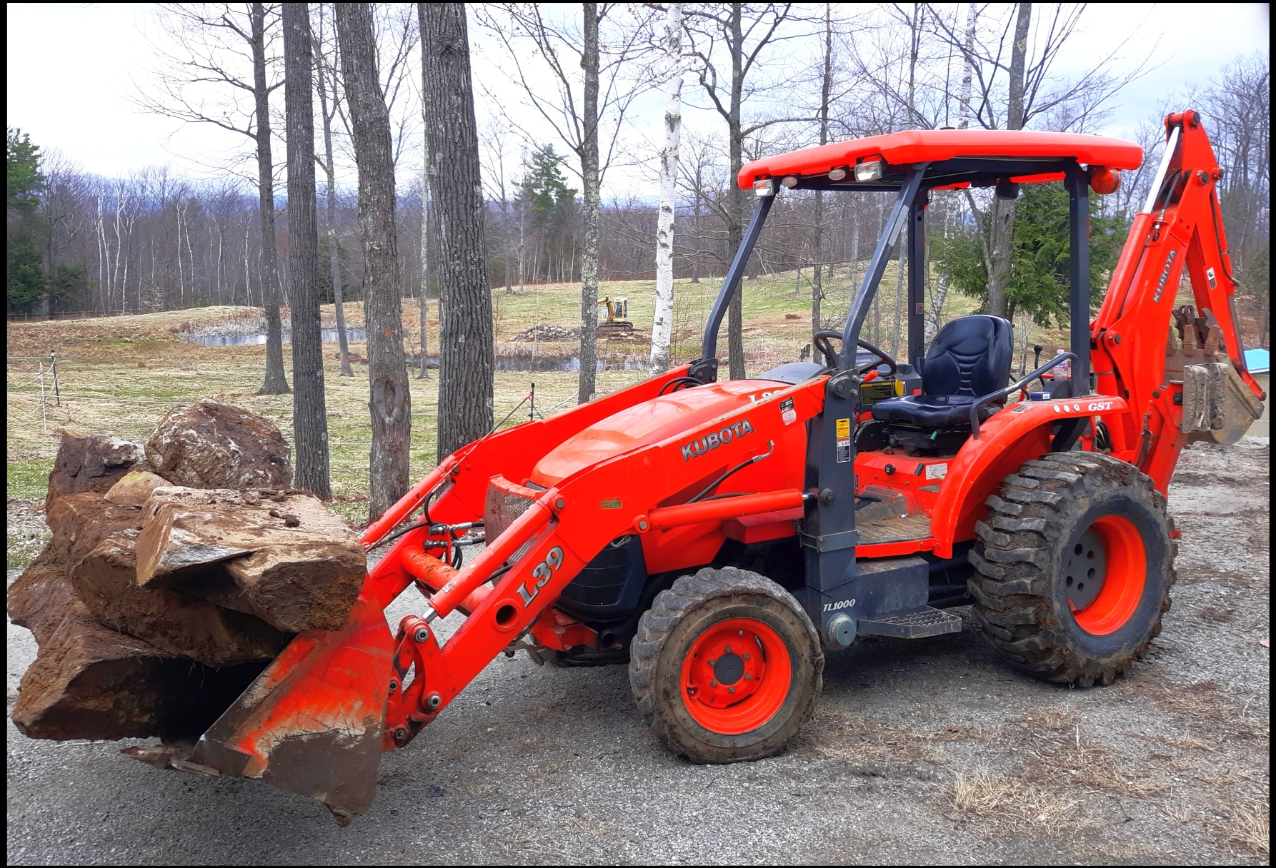

Nope, Never though of installing a shutoff valve. Would have been a good idea I guess.
Teeth also allow bucket to hold more. I upsized all 4 Lift cylinders adding just 5mm dia., just to push the machine to it's max potential. Inner and outer wheel weights and other ballast add about 1,100 lbs. Just needs about 60 hp now.

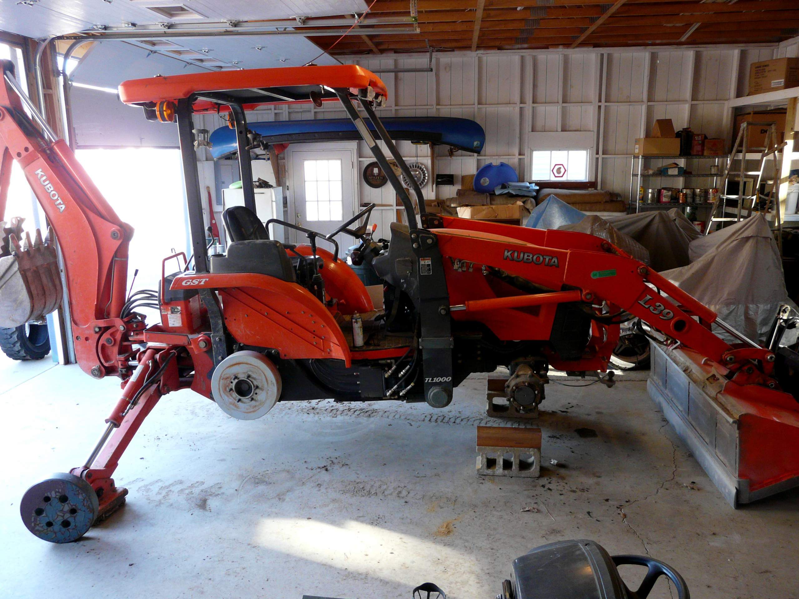

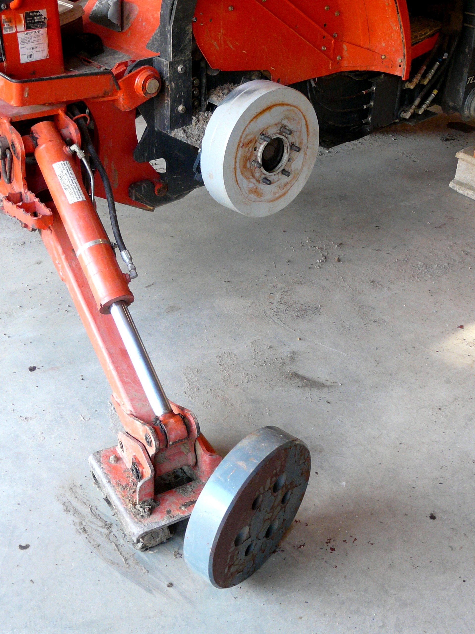

OOOOOOOOO. Wheel weights? O man I need some. Manual says to remove ballast when using as a backhoe, but to have it when using as a tractor. So I never took the time to research, but man now I want some. What is a inner wheel weight?
I cannot put anything in the tires except a good sealant due to all the thorns and some debris on what couple of job sites I have done. Did that with another unit we had and all the fluid came right out of the tire over a little nail hole.
I Would like to see a little more muscle in the backhoe.

Had rings made from durabar.
Buy Cast Iron Dura-Bar Cut to Size - Price and Order Online
One acts as spacer, while the other bolts to outside of lugs.
As my old excavator will still out dig an M62 and my L39 bucket is smaller than an M62, I spend way more time moving spoils than digging dirt.
Inner rings are from 16" diameter bar around 3.5" thick
