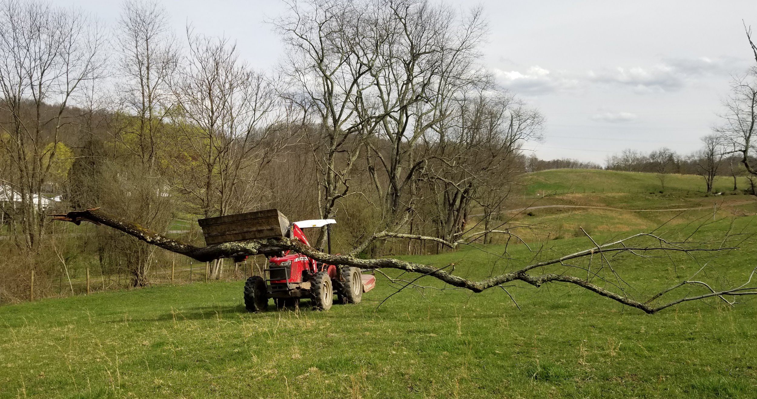

Well you are right. I never pictured carrying a large log or tree parallel to the path of the tractor.
/ Having a blast with our new M62 #370
Like this.
/ Having a blast with our new M62 #371
So now I'm confused or maybe didn't explain it well. Tell me again what happens when you pick up a 20 or 30 foot section of tree in the grapple and the path you need to drive down isnt that wide?
It sounds like you must know a grapple trick like my fore and aft backhoe trick that you use for big logs. Care to share it? How do you carry those "big assed" logs without dragging them or cutting them into sections?
No, you explained it well. I just did not visualize running with the backhoe sideways instead of aligned fore-aft. Understand now. We just have very "different rows to hoe."
My primary circumstance in moving tree limbs, logs, and misc. tree carcasses is in open fields where the burn pile or dumping place is usually over top of and across a fence, into the edge of a woods, etc. I don't happen to have work that involves moving the logs down a narrow path.
Neither do I have any very good pictures. Need to take some soon.
Here is one below carrying a limb (using a 4-in-1 pinch bucket, not the grapple but same type utilization.) Here in the East the ash borer worms have killed essentially every ash tree in the state (in several states actually.) The result is that I have more than 100 dead trees falling on fences, into meadows, etc. which seems endless. That is besides the normal other trees and limbs. In cleaning up an old farm it seems there are always trees and limbs down to be moved out of meadows in order to mow hay, moving debris from pasture fields, etc. I bought a grapple some time after this "limb holding" picture was taken and it has been so overwhelmingly handy it stays on the tractor most of the time. I run with a bush hog or flail mower on the rear all the time and do not own a backhoe. The grapple empty is pictured in the other photo below where I have just moved a large wild cherry tree and deposited it in the edge of the woods to the right where I have a log pile. Many times the log is heavy enough that I have to be selective where I grab it in order to avoid tipping the tractor left or right, especially on steeper places.
