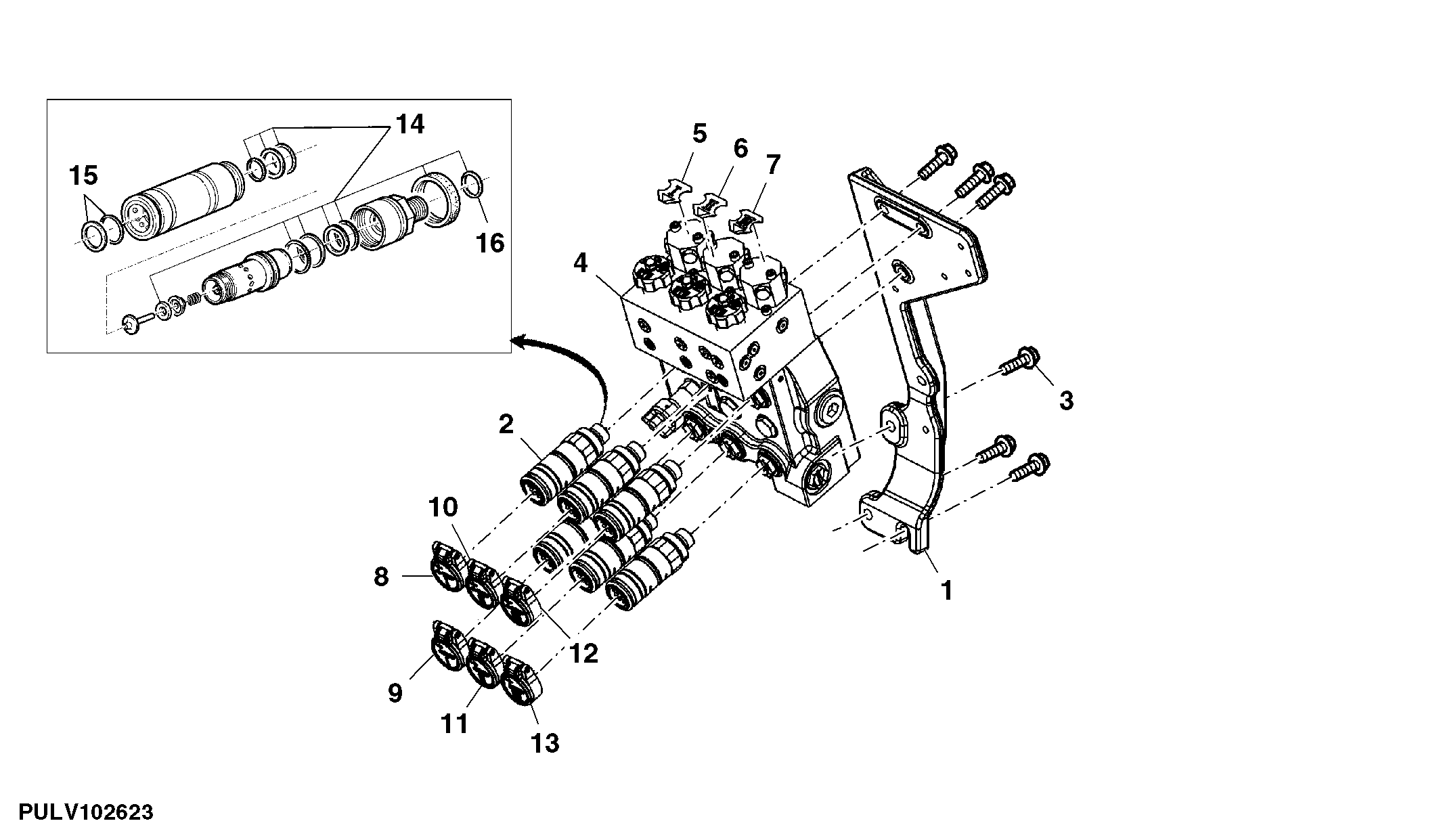

Not sure if these will work JD uses them on the deluxe couplers on their M series tractors. They snap on the outer ring of the couplers and have a spring loaded door that opens to use the coupler. Part numbers go from RE268228 to RE268233. Keys 8-13 on the drawing.
The come in three colors, Green Blue and brown; and are marked extend or retract. You might want to take one of your couplers to a JD dealer and see if they fit before buying.

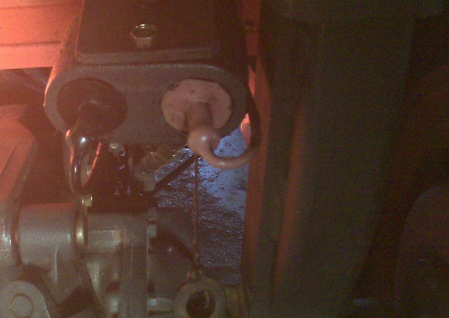

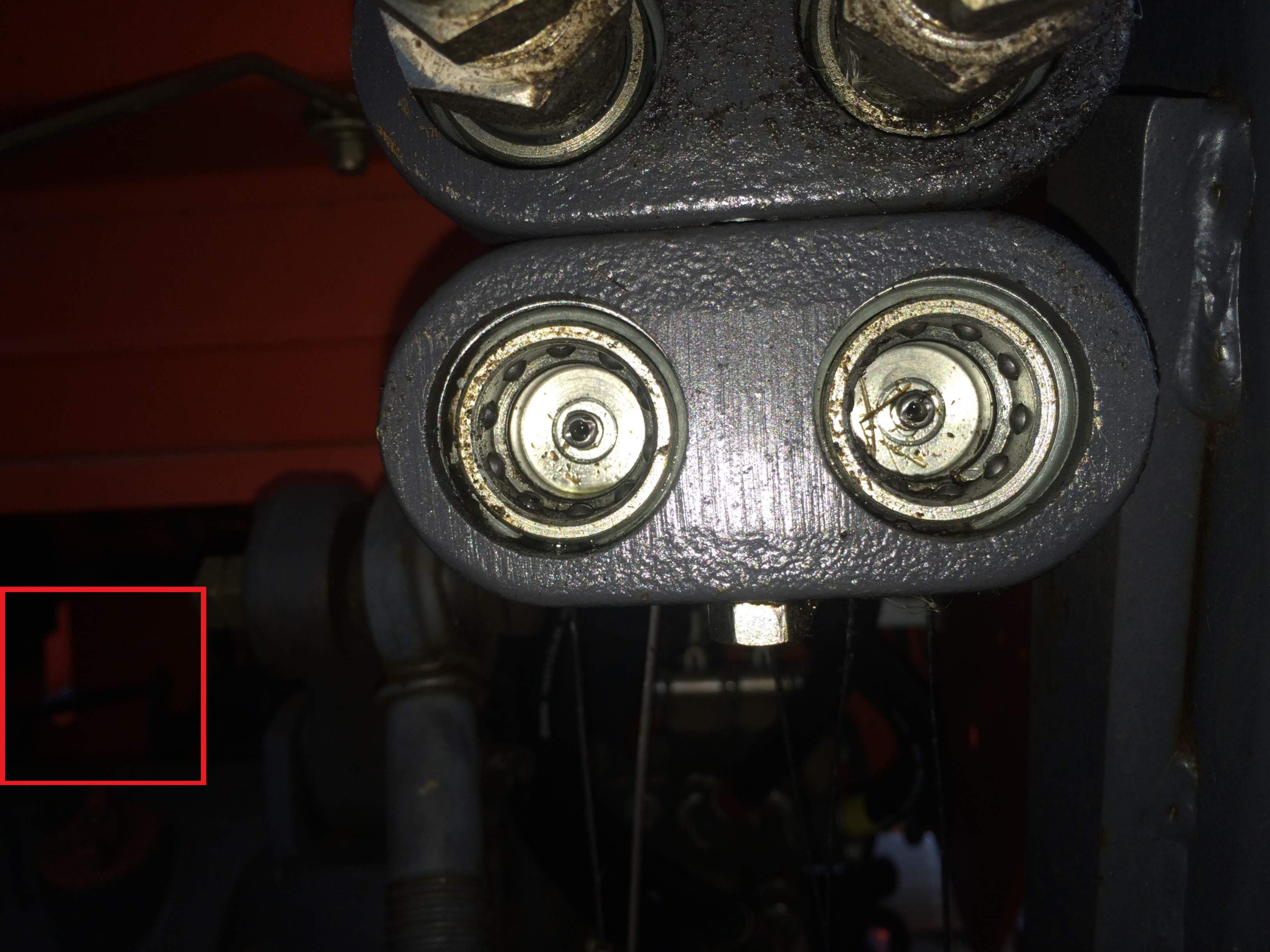

alia176: I think that your "cap for a female pneumatic coupler" is actually a cap for a 1/2" "Ag Coupler" (a different style, but the same function as the one I posted the picture of). The plug I linked to does well, but if you have a recess (like Kubota does, shown below), Deere sells a male plug version of the one you posted as a your "cap for a female pneumatic coupler" and I have used two of those on our Kubota after the OEM plugs (which are identical to the clear plug you posted a picture of) got lost. I have been very happy with them.
Kubota OEM quick connect:
Aaron Z

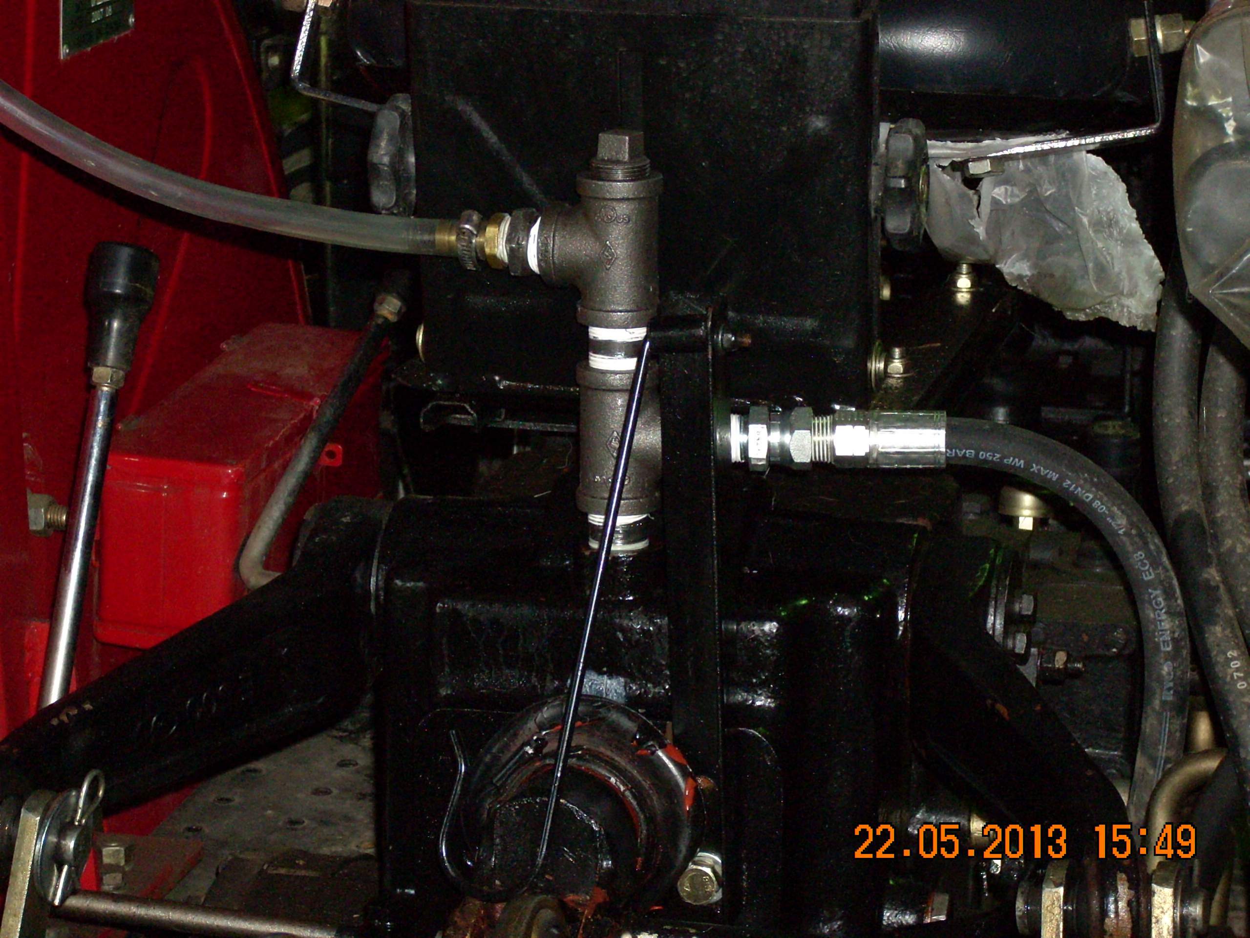

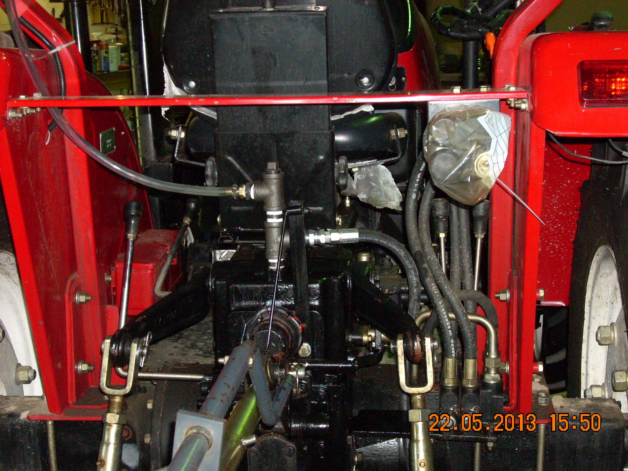

Here is what I have done and it only cost a few cents.

Here are the Deere dust plugs installed on our L3830:
I don't know the part number, but I went into the Deere dealer and they had them on one of the pegboards out on the floor...
The ones I linked to from Tractor Supply dont work in this application as the edge of the quick connect is slightly recessed and the TSC one doesnt fit in there.
The Deere ones work well as the lanyard connects to the middle and you can trim around the outside (so it fits in the recess) without making the lanyard connection weak.
Aaron Z
Jim, I hope those tees you installed are in the Tank line and not a pressure line. They are only rated for 125# pressure. Forged steel fittins rated above your operating pressure are the only safe and proper way. Also teflon tape is a no-no on hydraulic fittings. Little pieces of the Teflon get in the system and clog up the small passages. Always use Teflon paste paste and leave the first two threads dry. I learned the hard way when re-piping a gun mount on a Navy ship back in my younger days. Had to take it all apart and redo, 5 day job per mount and there were 3 of them. The boss was pi**ed.
Ron
   / Having a hard time finding dust caps for the couplers #17
Ron
Being as its going into the tank fill port above the 3 point hitch and one of the lines is held on with a hose clamp, its almost certainly a tank line.
Aaron Z
Aaron Z
Aaron, nothing surprises me with DIY projects, you see a lot of less than desirable solutions. I am not familiar with his tractor. He may be OK, but it may help some other guy not make a dangerous mistake. Hot HYD fluid spraying around can produce some painful burns.
Ron
   / Having a hard time finding dust caps for the couplers #20
That hydraulic line you are wondering about is the pressure relief valve return to the tank. Once the oil leaves the relief valve the pressure drops almost to zero in comparison - so no problem. The clear plastic line is the vent line I extended up to the canopy - out of the way.
Thanks for being observant - might help others as you say :)
