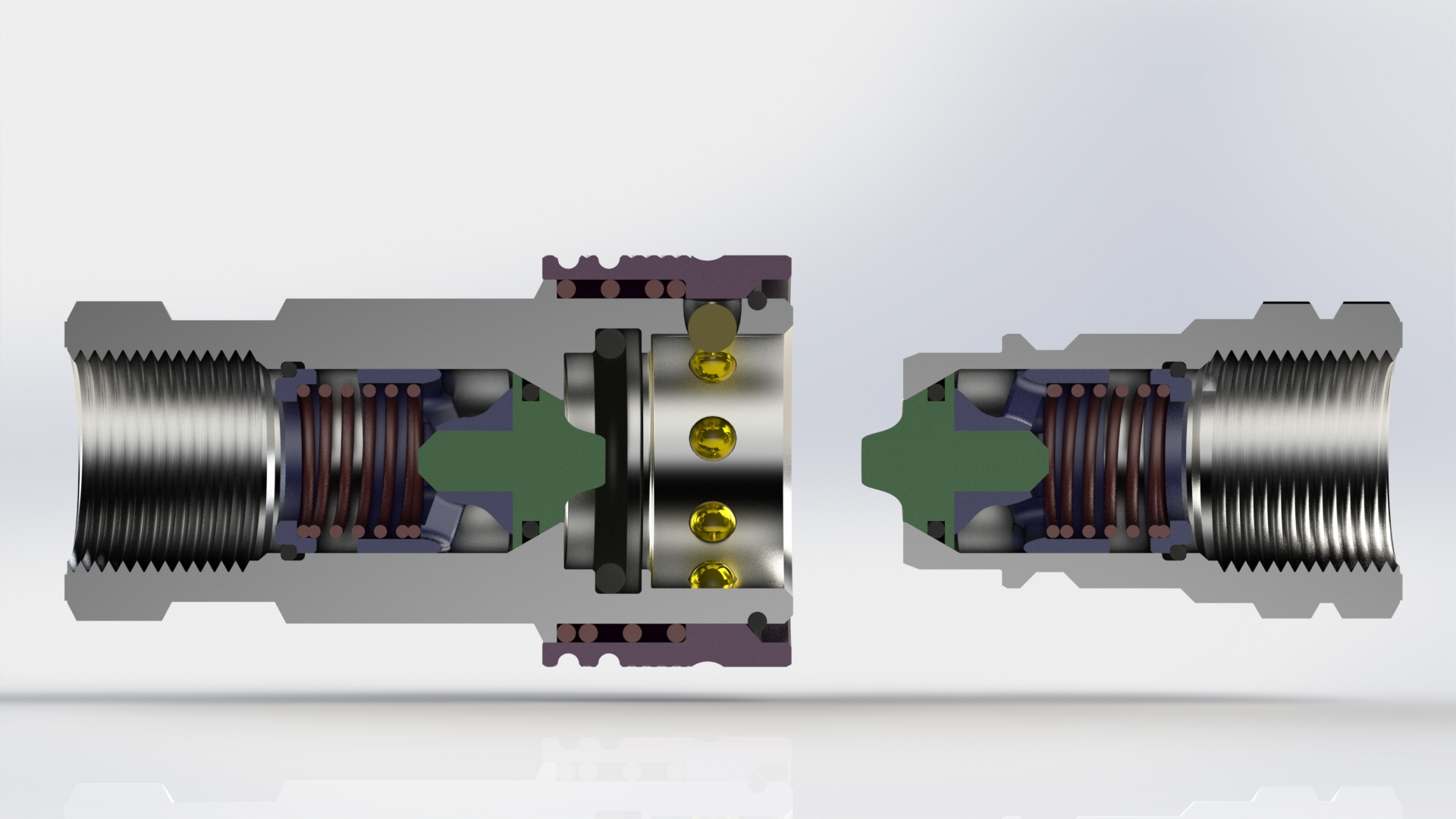

I ran across this illustration the other day and thought it was applicable to this thread. Just thought it might be of interest to someone.
I noticed that it doesn't show a backup ring next to the main oring and wonder if most couplers have one. Mine don't.
