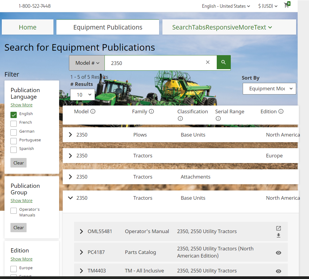

You can download a 2350 operators manual for free at Search for Equipment Publications - Technical Information Store. It appears from viewing JD 2350 parts catalog that your tractor could have either hydrostatic(with ""separate filter"") or draglink type steering. Your tractor has closed center hyd system with a trans pump that's low pressure to supply frt main pump which should have hyd stand-by pressure of 2250 psi. Frt hyd pump supplies oil to either type power steering valve.
I suggest for you to determine type of power steering that your tractor has & to check stand-by pressure of frt pump with a gauge.
