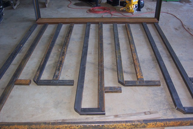

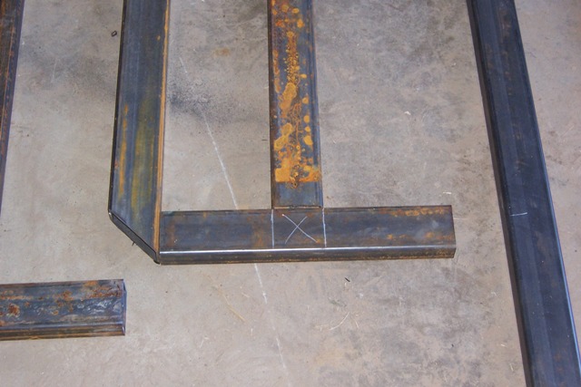

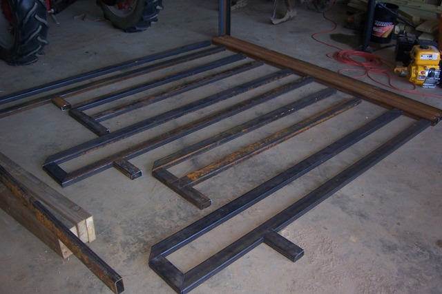

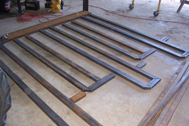

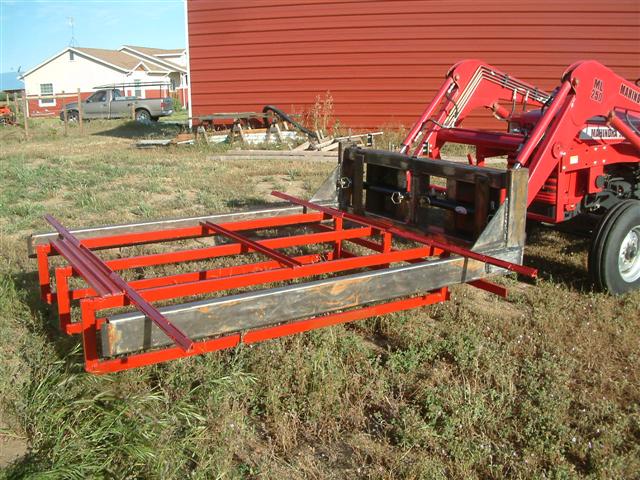

Well I got it cut and layed out ... next step on day this week will be to weld it up ...
Only had a picture and a square bale to go buy so I took my best measurements and when I'm done its (maybe) going to fit the SSQA on the front loader and accumulate ten square bales.
Looking good.

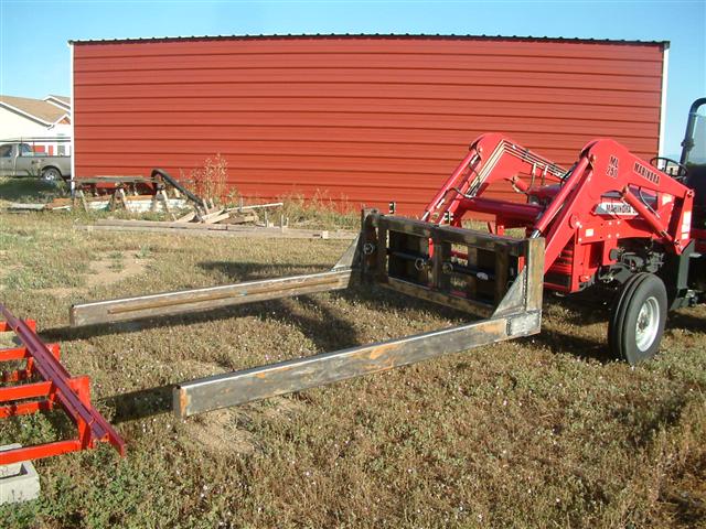

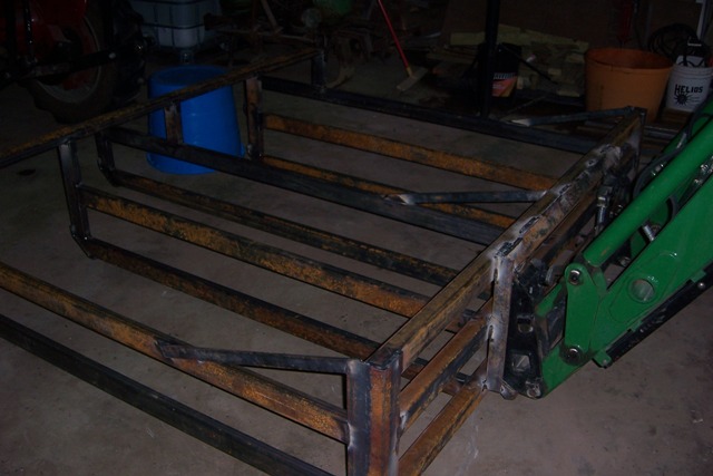

I built my own accumulator several years ago to work with my home made bale squeeze. Fun projects.
/ Hay Accumulator #5
So is your dual purpose? Accumulate and squeeze with the same?
Right. The accumulator attaches to the squeeze arms (the attach brackets were added after these photos were taken). After the bales are rounded up, the accumulator is detached and the squeeze picks up the bales and stacks them.

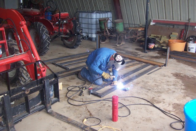

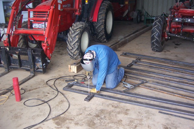

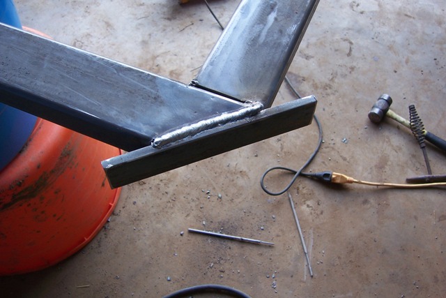

Did a little welding today ... put on piece on the wrong side of the line
(%^&#$^) had to grind that one off ... left the camera at the barn so will post pictures on the morning.

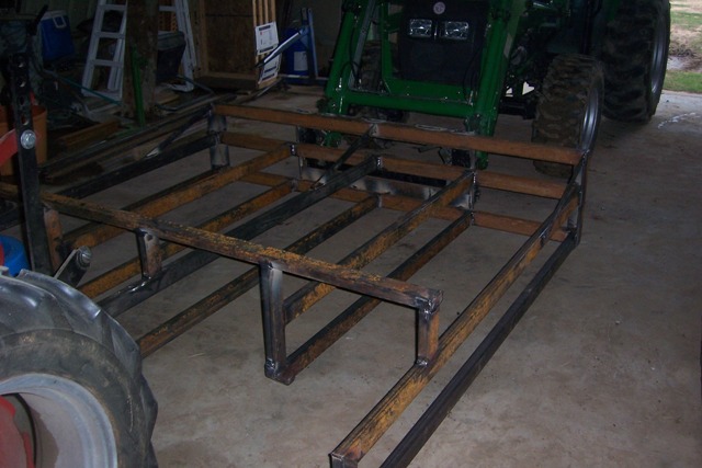

I will be using it on my 43 hp Montana ... here some pictures. I will take more, next week Thursday looks like we will get it in the field and test it ... was hoping to get it painted first !!

I am happy to report the accumulator works ... NOT as easy as the online videos !!! Take practice.

No problem pushing them on the ground. Found out load the eight first and the two ends last!!
Yes I studied the one with the grapple/accumulator combo. The down side was you can not unload with that unit ... so I went with the seperate grapple to off load in the barn and that works great.
