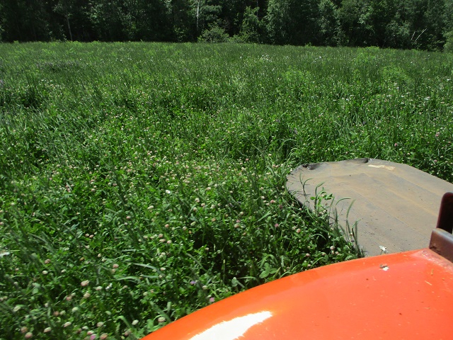

Edit: I often have to deal with rutted land so I want a level field so I can travel a reasonable speeds with equipment, to me key thing is to level with plow and harrows before seeding. Turns under old stuff to rot and gives the new seed a chance. You can plow shallow, I normally do 6" deep.

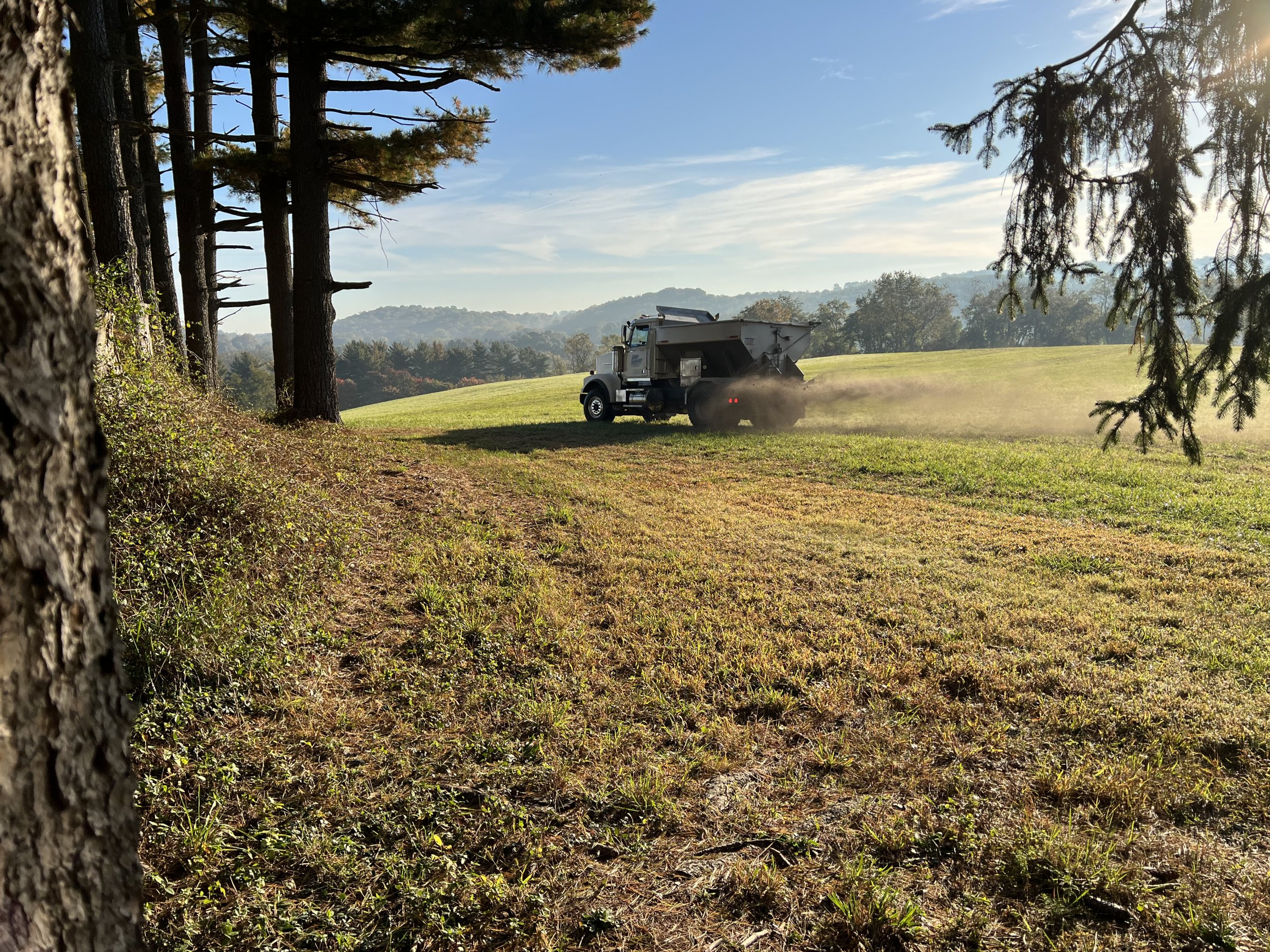

Just did 75 tons of lime today.
