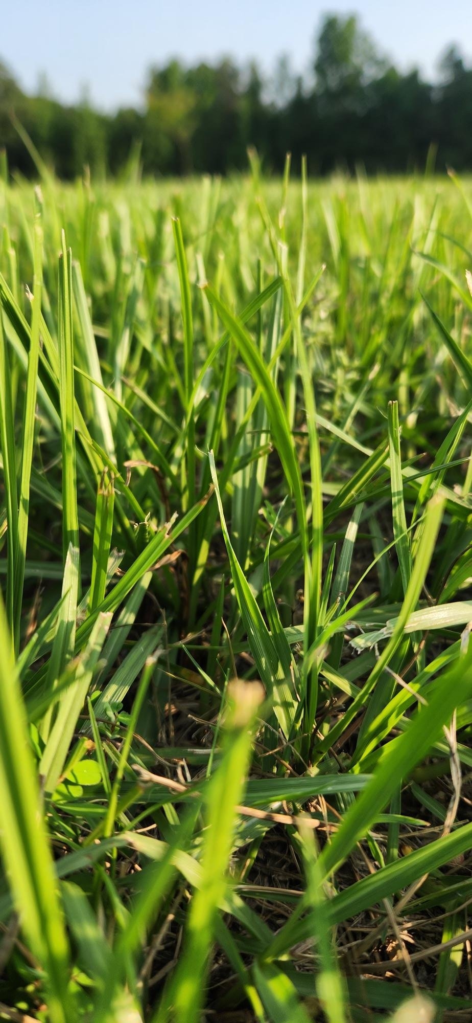

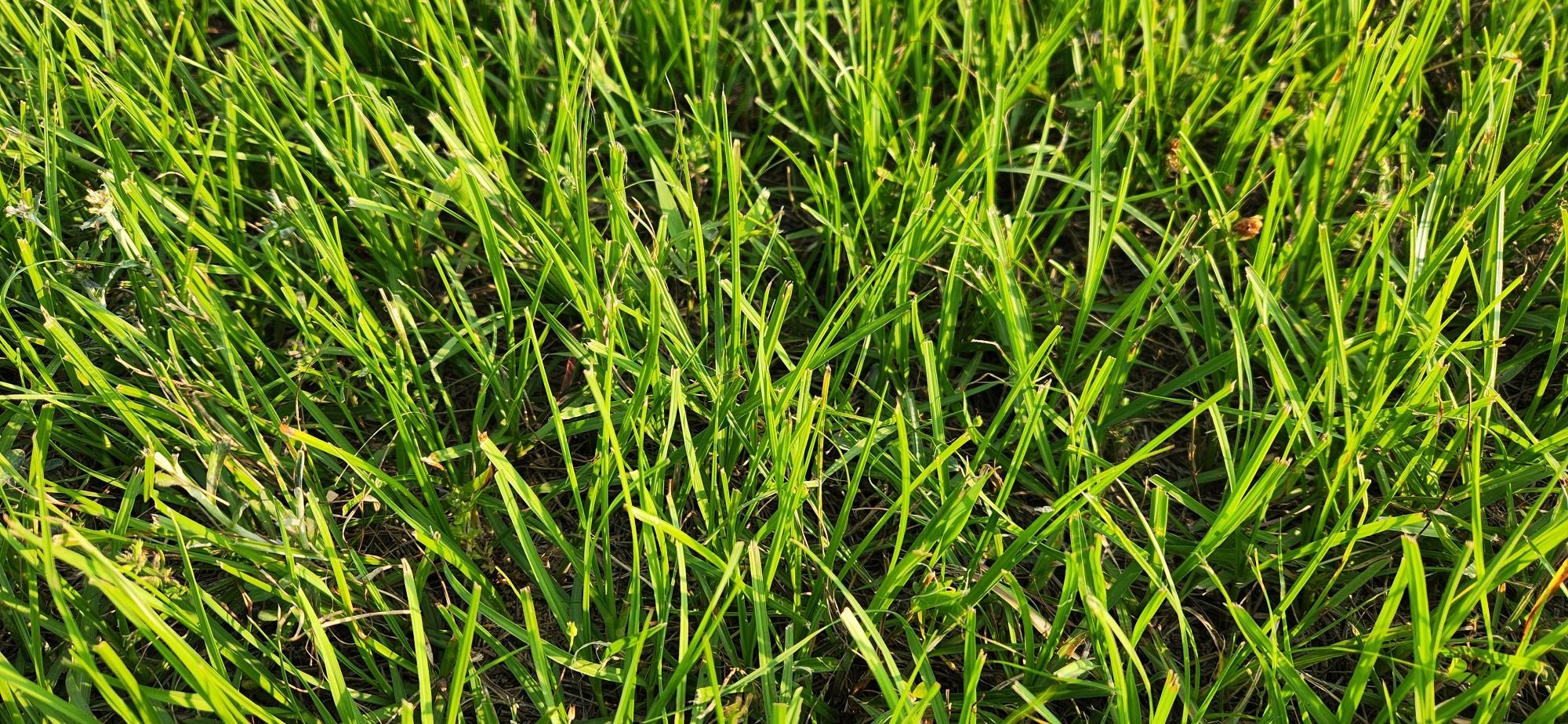

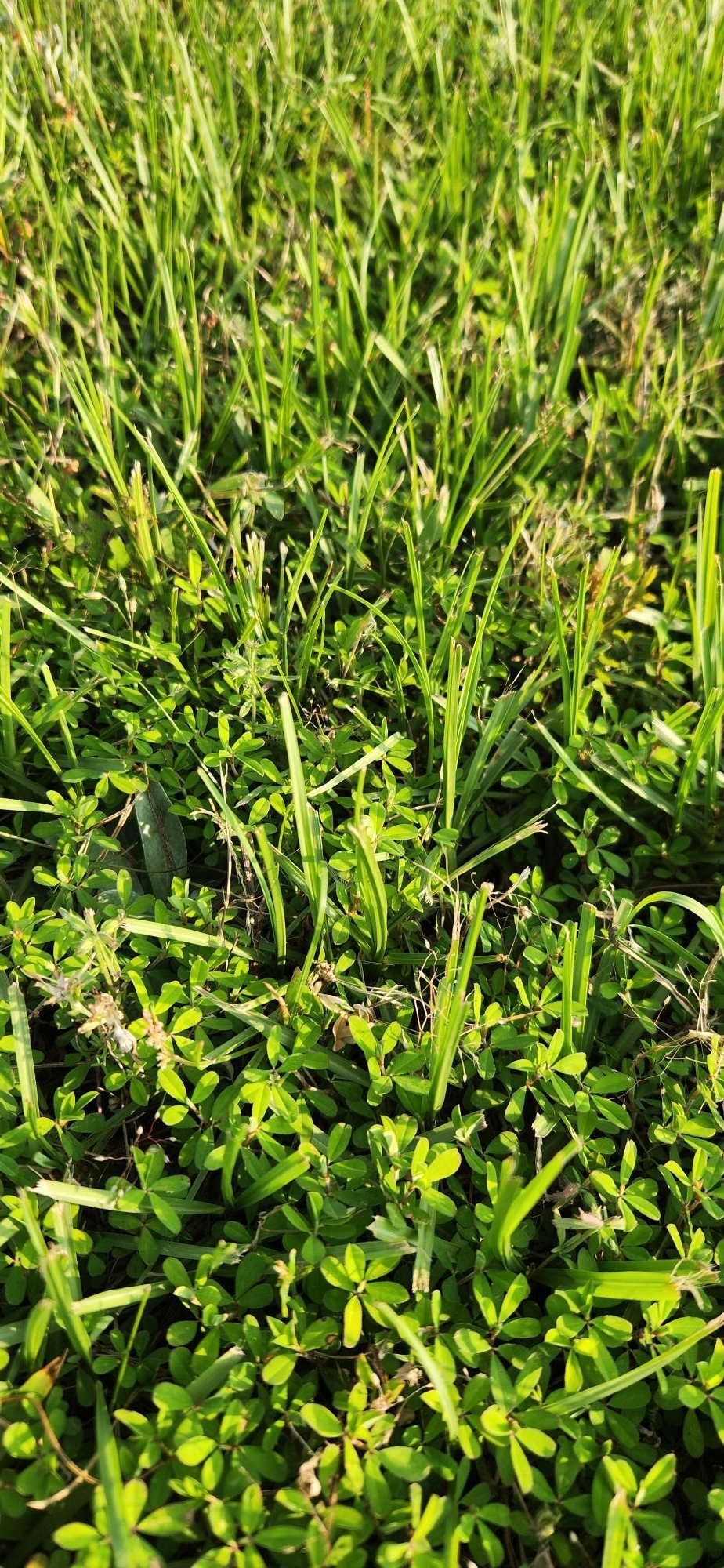

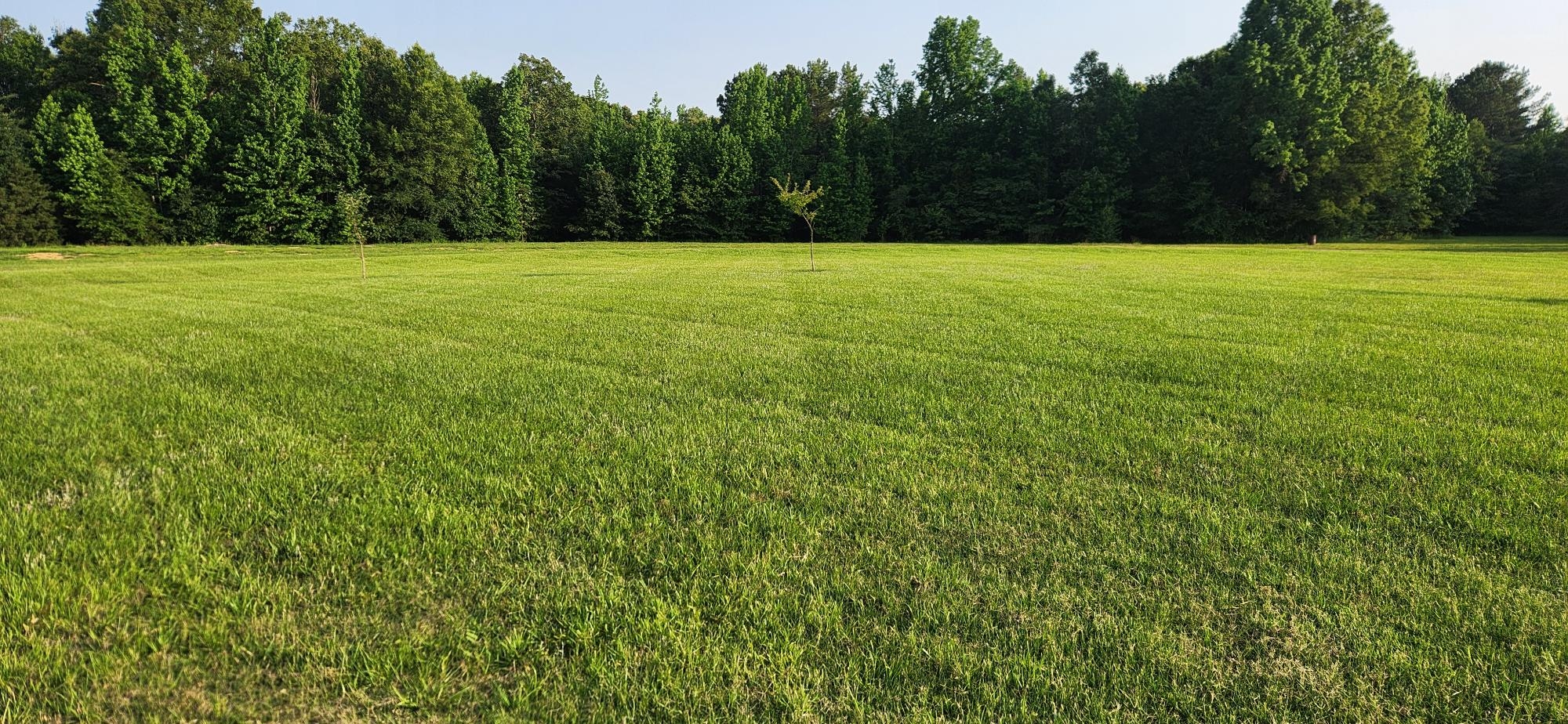

I'm getting to the point in my new home project that I want to start fixing up my lawn. But it's about 10 acres worth... I have a small area around my house where hay was fed back when there were cows on it, so there are a few stands of good Bermuda. I feel like I can get the close area around my house to convert over to that Bermuda with a couple years worth of selective herbicide and fertilizer. The larger area looks good-ish but it looks to me like it's all Nutsedge and some sort of cloverlike groundcover.
I don't really know the best way to start. I don't own any large equipment to make quick work of it. The only tillage equipment I have is a 50" tiller and I would rather not till 10 acres to prepare a seed bed. I also don't really want to spend many thousands of dollars. It's ok if it's a several year project. Since summer is just about in full swing I will probably not start until next year, unless there is something I need to do in the fall for preparation. In the far back, you can see some bare dirt. It's about an acre and a half that's up to 18" or so inches of heavy clay from my pond excavation so it's really poor soil.
My thoughts are either to use selective herbicide in increasingly larger areas for the established Bermuda to slowly expand out over several years. As well as take some plugs of it into different areas to establish more small Bermuda areas to get multiple areas spreading. Or tilling a few strips here and there and spread seed in hopes of creating several larger areas that can spread. I guess the fastest and most expensive way would be to roundup all of it and try to find a no-till drill to drill a ton of seed all at once on the whole place.
Have any of you done a project like this?

That's nice...nicely done. (y)

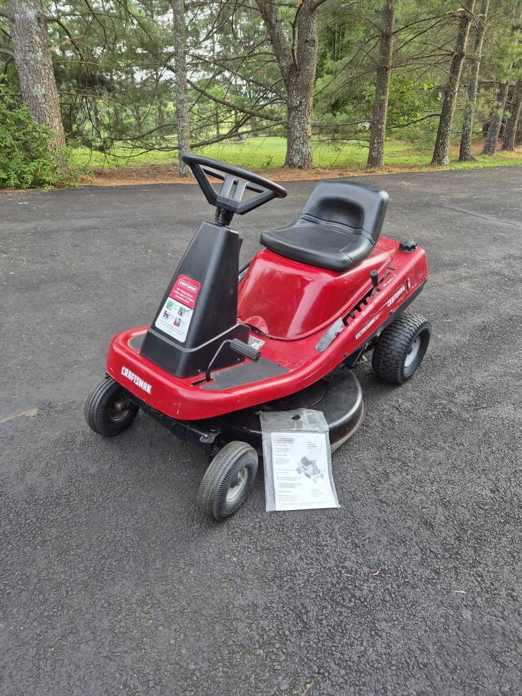

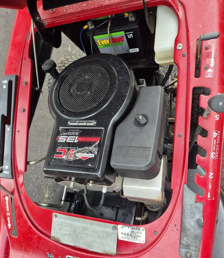

For 10 acres you need this! I bought it new 20 years ago and it's been sitting 15. New battery,belt,blade,tires,oil,carburetor,hoses,gas&air filter&pressure washed.
If you start at 8am Saturday may finish in time for Sunday church.
30 inch cut.
That's what I actually used to cut 2 acres 20 years ago & it took a while. It actually runs great & no idea what to do with it.

Take the mower deck off and use it as a go-cart around the yard or to the shed or mailbox.
/ Large lawn improvement #32
Actually that's not a bad idea! I had the mower deck off today...it's pretty easy. I'd have to change the pulley so maybe it would go faster.
