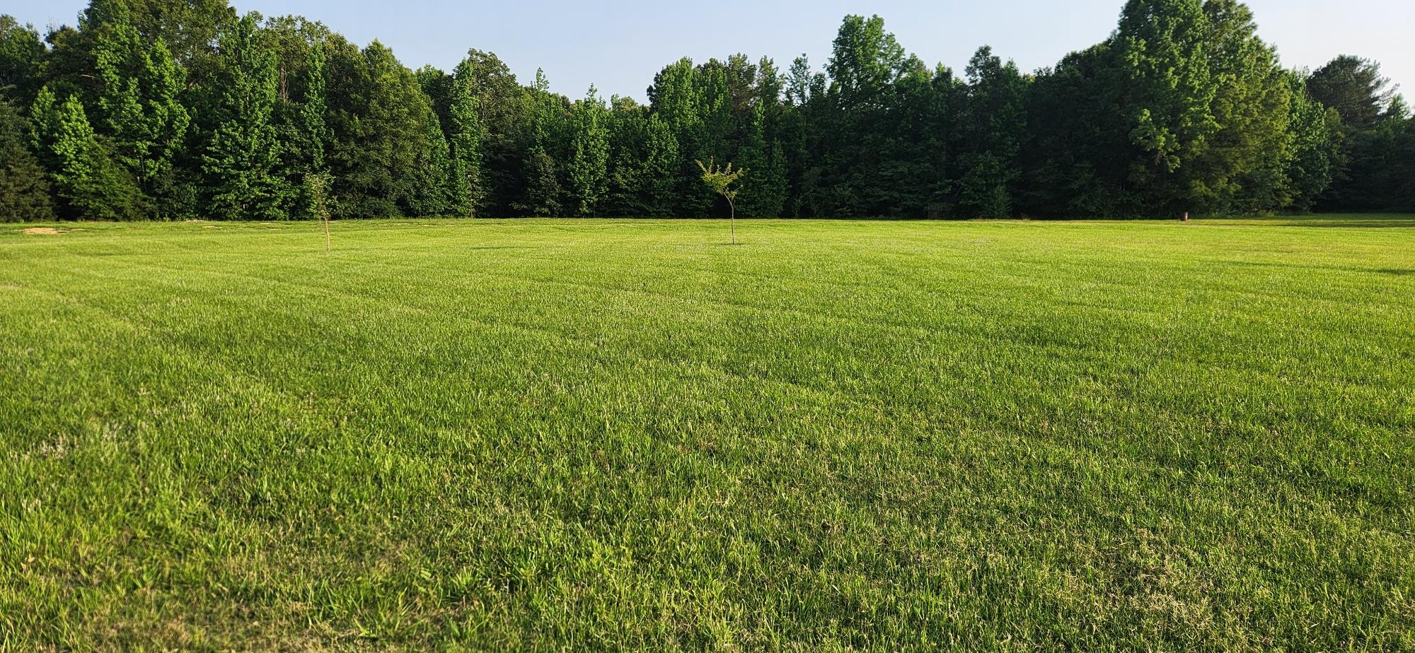

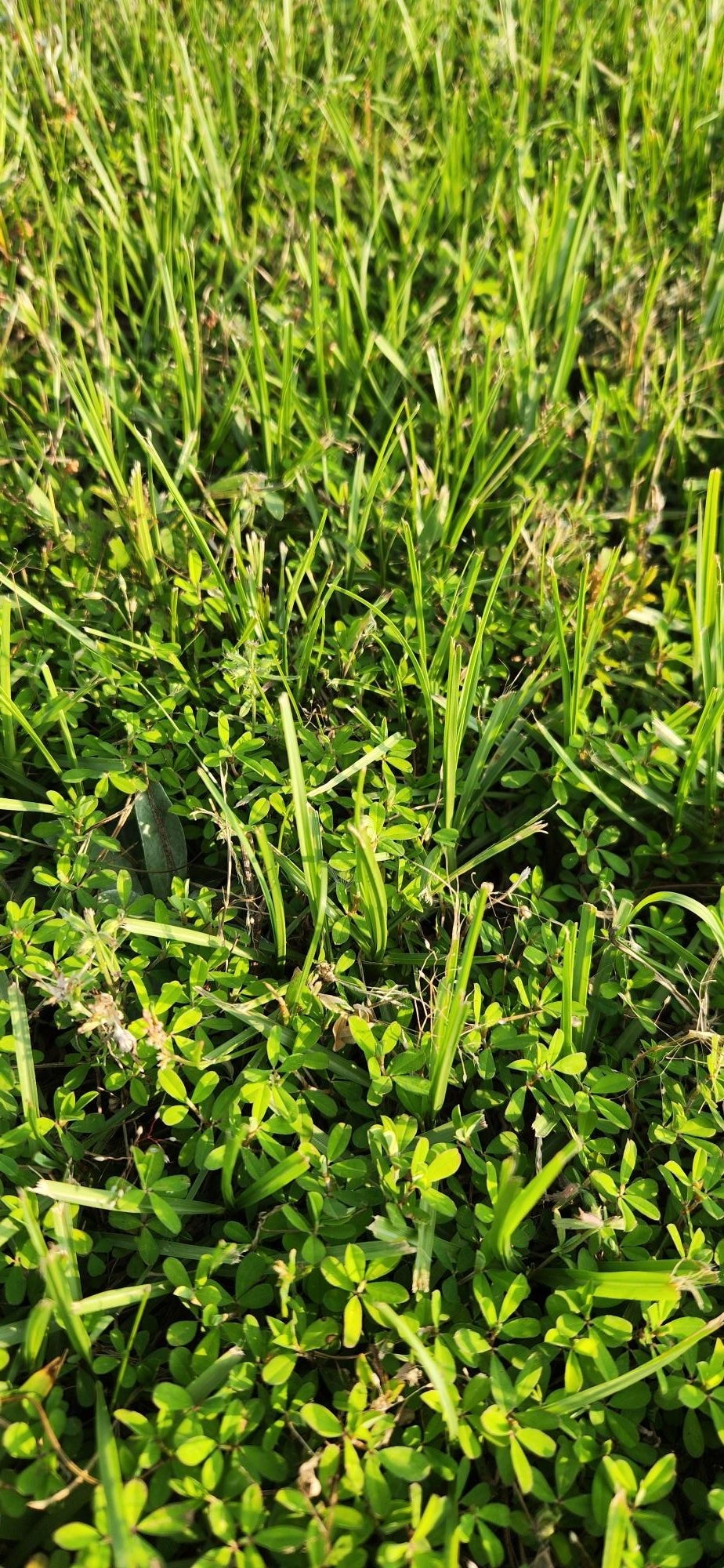

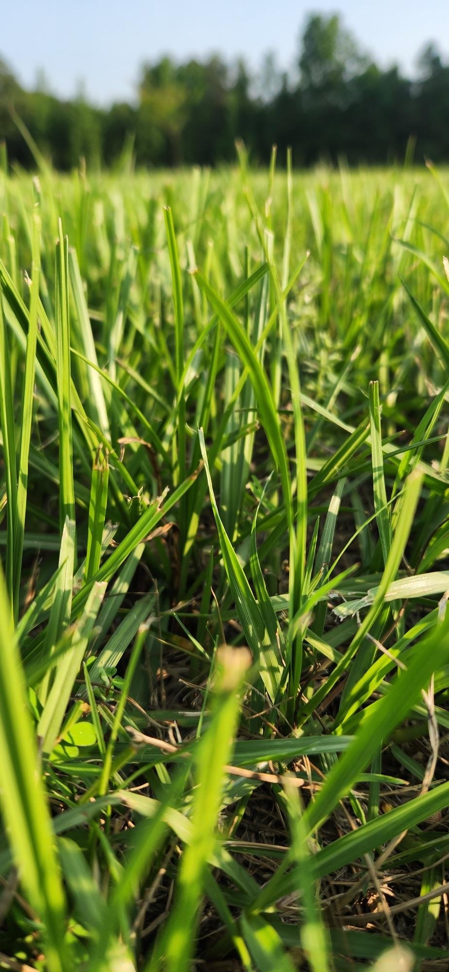

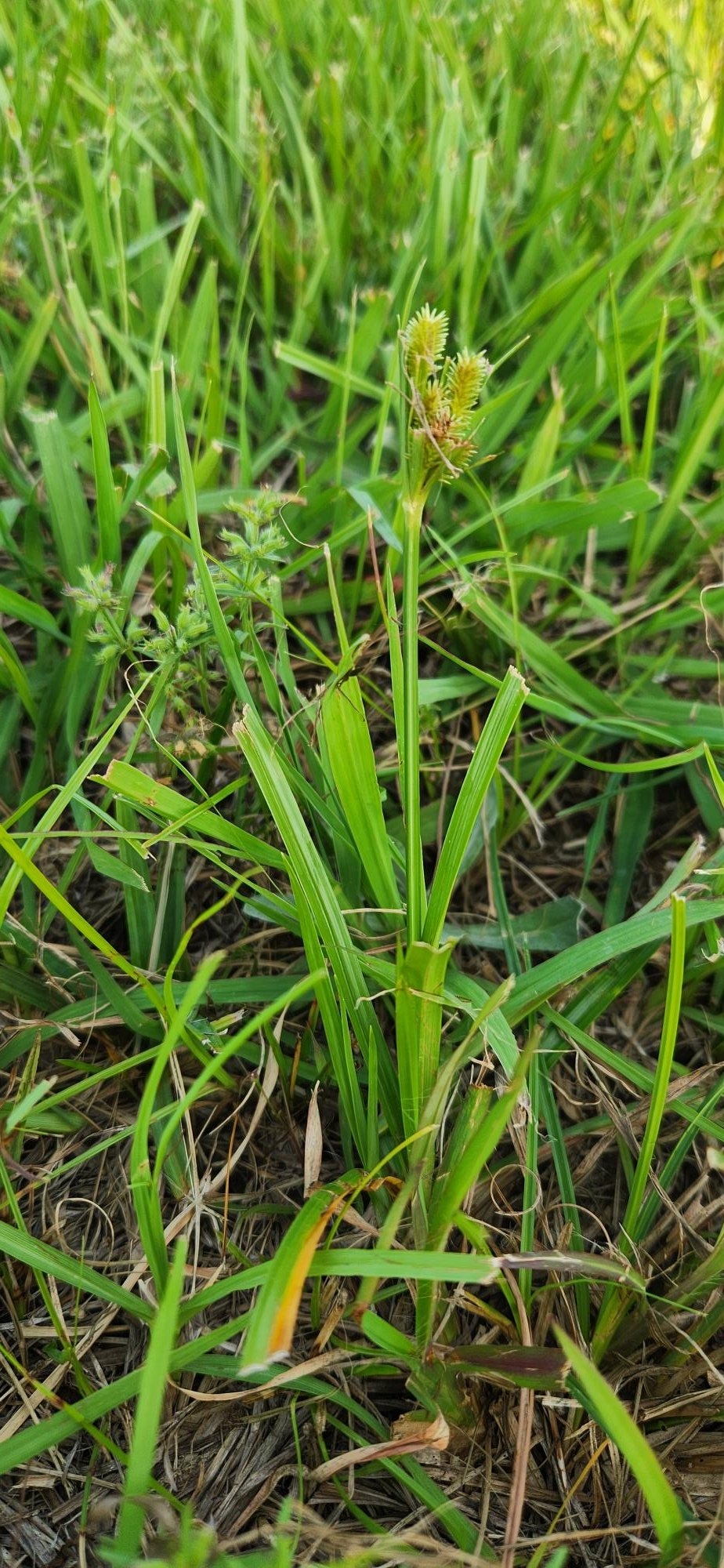

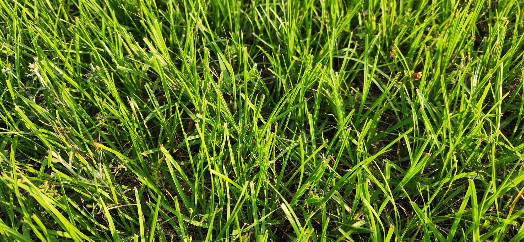

I'm getting to the point in my new home project that I want to start fixing up my lawn. But it's about 10 acres worth... I have a small area around my house where hay was fed back when there were cows on it, so there are a few stands of good Bermuda. I feel like I can get the close area around my house to convert over to that Bermuda with a couple years worth of selective herbicide and fertilizer. The larger area looks good-ish but it looks to me like it's all Nutsedge and some sort of cloverlike groundcover.
I don't really know the best way to start. I don't own any large equipment to make quick work of it. The only tillage equipment I have is a 50" tiller and I would rather not till 10 acres to prepare a seed bed. I also don't really want to spend many thousands of dollars. It's ok if it's a several year project. Since summer is just about in full swing I will probably not start until next year, unless there is something I need to do in the fall for preparation. In the far back, you can see some bare dirt. It's about an acre and a half that's up to 18" or so inches of heavy clay from my pond excavation so it's really poor soil.
My thoughts are either to use selective herbicide in increasingly larger areas for the established Bermuda to slowly expand out over several years. As well as take some plugs of it into different areas to establish more small Bermuda areas to get multiple areas spreading. Or tilling a few strips here and there and spread seed in hopes of creating several larger areas that can spread. I guess the fastest and most expensive way would be to roundup all of it and try to find a no-till drill to drill a ton of seed all at once on the whole place.
Have any of you done a project like this?

10 acres is a lot to do anything with without spending a fair amount of money. It sounds like the grade or smoothness of the lawn is satisfactory to you or you would be working it up and starting from scratch which adds up in a hurry grass seed alone would be pricey.
I would start out with some soil samples to local ag office they don't cost much and they will advise what fertilizer and lime to get your soil in shape to grow turf. Some of the weeds will disappear just by getting the soil acidity in the right range. A herbicide applied in the fall will help get rid of the rest of the weeds, if it is ground ivy aka creeping charlie you may need a second application about 10 days after the first. I recently used a herbicide containing Dicamba I got at Fleet Farm with good results also some 24d will take care of a lot of the broadleaf weeds.
Mowing your grass taller will give you way better results, my mower setting is 4 inches, keep your blades sharp, I fertilize twice a year usually and leave the mower clippings on the lawn. A thick lawn helps choke out the weeds and taller helps shade the roots so the lawn stays healthier. Some people use a slit seeder to go over the lawn to plant seeds without working it up, you may have a place to rent one around you. It will take a little time but if you start with the little things and see what is working best and go from there you will get to where you want to be. There will always be some areas you would like to be better especially with 10 acres. The clay soil area will probably take quite a while to look decent unless you add some topsoil or good organic materiel and mix it with the clay. You may want to consider doing a few acres around the house and just mowing the rest taller, 6 inches or more,about once a month until you get good at converting the 2 acres. Good luck.
/ Large lawn improvement #5
That's a pretty decent lawn now other than a few weeds!
I'm with Jimmy Joe - Dicamba to get rid of the weeds, then let it grow long - cut at 5" or so will shade and retain the moisture better too.
Then selectively slit seed in the fall as needed, and till some sand or topsoil in the bare areas and seed at the same time.
