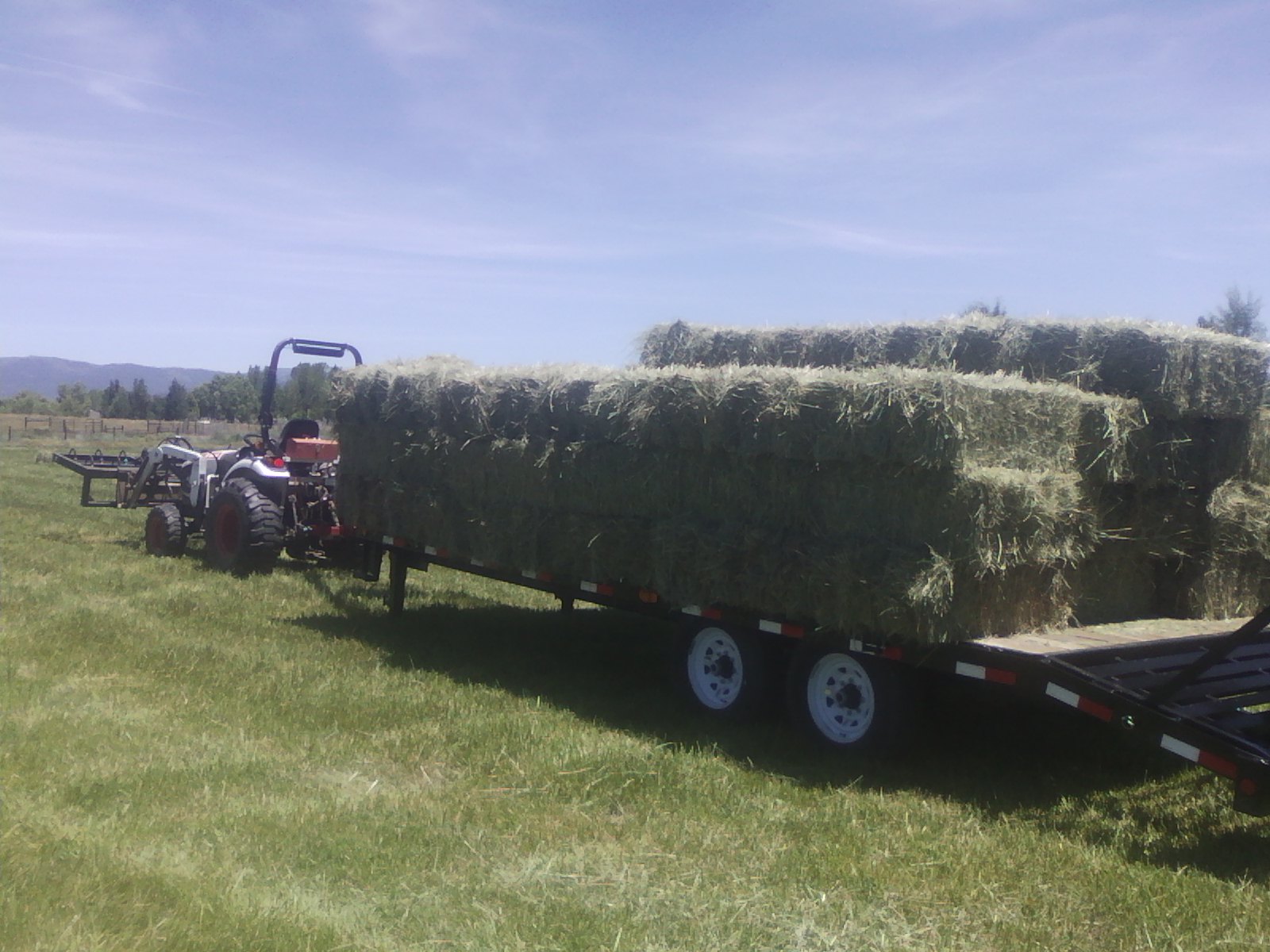

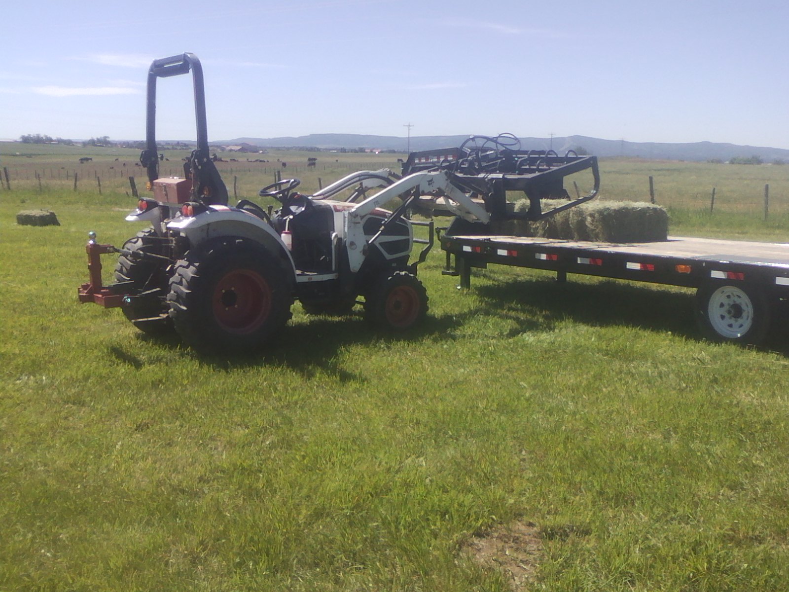

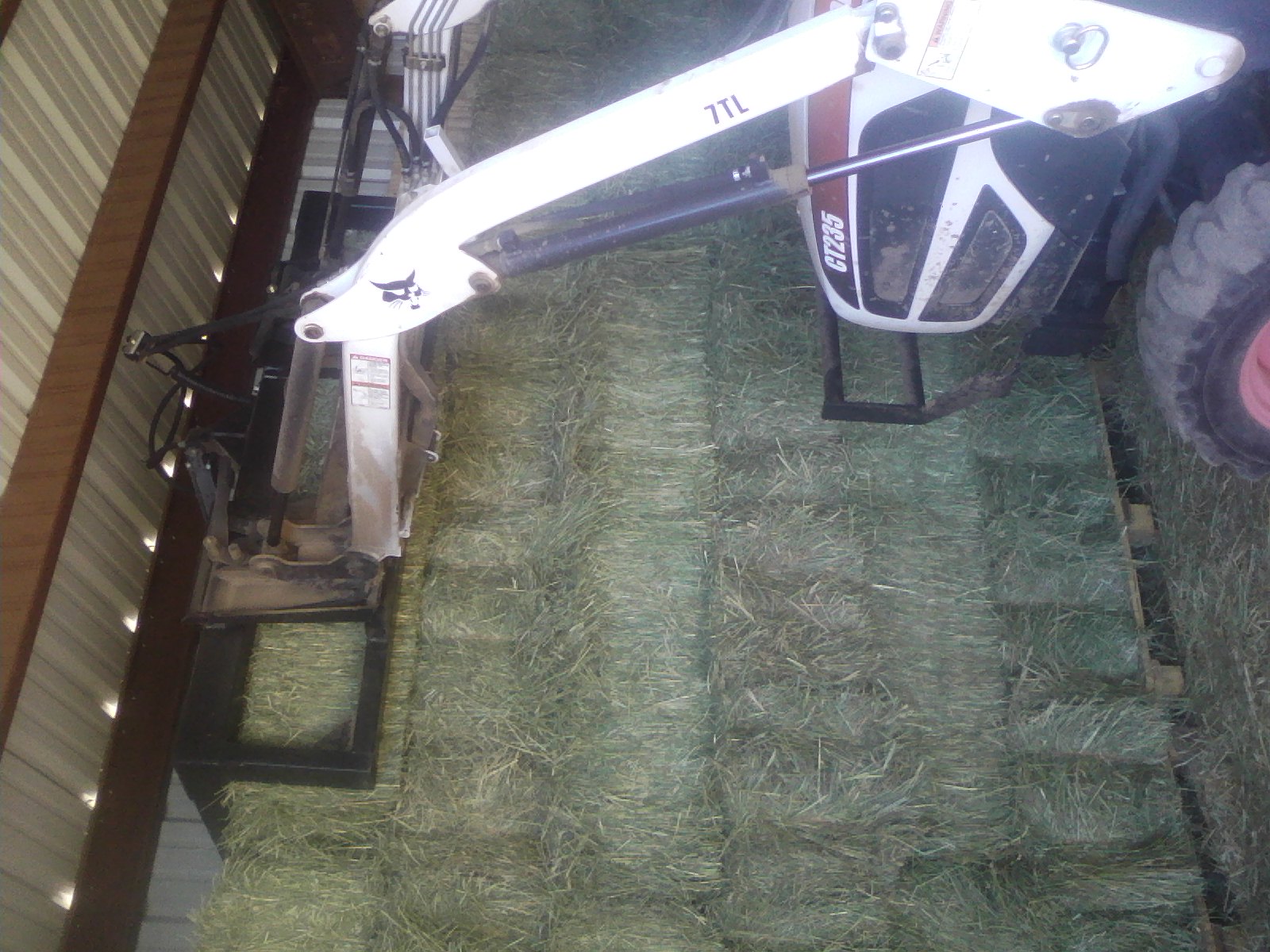

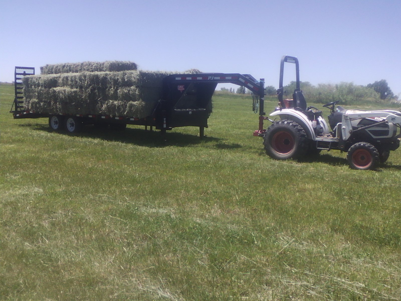

If you do a search on my user name there is a lot of imformation.
I use either a IH 1300 9' sickle mower or PZ170 drum mower. I run a rotary rake and tedder, bale with a Heston 4550 inline - standard 2 string square baler. and to pick up the hay a small quick connect 205 hay grapple Specialty Grabbers | Kuhns Mfg LLC | North Bloomfield, OH
I use it to gather and stack on my Goose neck trailer which I pull with my tractor to the barn, then unload and re-stack with the grapple.
View attachment 565834View attachment 565835View attachment 565836View attachment 565837
Do you use an accumulator to get the bales together first?
