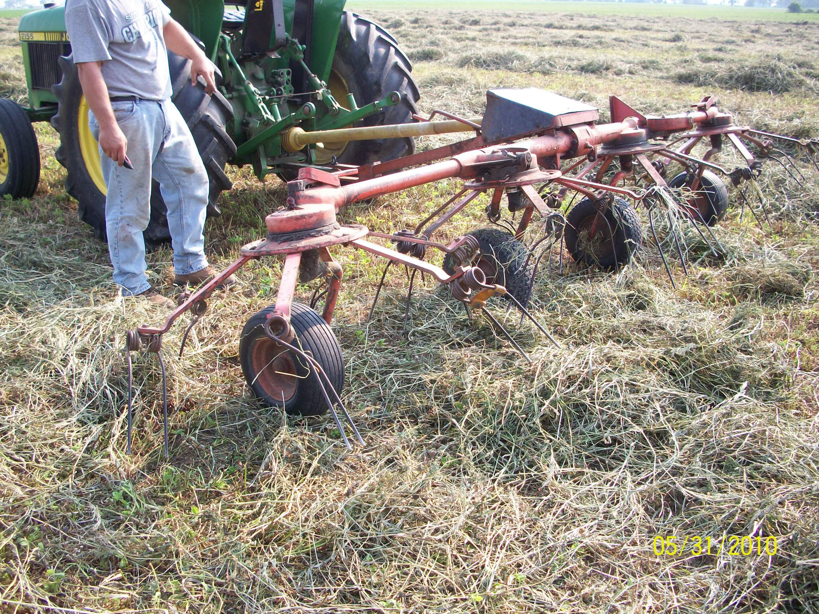

It looks like your tedder may be leaning too far back. Can it be tilted farther forward?
With that style tedder, when the tedder is leaned back, the hay is largely picked up by the teeth at the in the back of the basket. Thus it is thrown together by the rotation of the baskets and bunched into rows (as seen in your video).
If the tedder is tilted forward, it will pick up the hay with the teeth in the front and scatter it (relatively) evenly across the field behind the tedder.
As for the "chatter" in your video. IIRC, ours did that when we had the rpms over 400 or 450 RPMS. Try spinning it by hand and see if the arms/teeth hit each other. If they do, you will need to retime the baskets. To do this pull the bolt that holds the wheels to the shaft below the arms and carefully lower the basket, move it over a tooth and lift it back up, then put the bolt back in.

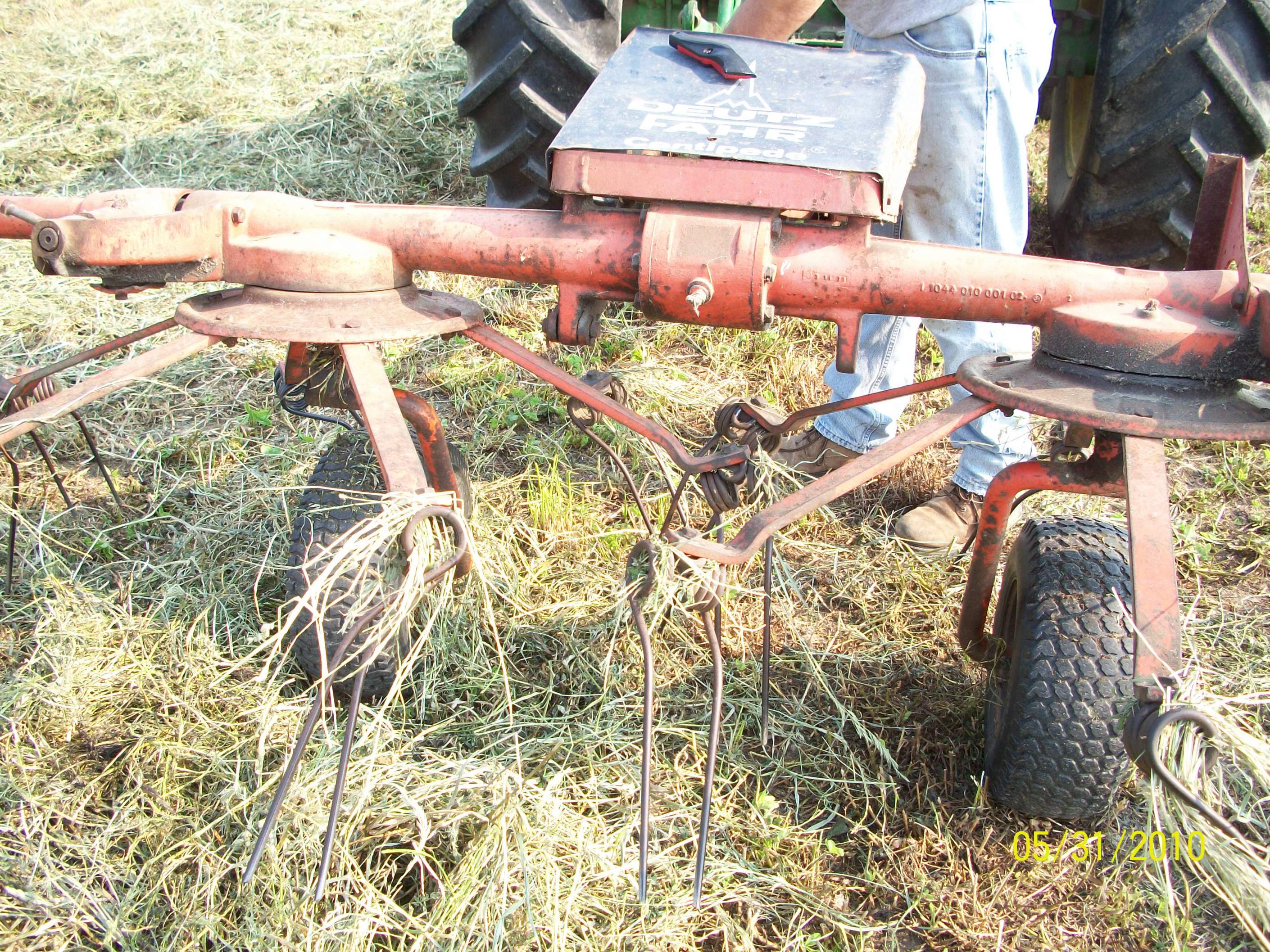

I have not worked on the tedder planning on doing so tonight. If you would Could someone tell me what way the tines are suppose to angle? does it bend too the way it is turning or bend back from the way it is turning? Or take a look at my pics and tell me if that is the way they are suppose too be on. please.
My first plan of attack is too adjust those teeth so they are perpendicular. After looking at the tedder and sppinning it by hand the teeth doo look alll laid back. and when spinning by hand they seem too be timed right they dont hit. so if you could take a look at your tedders and see if the bend of the tines are forward or backward that would give me a start. thanks

With the tedder angled for operation, when the teeth are at the point closest to the ground, the part of the tooth closest to the ground should be almost vertical. Yours look like they are never near vertical. On a Kuhn like we have, there is no adjustment, if the teeth get bent like that we have to replace them.
When they are mounted correctly they will sweep the hay in front lift it, and it will slide off the back. Yours look like it they would never lift it and maybe even press some of the hay into the ground.
Here is a picture, look at the front tooth on the basket to the right.

JasG thanks thats what I was looking for. as Far as adjusting the teeth, I will half too take a better look but it looked like the holdown bolt and hardware would let you slide the tines up a bit. Ill have too check that out a little closer you may be right and I might have to replace all the teeth.:thumbsup:
   / Hay Guru's I need some advice!! #25
If you loosen the large bolt that holds the tine on, you can rotate it so that the tine will be closer to vertical. I would hit the bolts with some WD40 or PB Blaster the day before, then take them off with an impact trench.

well I mad all tines vertical and cut a few tines down so they would all be aprox same length. the only thing I could try it on is some raked hay and I am not sure that was a fair test. My rake is a side delivery rake and ropes the hay so when you go over it it somewhat clumps. although trying it 2-3 times it seems too be better.

yep I sure did. second cutting was thin but since I made those adjustments and made sure my pto speed was up it spread out the very nice! Although for some reason I am still concerned with getting the hay dry, meaning I think My tester is throwing me off! read my other post and tell me what you think!:thumbsup:
