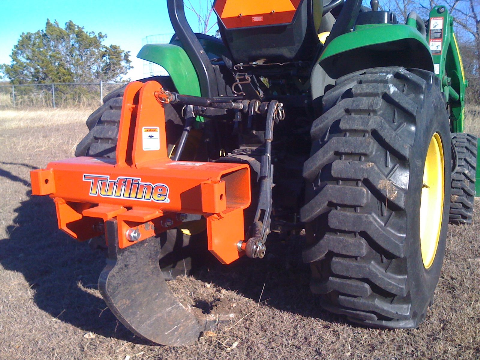

Here are a couple pics of the new Tufline 1S-24 Subsoiler. It is a monster!
Much obliged,
Spindifferent

The subsoiler is working out very well with the JD 3520. The parabolic shape of the shank is actually more efficient than the typical straight-shank subsoiler.
I've used both types of subsoilers, and the Tufline is much easier to pull.
I've had the shank down to the 24" limit with no problems pulling it in 4WD. My soil is a clay to clay loam with few rocks or roots. The soil still has some moisture in it, so that probably helps.
A couple other features that I really like about the subsoiler is that is has a grade 5 shear bolt, a parking stand, and weighs 229 pounds.
Overall, very happy with it.

We have sold the Tufline subsoilers for over 20 years and there is no better subsoiler on the martket. I own a 1S-28 and when I subsoil in the summer and the soil is a little dry, you can actually see the earth move on the suface a foot or 2 away from the paraboilic shank. Ken Sweet
