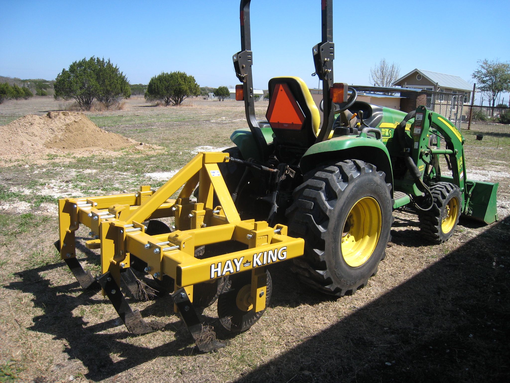

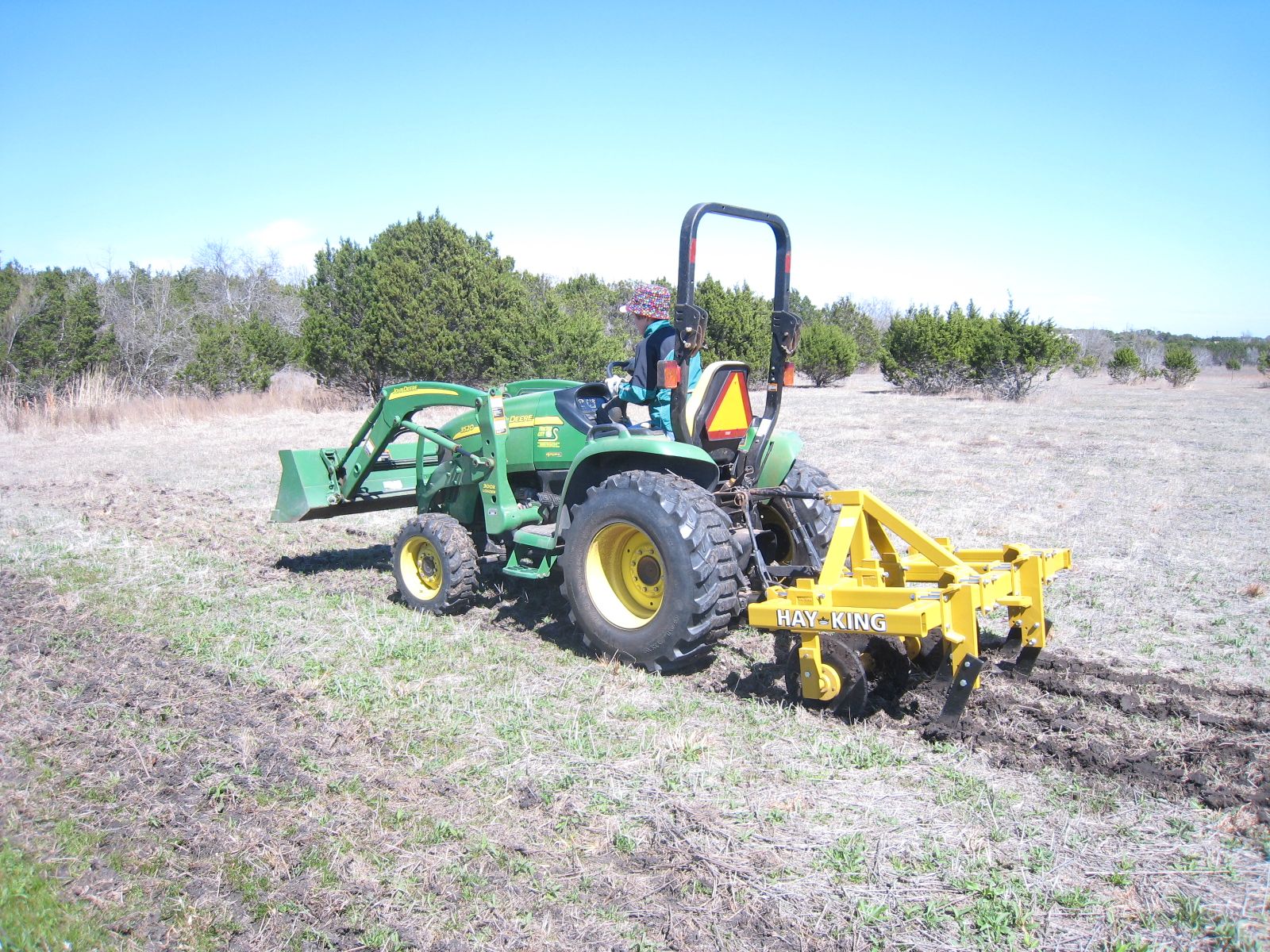

Here are some pics of the new renovator. This is the C-4 model with 4 coulters and shanks. The C-4 weighs around 750lbs and is rock-solid.
Without any adjustments, I'm getting 4 inches deep and am able to pull it fine with the JD 3520 in 4WD. I think the limiting factor will be traction. I have an area near the septic sprinklers that is wet, and the tires lost traction with the shanks 4 inches deep in this area.
Will spend some time adjusting the coulters to see if I can get the shanks deeper in the soil that is not as wet.
One picture shows my wife driving the tractor. It was her first day in the driver's seat, and she enjoyed it as much as I do! :)

Very nice. The photo of you pulling the renovator is a bit misleading. Your rear is tilted high so the shanks aren't very deep. I pull my 4 shank with the back section (shanks) lower than the front to bust up the soil compaction and create a deep slot for nutrients and water.
I'm sure you were accomplishing what you desired. However, If someone used this as a guide to determine the HP required to pull it, that would be a mistake. I have a 70+ HP 4wd tractor and I can bog it down with the rear shanks down low. If possible, run the renovator after a rain, the damp soil makes it much easier to pull.
Its all about what you want to accomplish. For me, I wanted to bust up compaction to promote deeper root growth and wanted the fertilizer and water down to and below the root zone.
