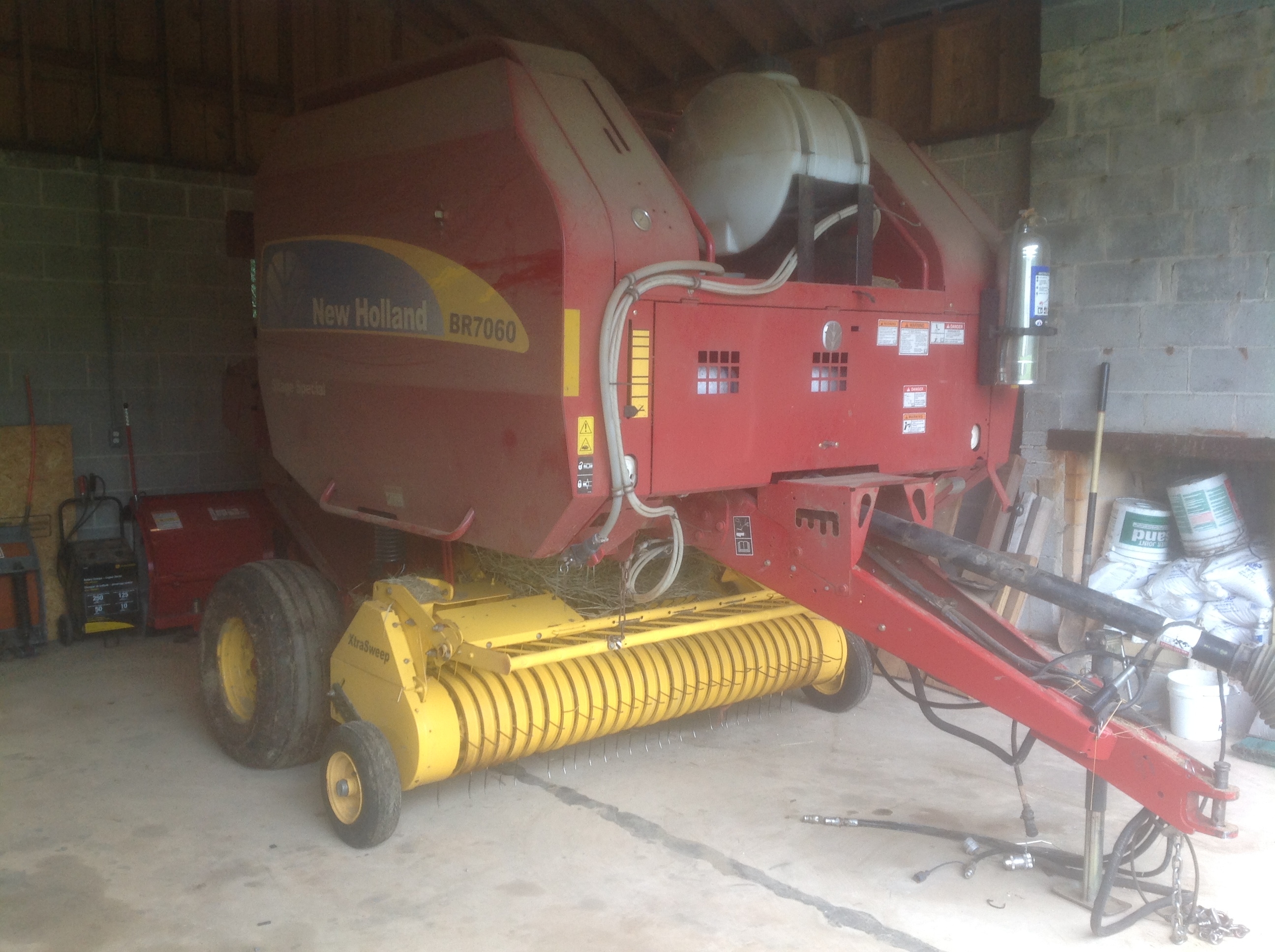

Hay preservative is a product that is applied via a tank mounted at the top of your baler with spray nozzles down at your baler in feed. It sprays the hay with propionic acid as the hay is being fed into the baler. You can switch the applicator off and on in the cab, or get a system that has “eyes” mounted on the baler that turn it on automatically as you enter the windrow.
I ran a system on my round baler for years, but most of my customers didn’t like the smell of it or thought it was bad for their horses. Now there’s some acid that is apple scented to make it more palatable.
Here’s my BR-7060 with an applicator from 10+ years ago. The white applicator tank is mounted atop the baler. You buy a tote of the preservative and pump it upwards into the applicator via the hoses you see mounted on the front of the baler.
IMO, it was a big PITA, but I understand why some use it because of the climates they live in.
After years of making hay that met all my customers content, moisture, softness, green-ness, weight, protein, etc. expectations, along with the expenses of fertilizer, herbicide, preservative expectations, I dumped all of it and went to making basic, “organic” hay.
There’s a great market for organic hay. Lower input costs for sure and lower bale prices, too. People are on an organic kick right now and it’s pretty popular with beef ranchers. I sell a lot of organic hay to them so they can make the “organic beef” claim to their buyers.
All the headaches and expenses of all the liquids, chemicals (that could be dangerous) and costs are gone.

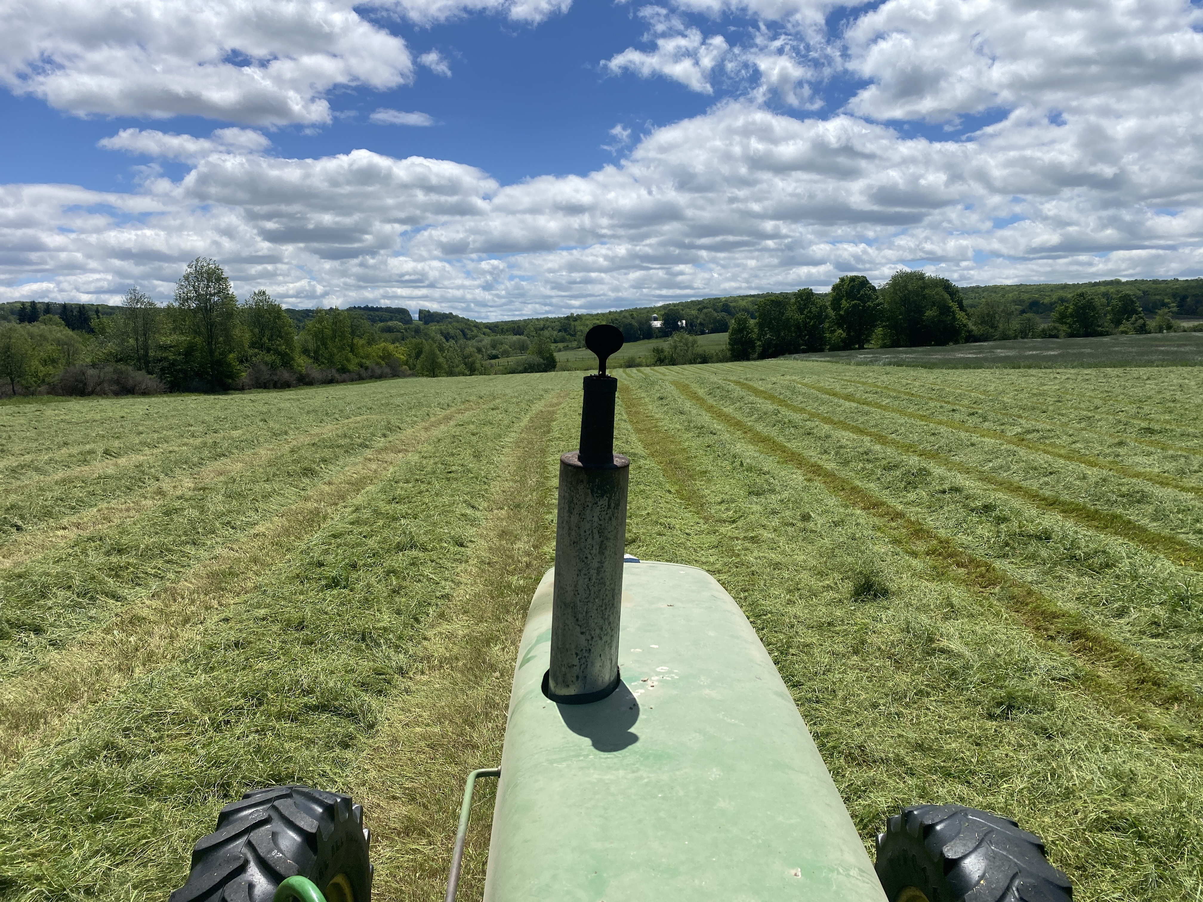

Yes, re-rake or tedder if really soggy. Wait for sun to get on them to aid drying. Climate is way different where you are, so YRMV.

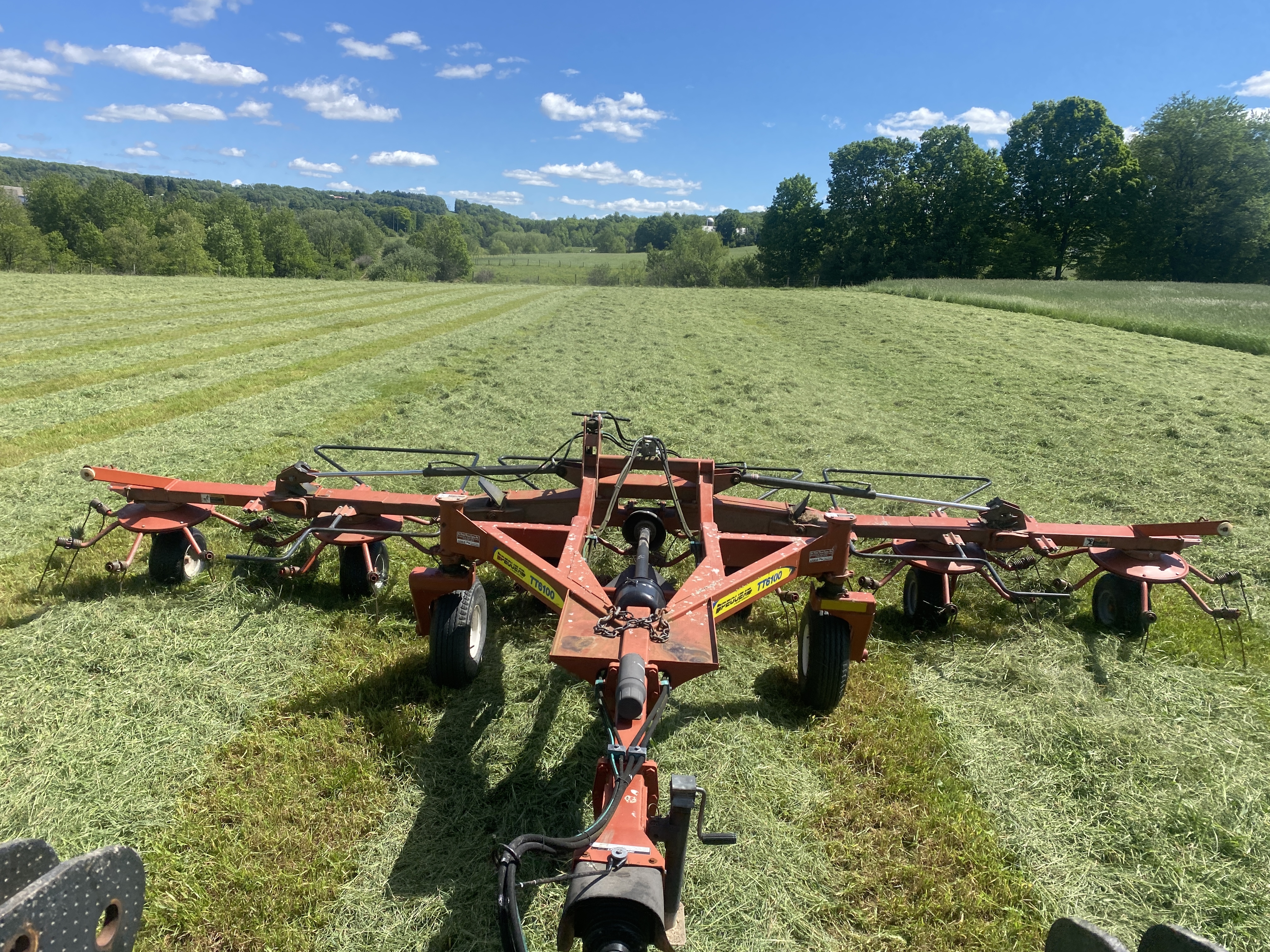

or run a tedder back over it and then windrow again although I hate to do that. Opinions?
Tedder might be overkill unless your dew is real heavy or of course it rained. Tedders shatter leaves and cause loss in hay quality, so tedder gently as possible while still maintaining effectiveness.
As far as leaving hay in a windrow overnight, I rarely did it, but that doesn’t mean it will ruin your hay. It would gain dampness from dew overnight in MY area and would have to be raked or worse, teddered if it got real soggy.
If it’s a dry spell and you get a little overnight dew, you can make really nice hay by rolling the dew right into the bale. I did this a few times.
For whatever reason, I always bale what I raked that day.
I made thousands of tons of feed hay and still make a few hundred tons per year now, but LHF2019 will be able to give you a wealth of information as he has the ability to make hay in a fairly damp area.
