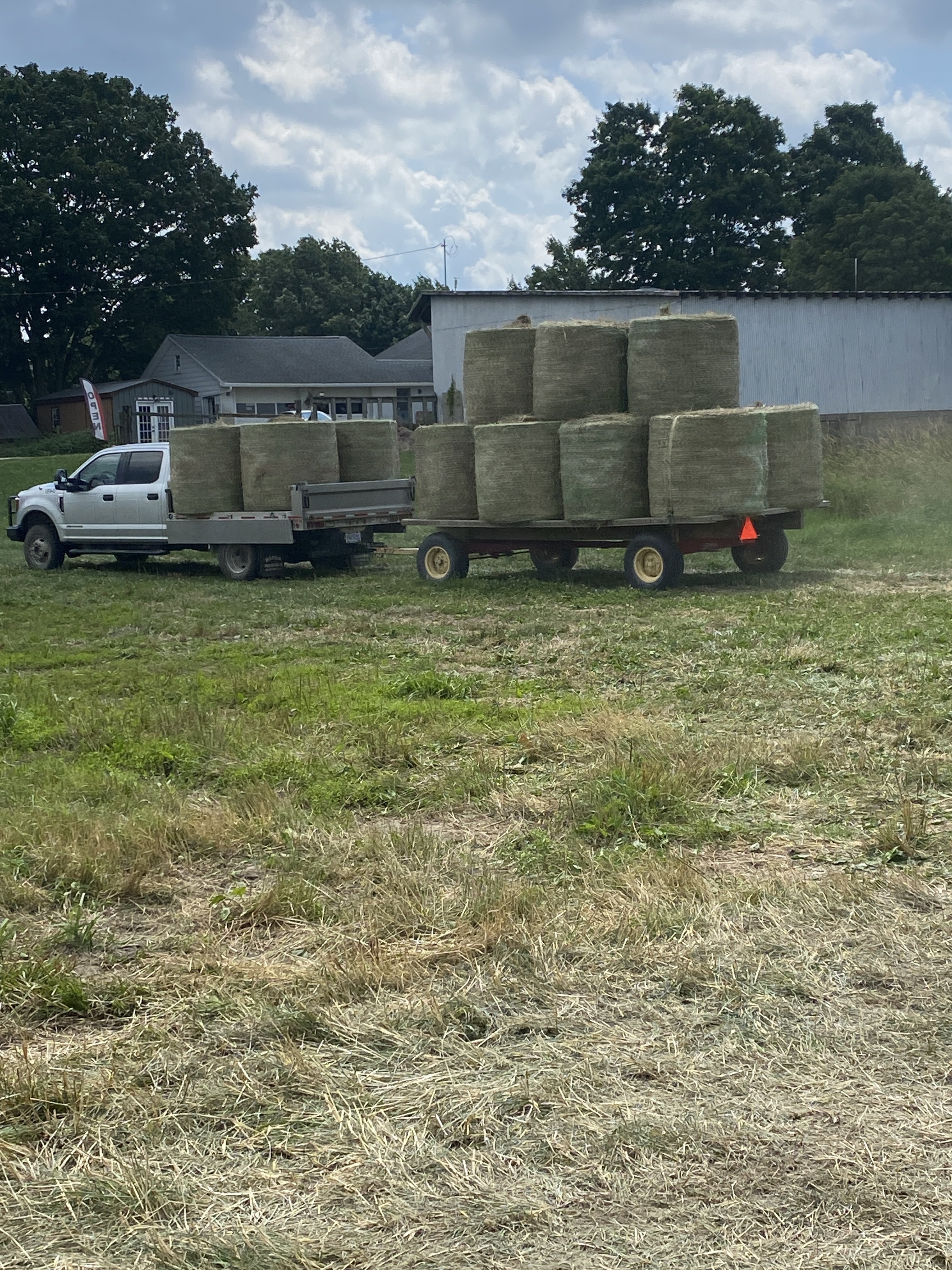

Interesting you load 'eye to the sky' not something I do, I always load 'eye to the side' on my customer's flat bed trailers. If I store them in the barn however, it's always 'eye to the sky' simply because I can stack them better and they keep their round shape and don't get oval from rounds on top of them.
I presume you are rolling 5 x 5's and not 4 x 5's. Only reason why I can see loading like that or you have a bale grapper...

4x4's and their method of hauling. This customer is one of our best ones. Almost 300 rounds. Yes have a grapple but to slow. Bale spear.
